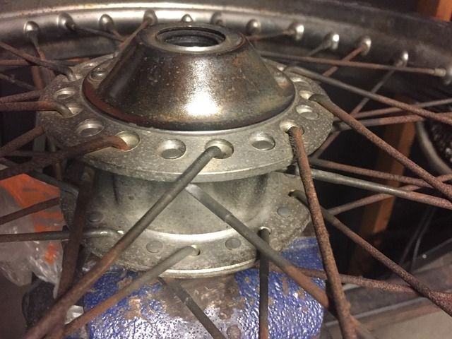

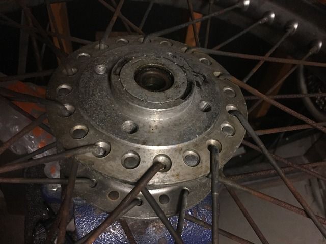

I bought two Kz front wheels on eBay (fairly cheap) and the seller didn't know exactly what model they were from. I only really need the hubs anyways, but I want to find a matching speedometer drive.
I didn't take pictures of the hubs but they utilize a 4 bolt pattern, single rotor (a chrome cover plate covers one side), and use a 17mm axle. Both hubs are the same.

The KZ400 had a 18" front wheel. Those are the same spoke wheels that come on the kz1000, 650 and 750, i think a speedo from any of those would fit, but whats interesting is there appears to be a block off plate for the speedo there.
I agree. My '78 1000 originally had spoked wheels but that was long ago and I sold them so not able to compare. But the washer on the speedo side is throwing me off. I can't find it in any of the 77-79 models parts fiches that I check on Partzilla.
