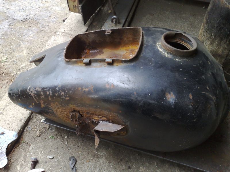

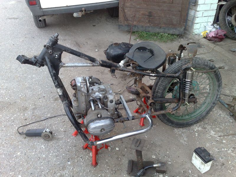

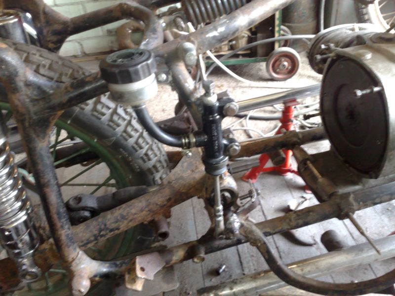

Hello everyone. I would like to tell my story of big ass project. When I was still at uni I noticed I have enough knowledge to build something interesting in my nifty garage. Then I found few parts of one of Soviet Russia military Ural 2 wheel drive motorcycle and the journey began! First thing I did i changed front part of the frame because I knew (experience) that old thrust ball bearings wont last long with a sidecar. Thrust spherical are way better! Few more welds and bits like disc brake cylinders, late 50s saddle, cylinder heads protection were fitted as well. Original bike was produced in 70s and way different than todays models.

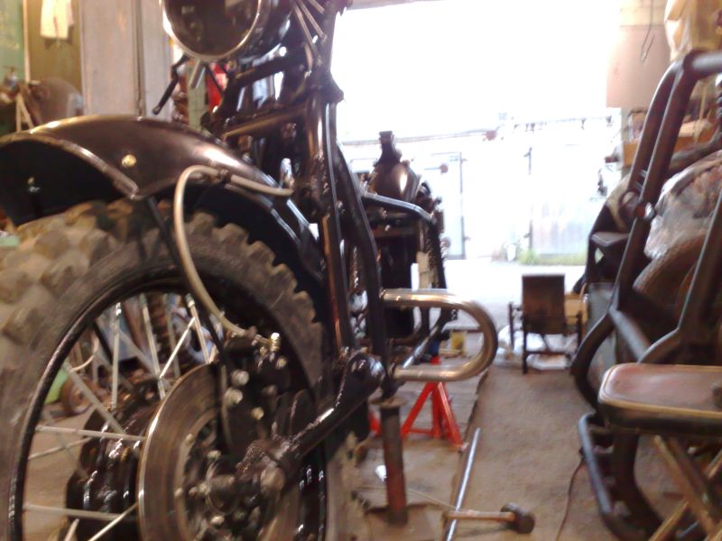

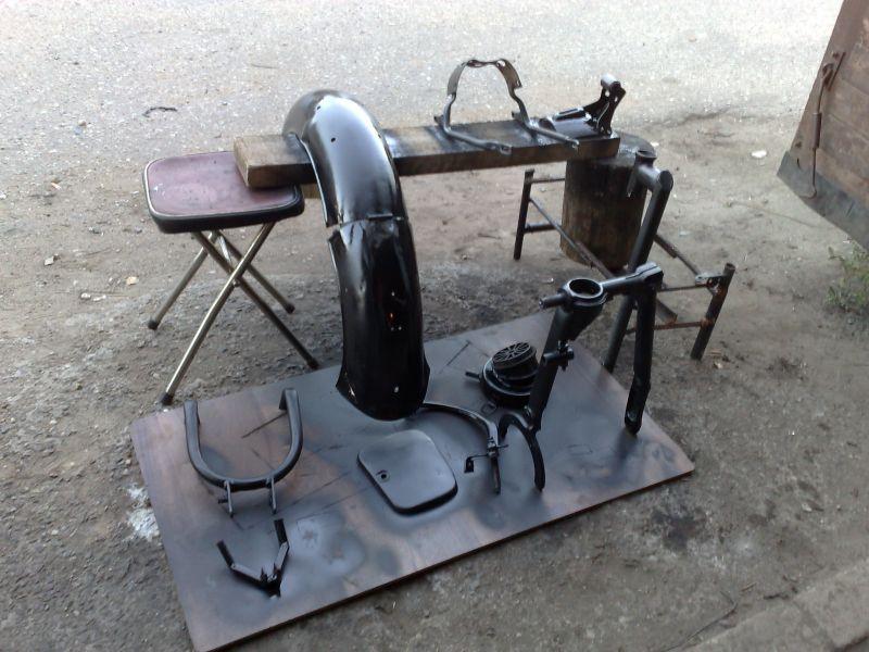

This thing will be powered up by tuned engine. For better handling I made leading link forks. Yes it looks nasty at first but it will get better!

Yes that was first attempts to make a leading links. Fitted disc brakes.

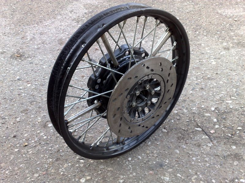

If you noticed I left old brake system as well. Brake shoes works as well on a front and back just in case you need to change whole wheel with brake disc spacers with another older rim. All you need to do just connect cable and block brake pads from moving.

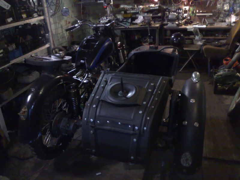

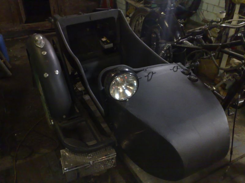

Got a right sidecar from DNEPR MT12 and converted into old school KMZ M72 or early K750 style with foreigners voltmeter and motohours clocks.
