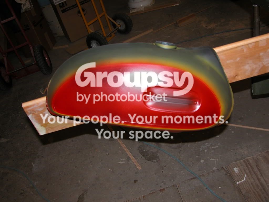

I then began the experiment. Water Based auto paint from Auto-Air company which is the stuff custom painters use for airbrushing. Neat stuff as it goes on really thin, you can dry it with a hair dryer and re-coat in about 10 minutes. I used a cheap airbrush kit from Harbor freight to try this stuff out.
First a line of yellow followed by tape to emulate the original yellow stripe from Yamaha. Then a coat of the red background:
It is hard to see, but I used a semi-opaque mix of black to darken the edges of the red so that the final look would be sort of a vignette effect so it would tend to age the finish:

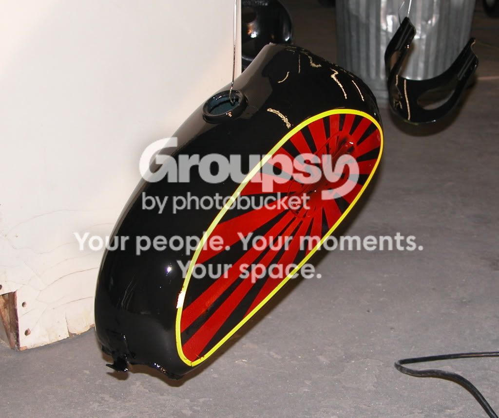

Then the real taping ordeal begins:
After you get that laid out (The taped sections will end up being red) you spray the whole tank black - also using the water based color coat. After half an hour you can remove the tape to reveal the slightly dull color scheme:
Pre-clear coat:
The next day a coat of PPG Omni Catalyzed Clear which almost looks like it is wet when it drys. I used three coats and the finished product is amazing.

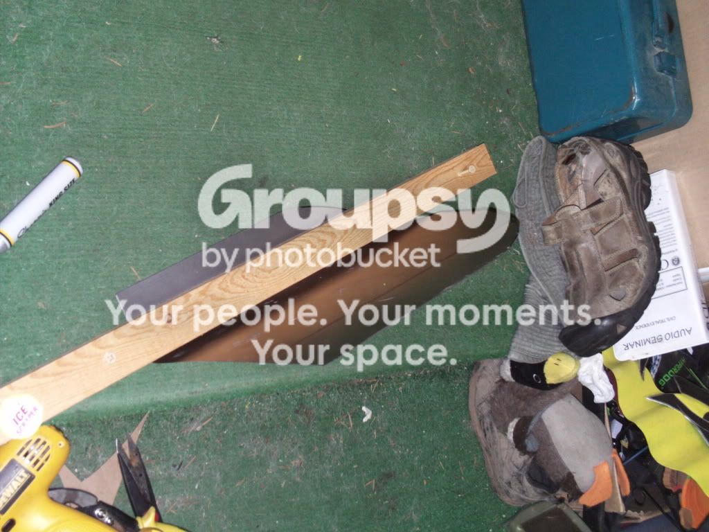

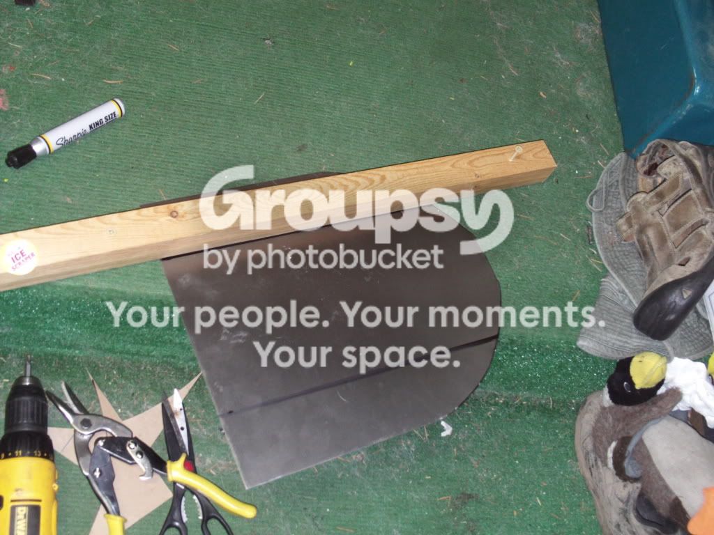

The front fender is a vintage plastic high mount fender painted dark grey, but I wanted something different for the rear. I made up a pattern and transferred it to a sheet of 10 gauge stainless and cut it out.
Now the big question - how to make a nice bend in this stuff? It is really stiff. The answer is the Original Redneck Metal Brake. Simply screw a hefty bit of wood on top of the metal and into your wooden porch . . .
Carefully lift the longer side . . .
and then repeat for the other side . . .

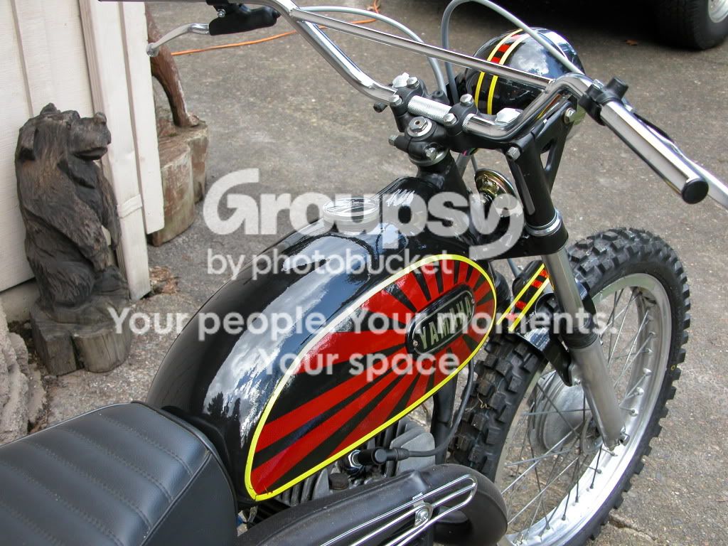

Some almost done glamour shots:
it also may be getting some more tracker styled bars and a small rack on the back. All mechanicals have been checked or replaced. New brake pads, tires/tubes, bulbs, wiring, new horn, fork seals and wipers, all cables, tank badges, added a voltage regulator and it will have some blinkers for street use. I also have a stealth trailtech vapor which I anticipate will go on the bike next.
