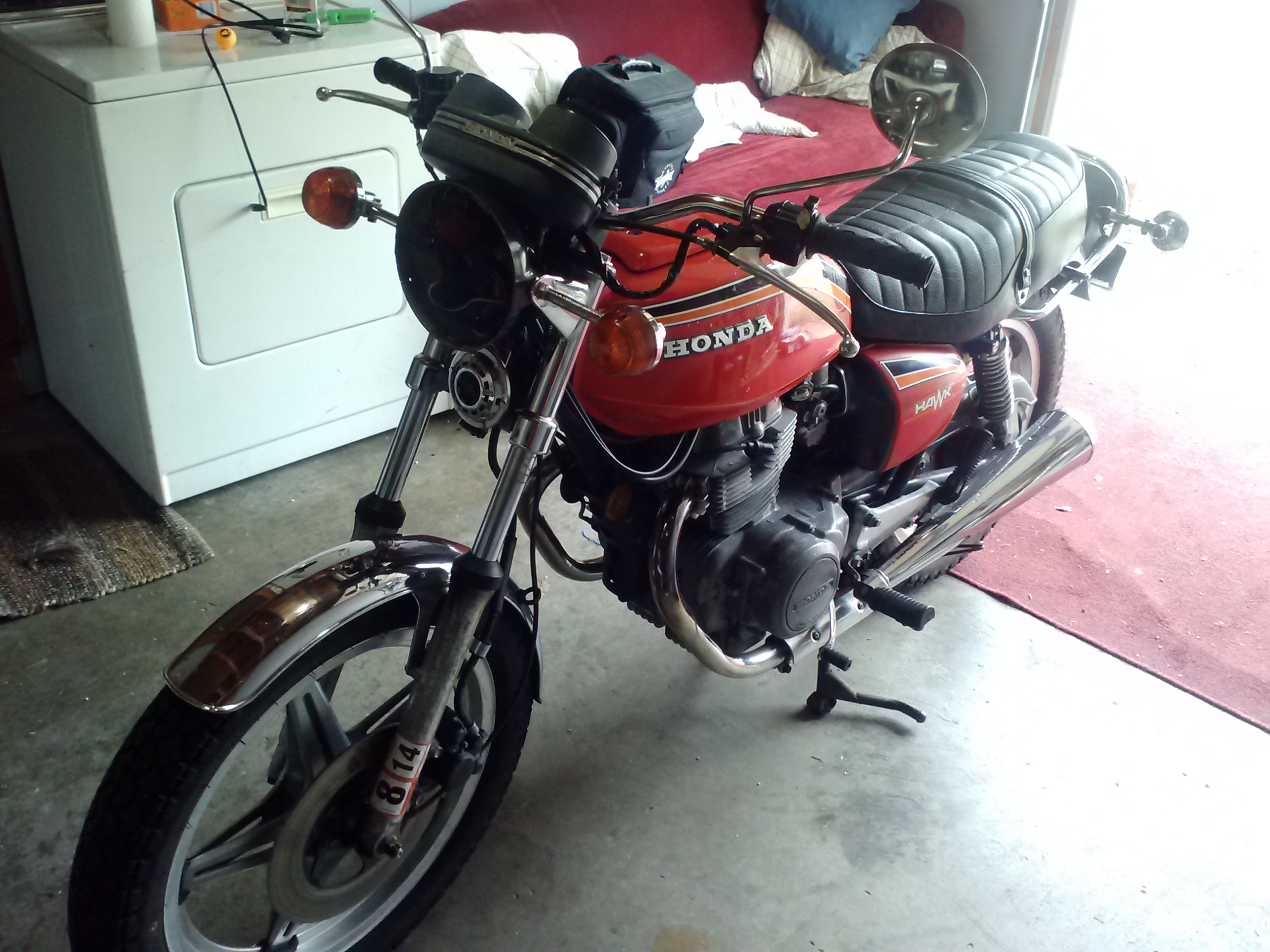

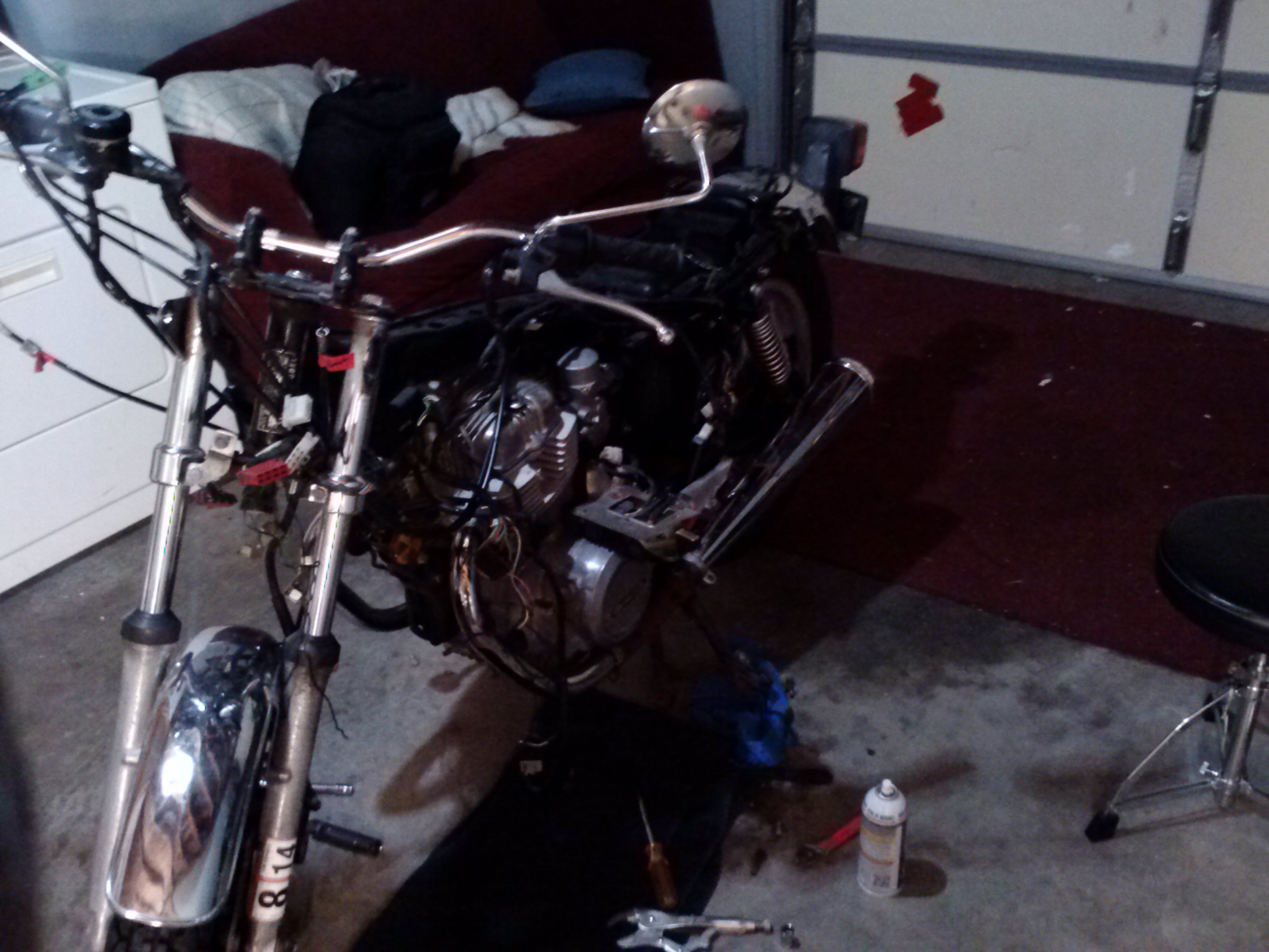

Here are some pictures of the bike and where it's at now.
