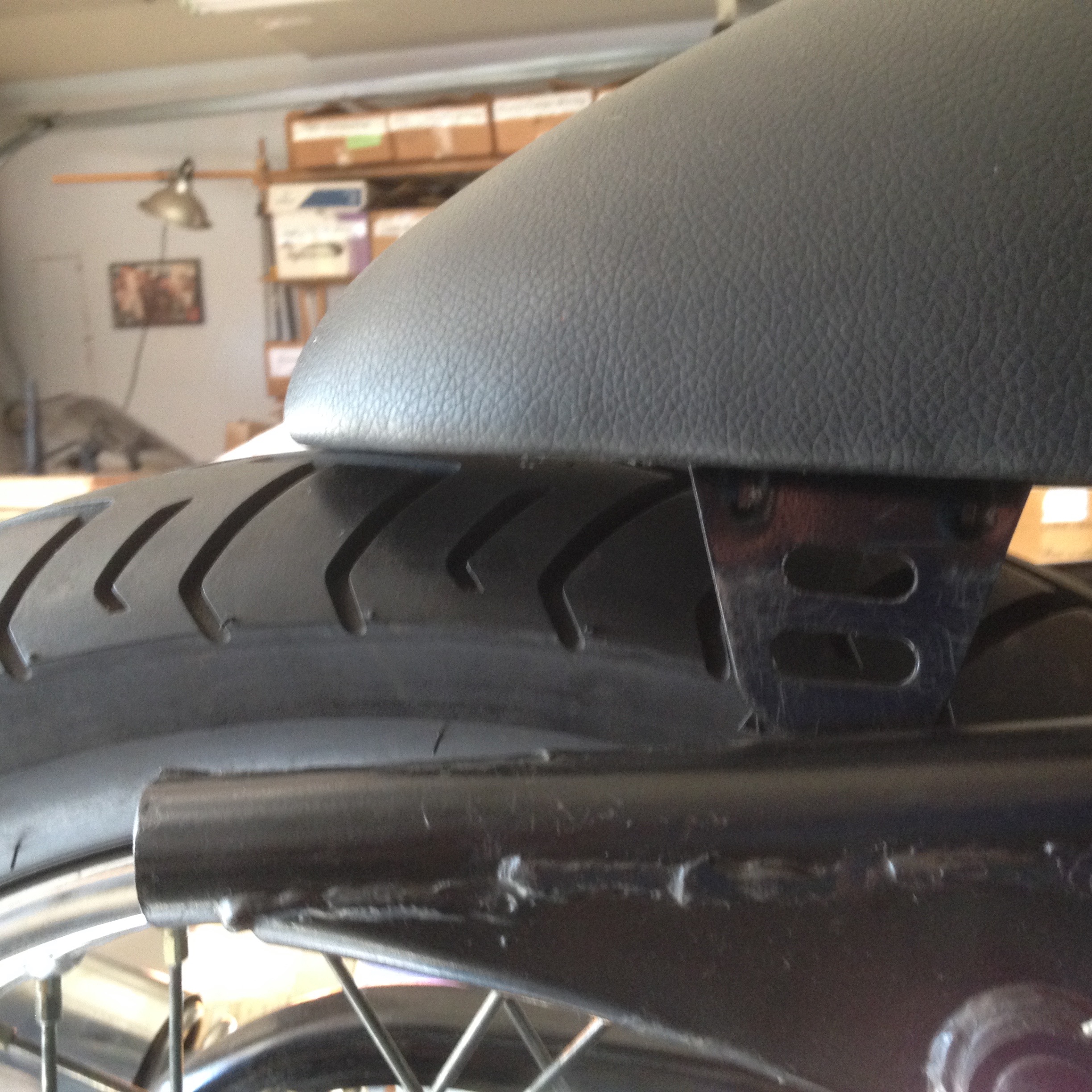

I am currently finishing up a kz400 cafe project and have come to the sad realization that the little Chinese cafe seat I got may not work. The PO had hacked the rear frame, making this a cafe, not a resto, project. The original seat pan bottom molding had a curvature that allowed for the up and down movement of the rear wheel. This new cafe seat is flat, so I now lose about 3" of needed space.
I've poured through the DTT archives for possible solution but without much success.
The only obvious options appear to be to raise the seat 3" or more but that would leave a pretty non-elegant gap between seat and frame rail or weld a rear hoop and try and find a longer seat that could be in some way manipulated in the middle...
Longer shocks might gain me some needed MMs but not enough to fix the problem.
I know this is a common issue on cafe builds.
The first pic is the seat/tire at rest
The 2nd is 3" compressed w/out seat and the the 3rd is 3" compressed w/ seat.
Any suggestions would be greatly appreciated.

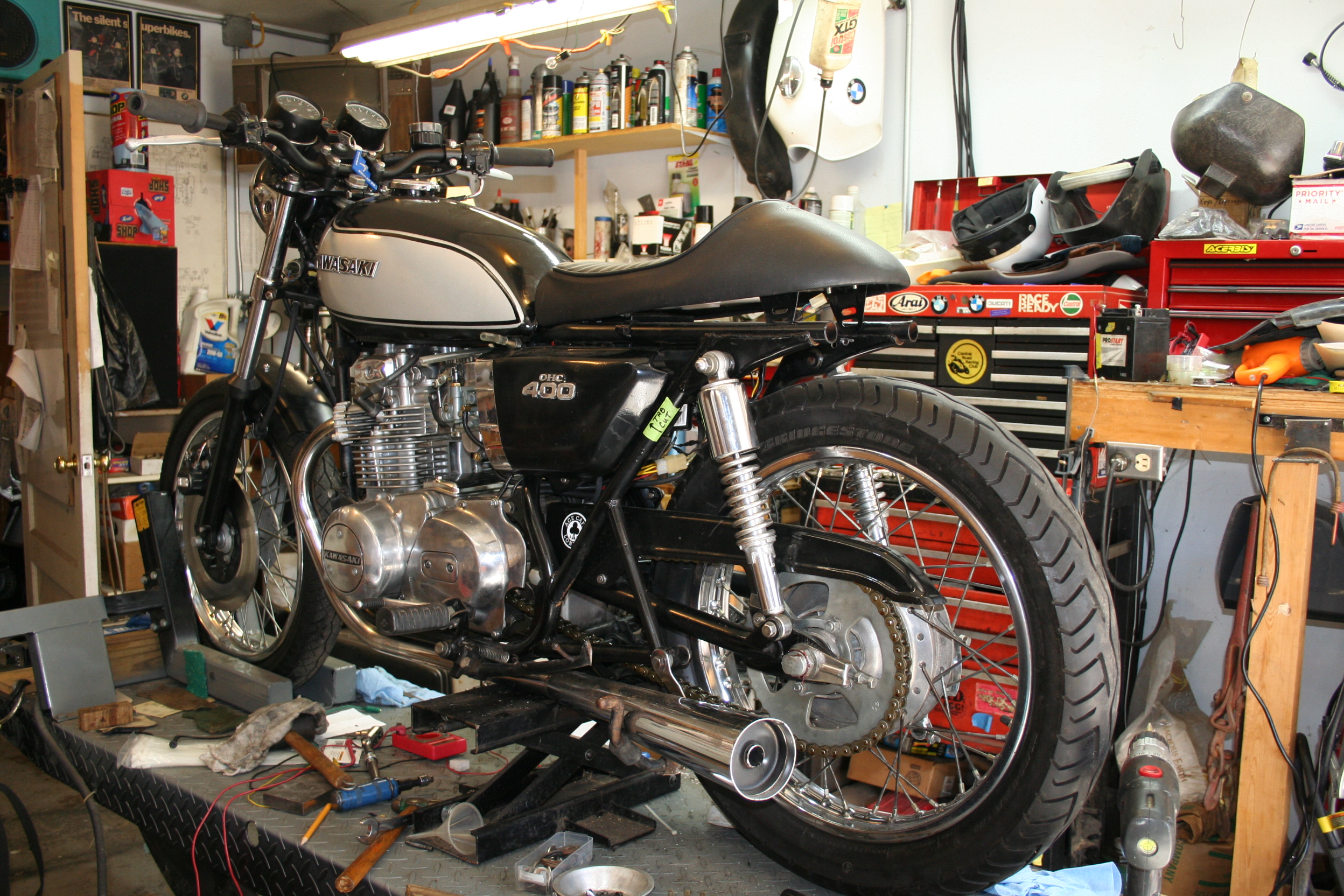

show us more than just the top of the tire and the seat.....back up a bit and give us a full view
I had the same issue. I cut a hole in the seat pan and am hiding the bubble under seat foam. That was my quick solution. But I only needed an extra inch and a half. I was advised not to mess with the suspension unless I wanted an inferior finished product. There are a lot of smart guys on here when it comes to builds. They all said don't mess with the shocks. I'd heed that advice.

Yep. Either cut a notch in the seat for more clearance and have it recovered or find a new seat
Thanks for the responses. Think we got the issue sussed. While not the most elegant solution, we were able to gain the needed inches without viagra. The gap between frame rail and tire exists but isn't a deal breaker.
