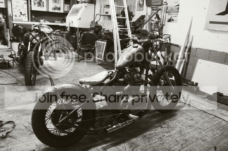

Since I had two 750's on had to go because I really wanted an XS650. so sold the green one and bought this
good base but has some work to it:
- fit a proper taillight
- rewire some parts and hide it
- fake oiltank needs bungs re-welded
- new clutchcable
- has no top motormounts, so making some
- ride it and enjoy :)
put the old girl on the lift today.
fixed some broken tabs:
the one that was holding the left footpeg broke of, it was just held on by one bolt and could be moved up and down
welded the oil tank back to the studs in stead of the zip ties that were holding it up. made it rubbermounted as well so shouldn't break again now...
and mounted straight springs, like them better then the hairpin springs
footpeg back in place and new heatwrap around the headers
