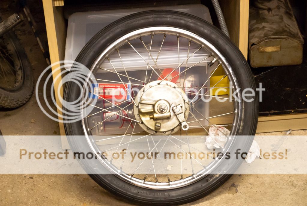

Heres the wheel after being cleaned up a TON. Most of the work is invisible; the entire inside is rebuilt as well and looks super clean and pink (synthetic grease, woohoo!)

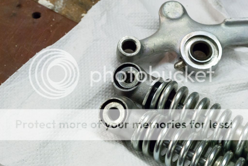

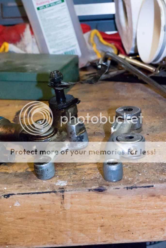

Unfortunately, found this...
Collapsed bushings. Will need to order some, but for now I cleaned everything, greased, and loosely assembled back on the bike in order to keep it together (and to discourage me from a complete tear down).

The wheel in question:
It just wont do... way too dirty! Lets take it apart and clean it up...
Now lets add some grease and new drive rubbers (old ones were in decent shape although a little soft and worn, but while i was in there I just did it since I had already ordered them).
All that I need are some new chain tensioners and the chain+sprocket should be replaced eventually as the sprocket was showing signs of wear (saw toothing).
