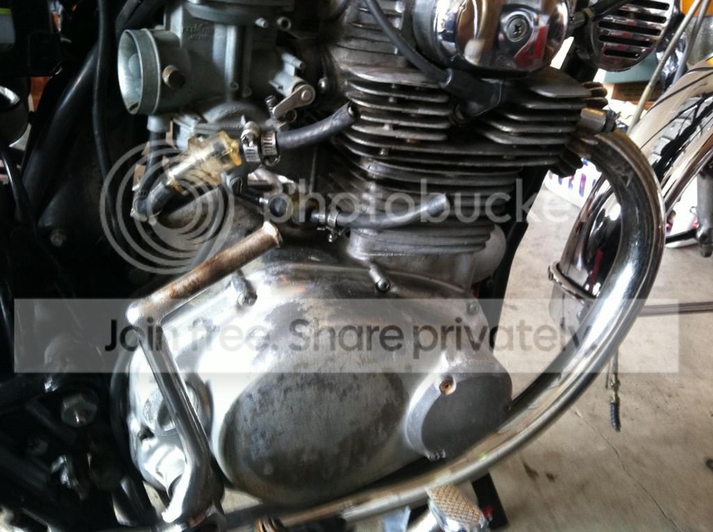

Custom fuel lines that would leak, causing steam while sitting in stop and go traffic making me wonder what to do if the bike caught on fire.
Another shot, the carbs were SO far out of sync too. I haven't done it proper yet, just by eye/feel, but when twisting the throttle the left cylinder got quite the headstart on opening.

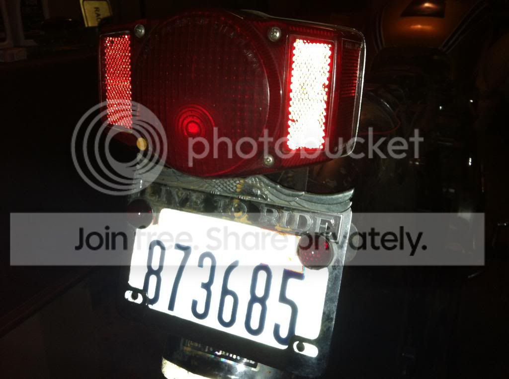

Biggest taillight ever made. Went well with the sissy bar, but both need to go.

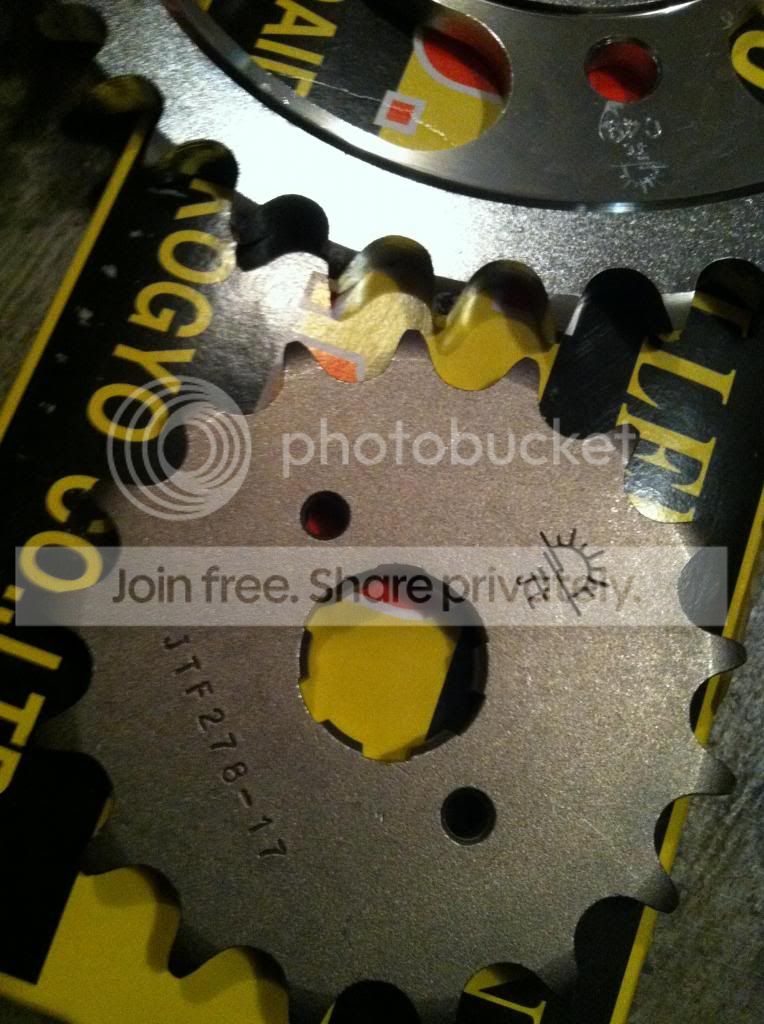

17 Tooth JT sprockets front with 36 Tooth JT sprockets rear to bring down the revs.

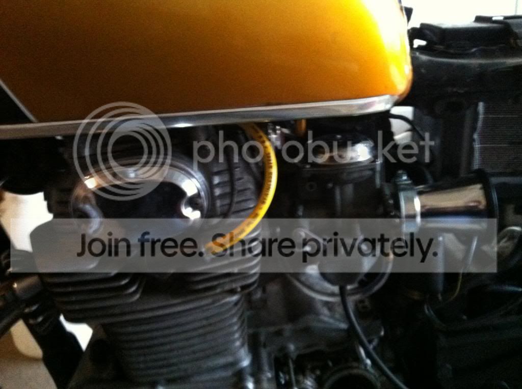

Also picked up some clear fuel line to redo the carbs without those ugly clams.
For the plug wires I got an Accel universal wire kit I'll be splicing in the proper way.
That was all from bike bandit, best prices around for all of the above. The last thing I did get after shopping around some were a set of velocity stacks from DCC. They were only $23 after shipping so we'll see how the quality is.

I was slightly on the fence about the stacks, but after installing them and starting it up I'm glad I did.

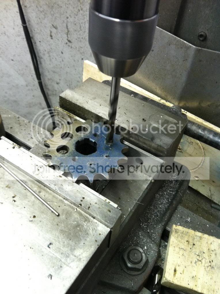

The quality of the JT sprockets is good, but the front sprocket is getting some machining before it goes on.

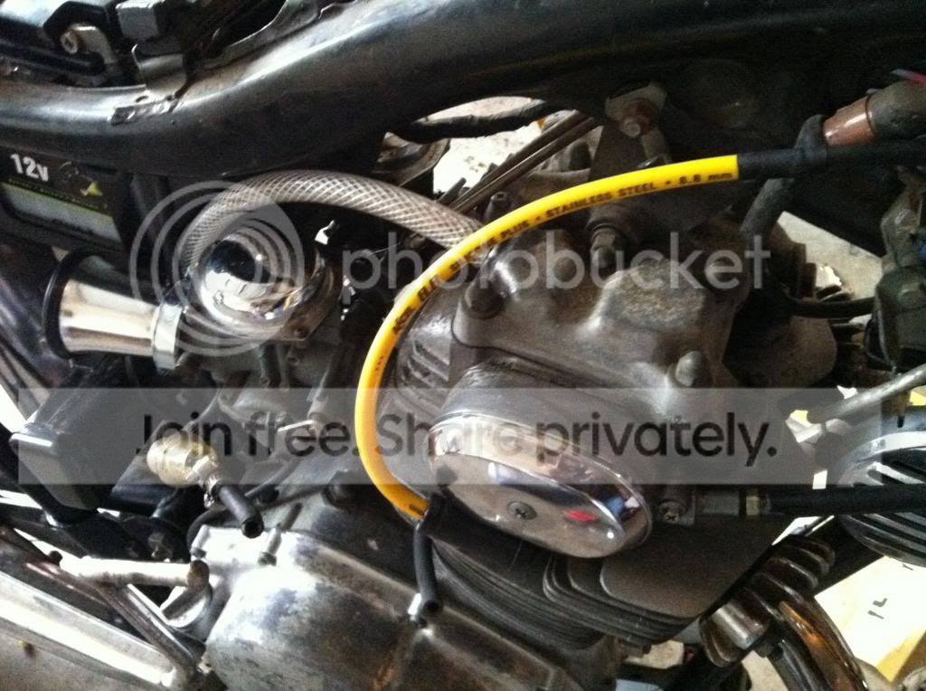

The plug wires went on with little effort. The origional setup was very mismatched, glad I got these. Plus I've always run yellow Accel wires since my first car so its nostalgic for me I guess haha.

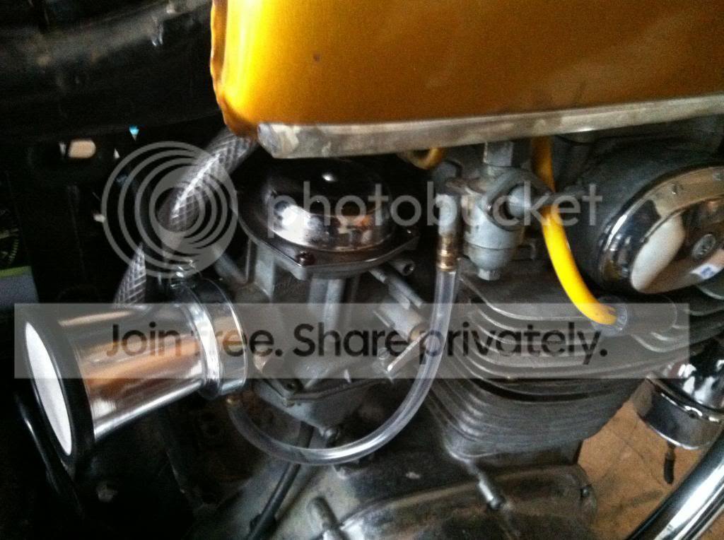

Also got 3/16th I.D. fuel hose that fits correct without those clamps

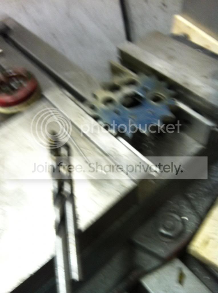

Crappy pictures of drilling the front sprocket. Saved alot of weight, very happy with the result, just need to paint the exposed metal so it doesn't rust.
Lucky we had some carbide bits, the metal was super hard and had to step up one bit size at a time, then finished it with a slight chamfer.

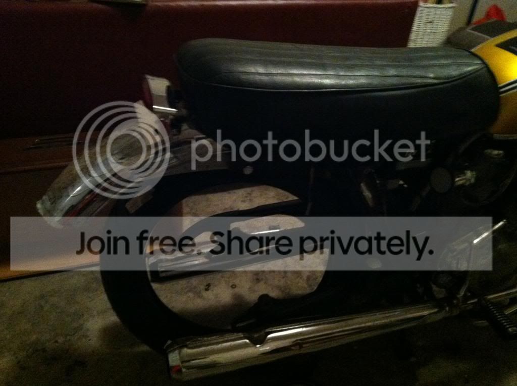

Before the tires were mounted, looking at the new taillight and huge fender.
Lucky I don't look too weird without rearsets yet since I'm 5'5" and about 130lbs.
