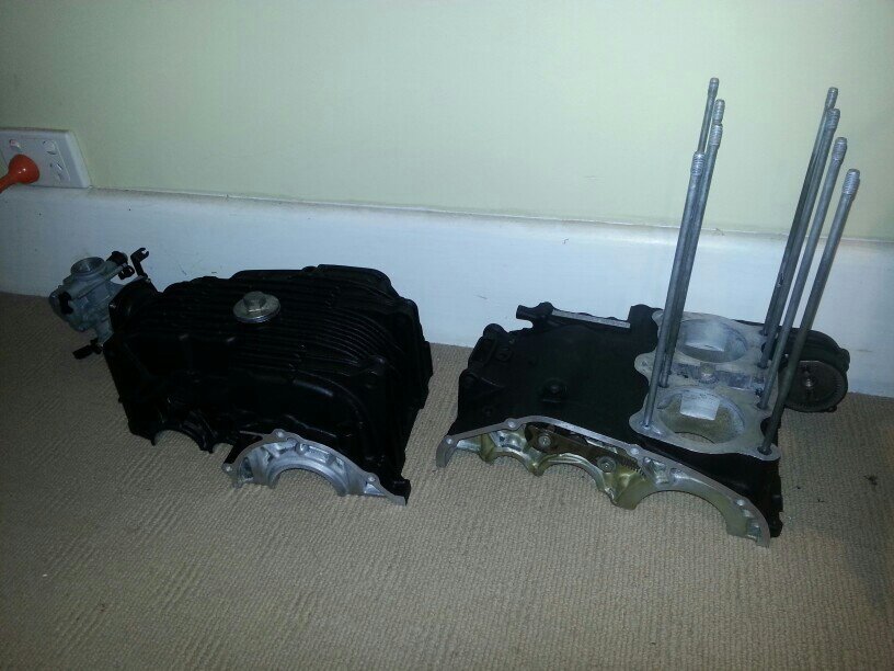

hi guys, my name is Russell and ive been looking around this site for some time now getting some useful info, so i thought it was time to post up what ive been working on. i picked up a 1972 cb350 a couple of months back with a locked up motor, looking at having a bit of fun with it and turning into a bit of a cafe/brat style bike. the bike was near complete when i got it, though it was missing the left hand side header and exhaust. ive stripped the bike back to the frame and dismantled the engine. unfortunatly the engine had a little more damage than first thought, with 1 piston rusted in the bore and all the cam chain tensioner gear broken and worn out. it also looks like the cam and rockers are a bit worn out, starved of oil at some point maybe. though the bottom end seems to be in good condition. so ive cleaned it all up and put the bottom end back together with a new cam chain, just bought some 66mm wiseco pistons off ebay (hope they work well) and the top end is at the machine shop getting cleaned up and bores oversized when i receive the pistons. just need to find a new cam and rockers now which is a shame. i have the frame getting modified at the moment and also a seat and battery box getting made, so looking forward to getting that all back hopefully before easter so i can get into painting some bits over the bit of time i have off! thanks for your time and ill keep updates as i get things done!

Well I got the whole bottom end back together tonight which was good, only thing now is it in a gear and everything spins when I turn the motor over but I cant select any other gear when I move the gear shifter up and down, you can only move the shifter up and down but not fsr enough to select anything else, any ideas? Was thinking its maybe because there is no oil in the gearbox so maybe the selector fork is binding up a little on the drum, or ive done the clutch springs up too tight, I'm not really too sure. Any ideas?

So I think I known what ive done wrong and why the bike wont shift. I don't think the selector drum was in neutral when we dropped the gearbox back in the case, which is why it wont shift. Not happy at all, got to pull the thing completely apart again now to fix this! Ahhh well you live and you learn hey...

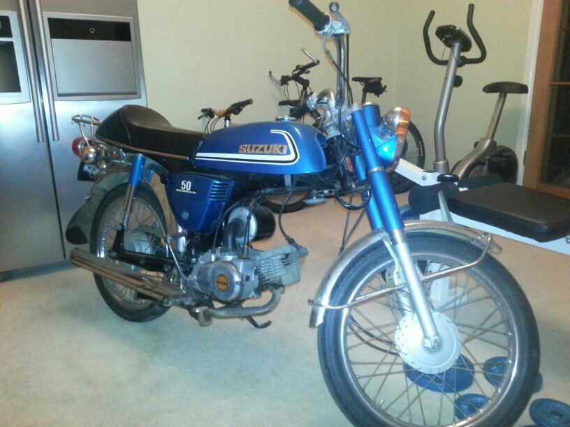

So a bit of a story, my grandpa passed away mid last year and had quite a few 70's 2 stoke jap bikes in his collection, which most of went to my uncle, but ive ended up with a 1975 suzuki k50 in wicked condition that my grandpa owned since 1982. This bike means alot to me, its the bike that I learnt how to ride on, its the bike that started it all! So im going to clean it up, sort the electrics and get it club regoed asap
And this is me and him when I was a kid, who knew what a slippery slope this bike business would be!
