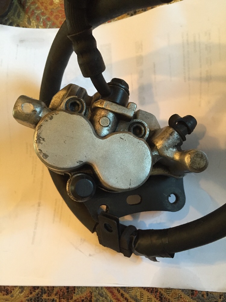

Here is the 750
Here is a kz200
My other option would be to find a brake off of a bike like the ninja 250 and have a bracket made to make it fit. Ive just never done anything like that. I think the rotor width between the two bikes is the same. What else would I need to consider?

Ill have to post pics because this brake seems pretty unusual.
