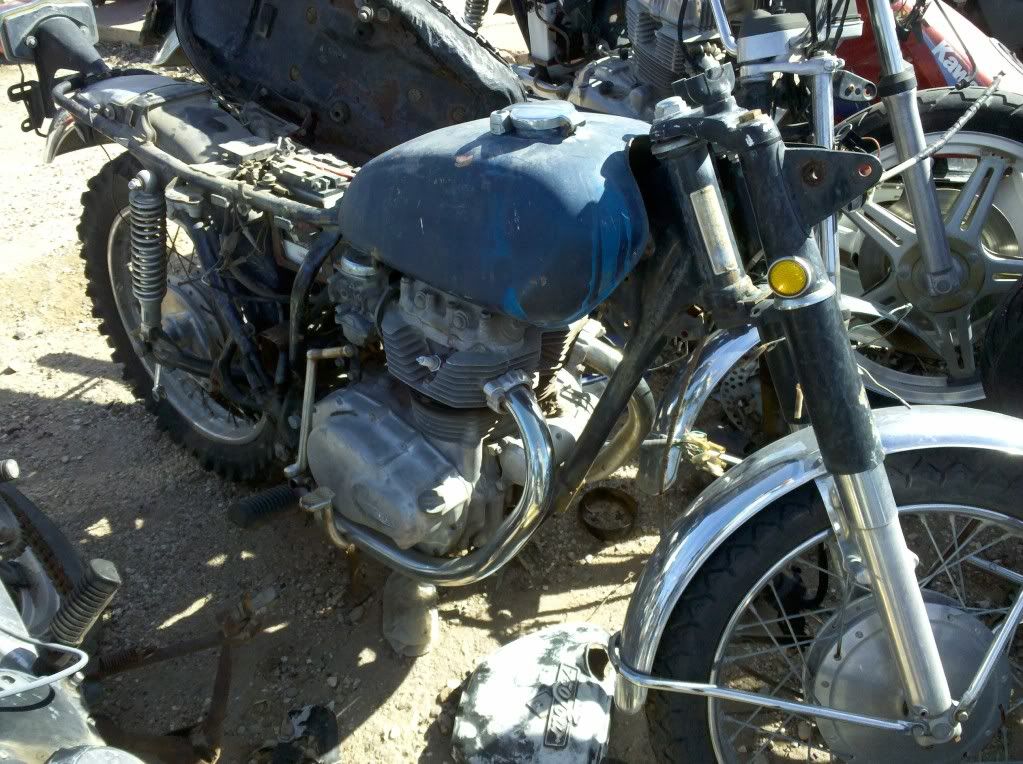

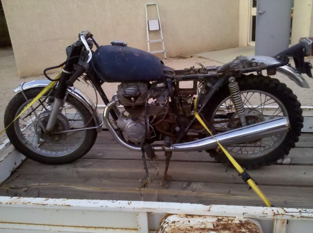

I have been lurking in here for a while and I have decided now is as good a time as any to start this build log.  I picked this bike up from a moto junkyard for $150 2 weeks ago!!

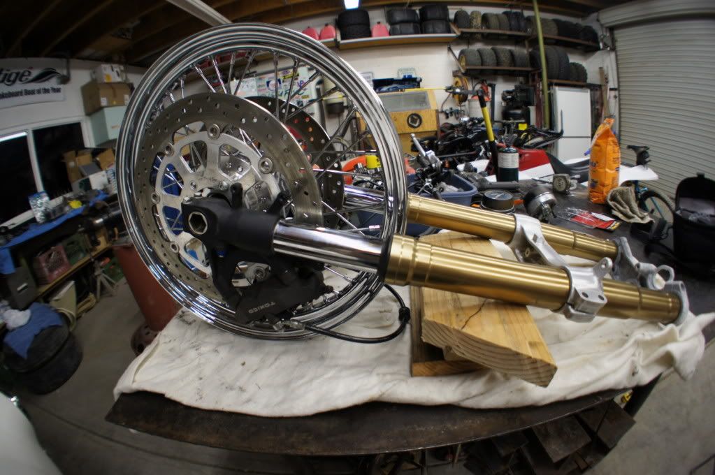

2006 GSXR Front end swap with an 08 Harley Narrow Glide 19" wheel

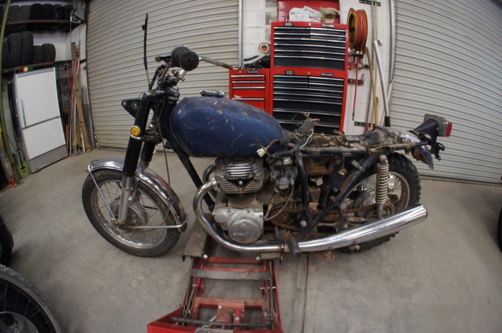

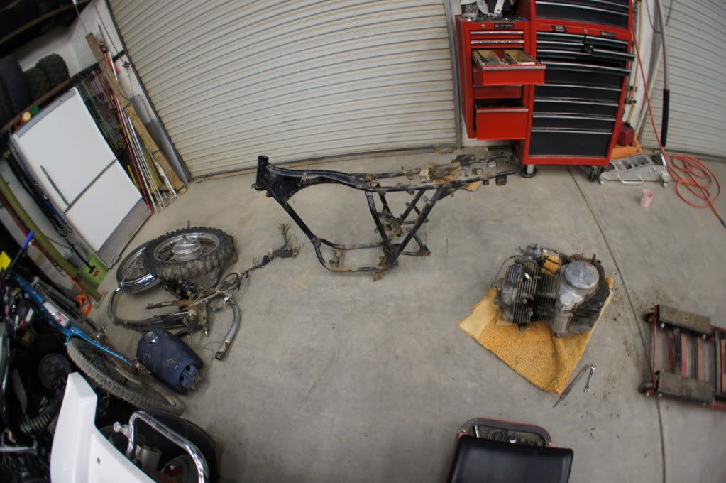

I had it for a few days and wasn't able to touch it until the weekend, it was killing me! But when I did get the time to finally take her apart, it only took an hour!

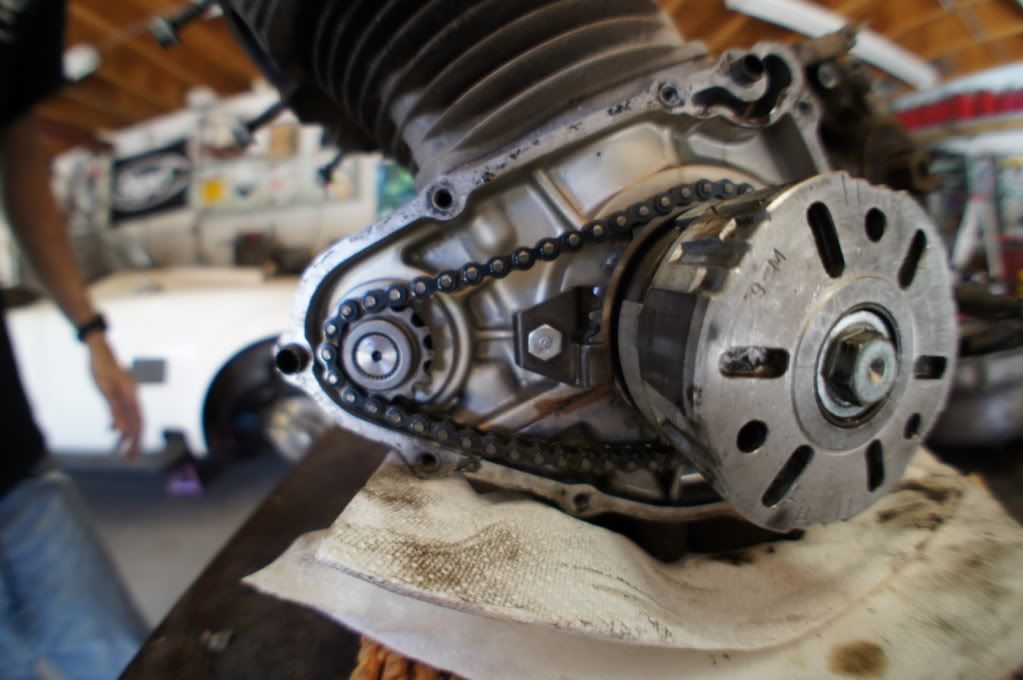

And started the engine teardown the day after:

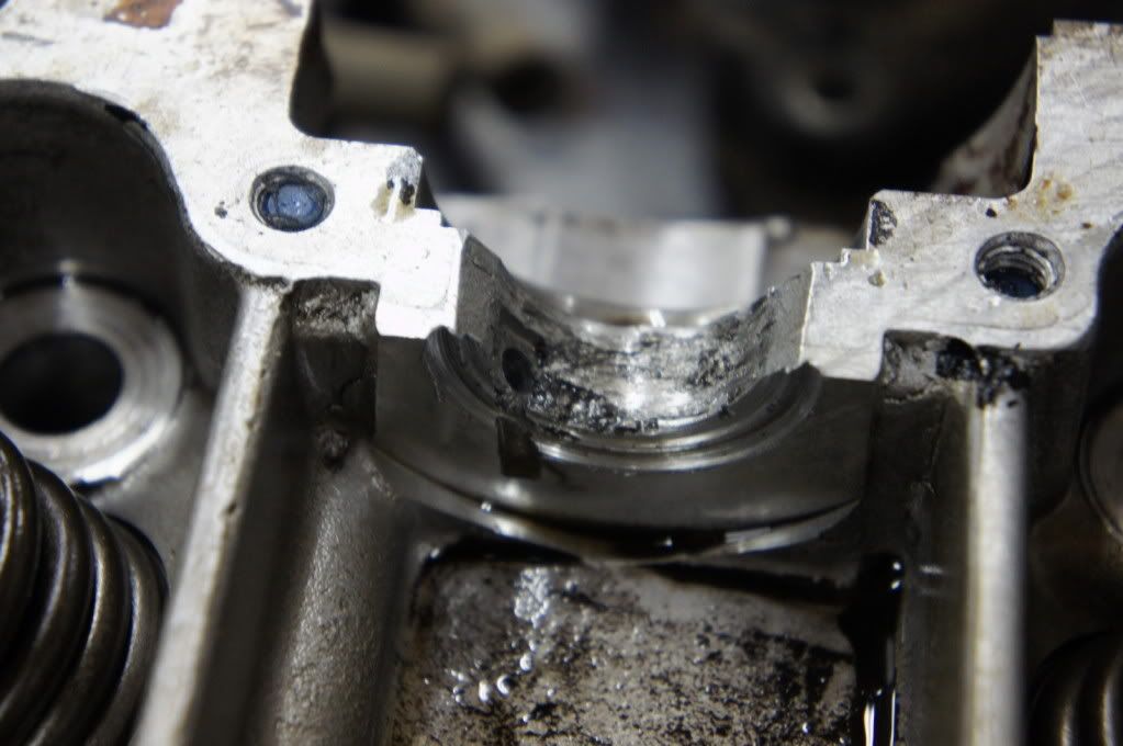

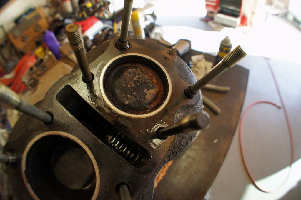

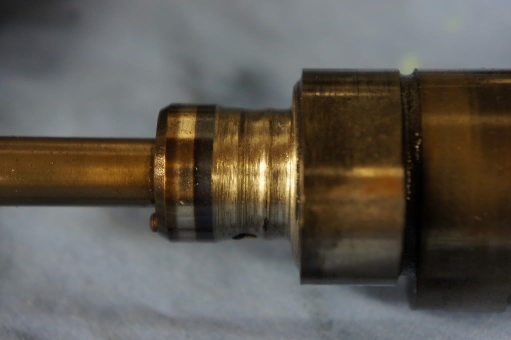

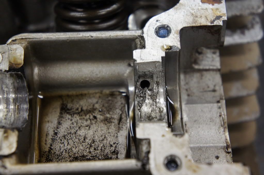

Found some issues...it looks like the cam got hungry and started eating the head  :-\
A new head is on the way and should be here soon.

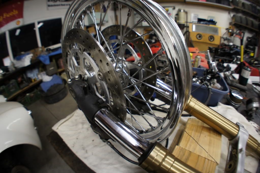

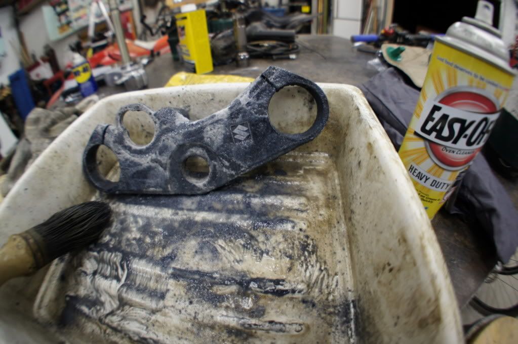

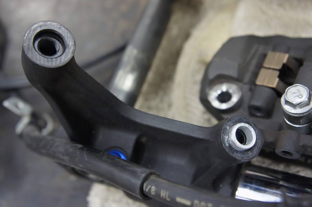

Started cleaning up the GSXR front end,
Oven cleaner loves anodizing!

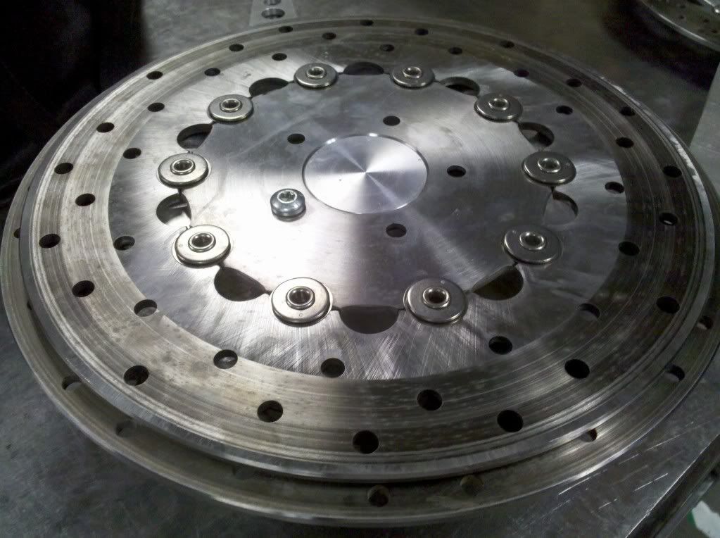

Redrilling the 2001 GSXR 1000 rotors:
Bigger diameter holds the ID of the GSXR rotor, smaller diameter holds the harley rotor
GSXR rotor centered on (already drilled)
Harley rotor on top of GSXR rotor, centered.
Insert center punch, BANG BANG BANG BANG BANG!  Then drill 5 holes, repeat for other rotor and new bolt pattern all done :)

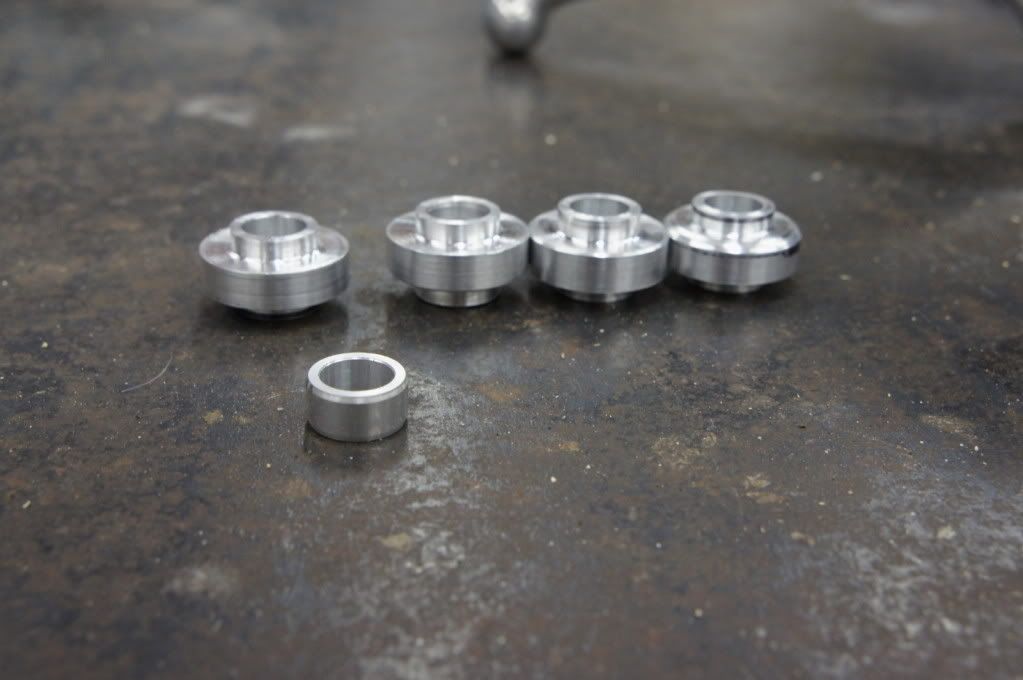

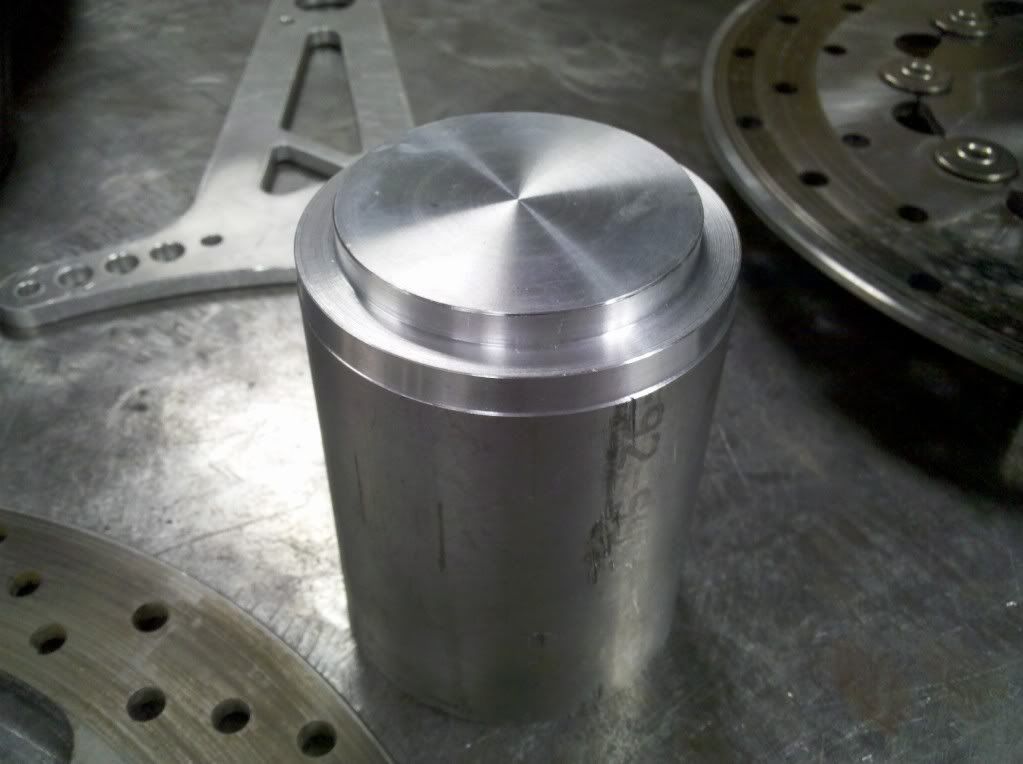

Figured out the 06 GSXR front end uses 310 mm rotors and the 01 GSXR 1000 rotors are 320...So I could either machine the rotors down or build spacers, I opted for the spacers so that if they didnt work I could have options.
Here are the little guys, with a 6mm lift and the original little one next to it.
The recess in the forks:

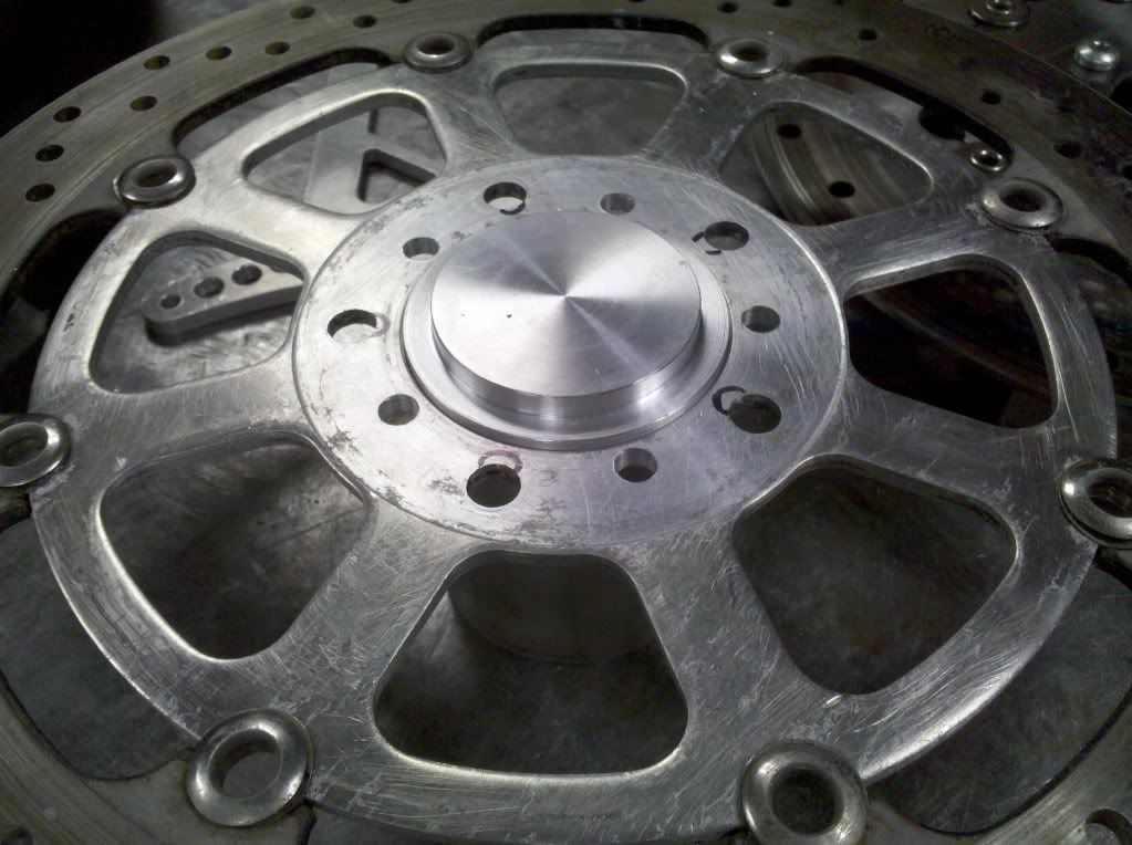

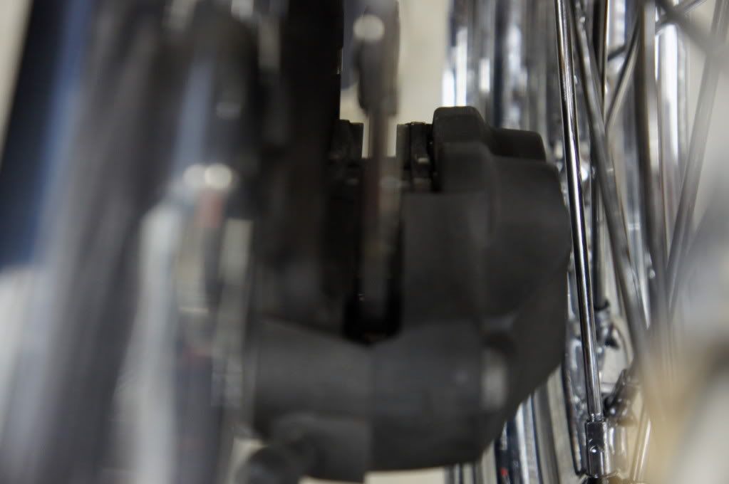

Installed and perfect :)
I machined them a little too "perfect" (read: too tight) and had to file the diameter on a few of them down to size to fit, but they fit and clear the rotors perfectly.
WE HAVE CLEARANCE CLARENCE!!
(Pre-new drilling and spacing)

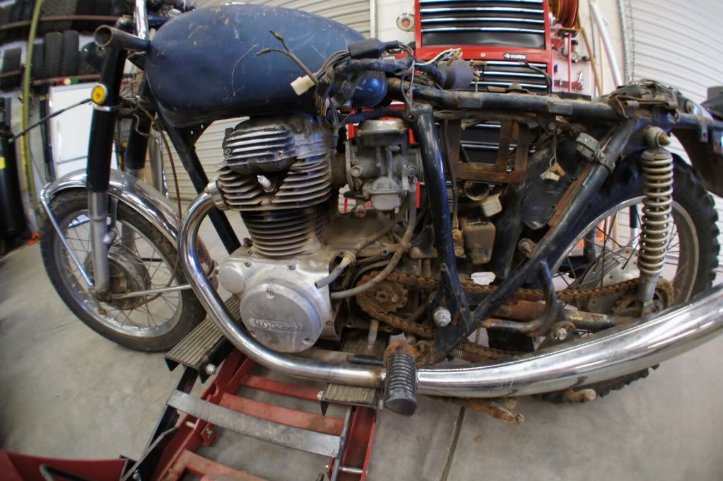

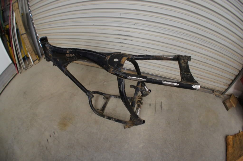

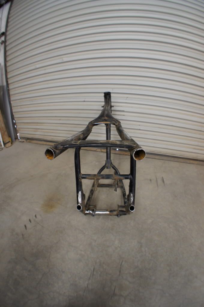

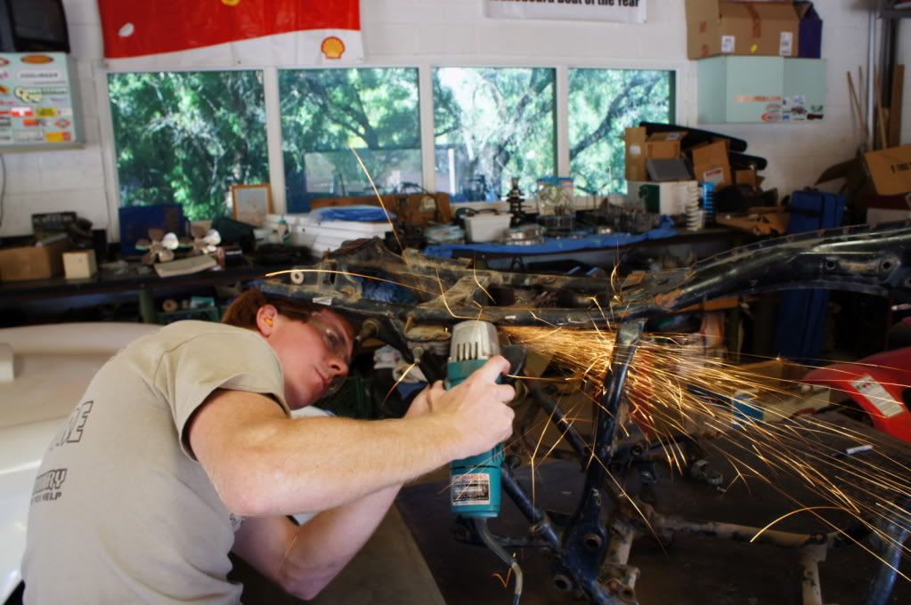

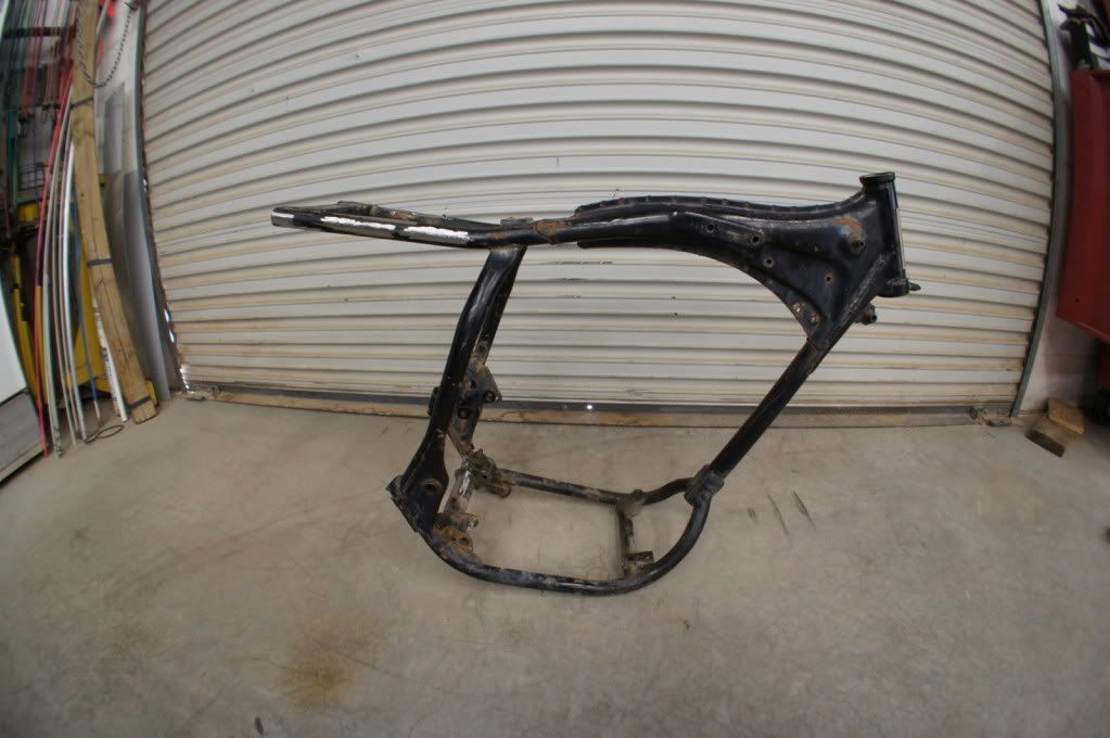

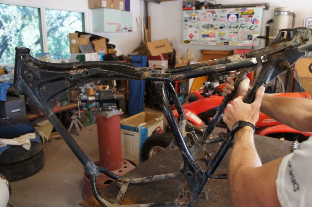

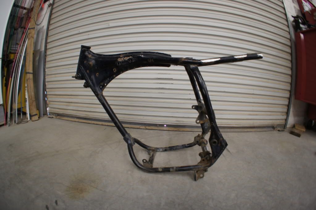

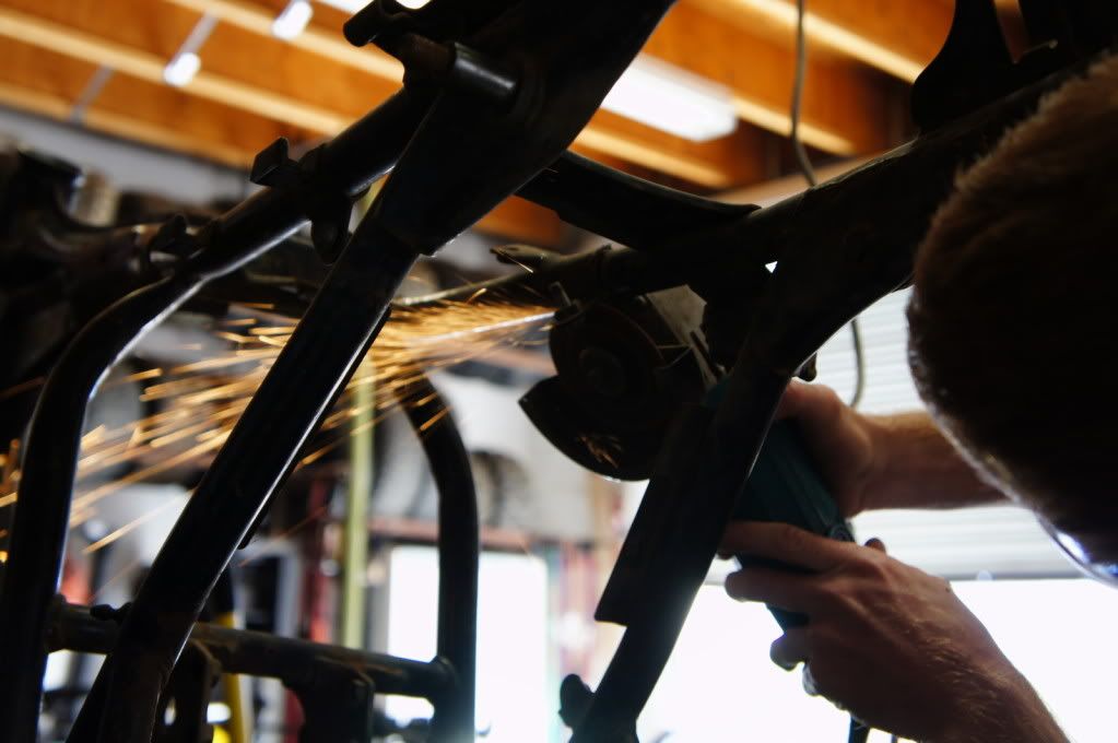

Started chopping the frame yesterday
AAAAANNNNDDD....CHOP!
First stage of chopping/ prelim grinding done:

Great start. Ouch on that cam.  It is probably repairable though.
That's a huge amount of breaking power for a small bike.  I think one disk would be too much, but two - overkill.  Just don't grab a handful.
I guarantee you are right, but I just like the way it looks...balanced...I have actually never even ridden a motorcycle for more than 100 feet.  I grew up on ATVs, and I wanted a smaller bike to start with so I don't have the urge to go too too fast.  I'm sure that it is going to take me a while to learn to ride, and even then, I am not looking to race, so double giant brakes are overkill.
And I doubt repairing that cam is possible, material is missing. I wouldn't even consider trying to repair that.  I found a suuuuper nice top end on ebay and its in the mail.

As long as you have a spare top end coming, that's fine.  The cam end can be machined down and sleeved and the head can always be bored to take needle rollers - for future reference.
