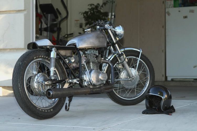

« Reply #57 on: Dec 07, 2011, 16:02:35 »
haha hell yeah, thanks fellas!
The front fender was half my inspiration for this build, it's the highlight for me.
The seat is two pieces, welded with that big red TIG in the background of the last set of photos.
Cut it to shape and did a bunch of bending; just with some gloves and elbow grease. Then welded em together at the top of the cowl and sanded the weld smooth. done. WORLDS lighter than a stock setup, just a flat piece of aluminum. I used the two stock tabs under the parallel seat rails to hold it down, with some standard 6M - 10 bolts.
I did get a cable setup to work but I ended up cutting and bending the stock brake rod in a sort of 'Z' formation. Worked smoother in the end, but if you take the time to make two tabs, all there is, is to have two stops to hold the cable housing between and that's pretty much it. I reused a stock clutch cable and just cut both it and the housing to the right length.
