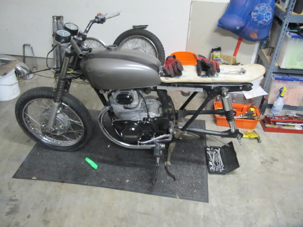

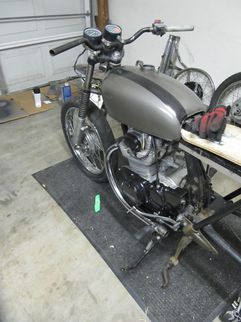

This project is slowly coming together

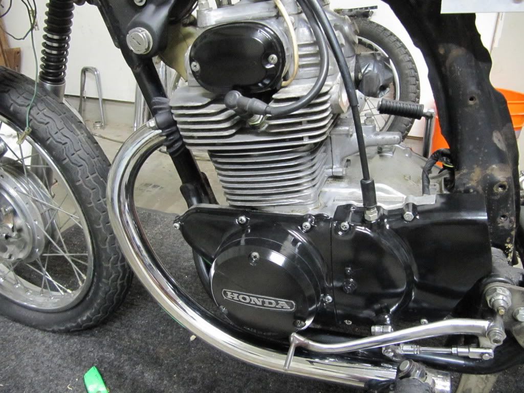

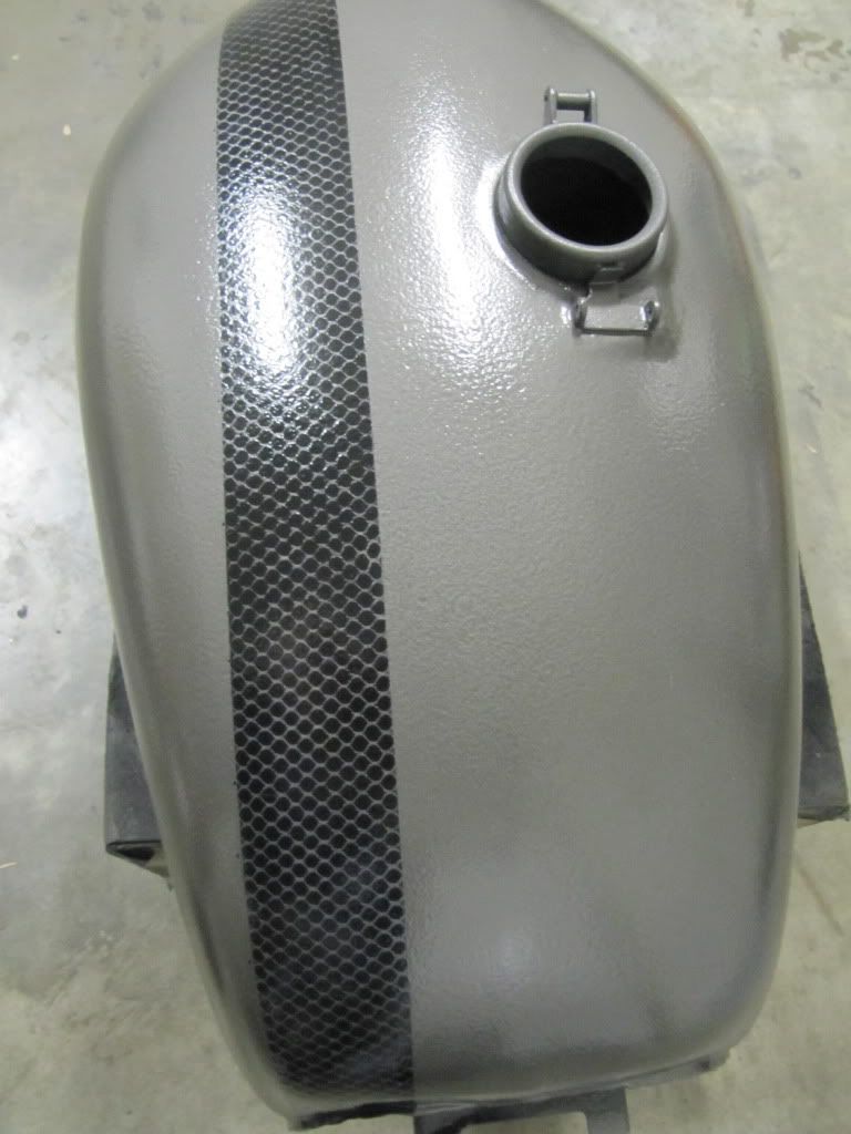

Completely stripped the tank to bare metal with aircraft stripper (that stuff does some serious work), as the first attempt at the tank wasn't acceptable. Got it all painted back up, and it is currently drying. Then I will give it a good clear coat. Used Rustoleum Hammered for the gray. It gives a pretty cool orange peel texture.
Got some of the engine covers primed and painted

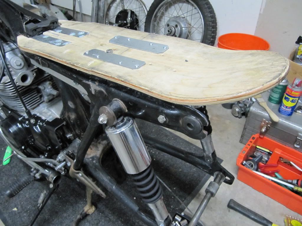

Finished the seat pan, now I have to find a upholster. Unless someone knows a good cheap way to do it yourself, which I prefer.
Working on taping the wheels for paint. Planning on painting the spokes and hubs black and leaving the rims chrome at the moment. Anyone know a good place to buy some rear spokes? I think I have 4 or 5 I need to replace.

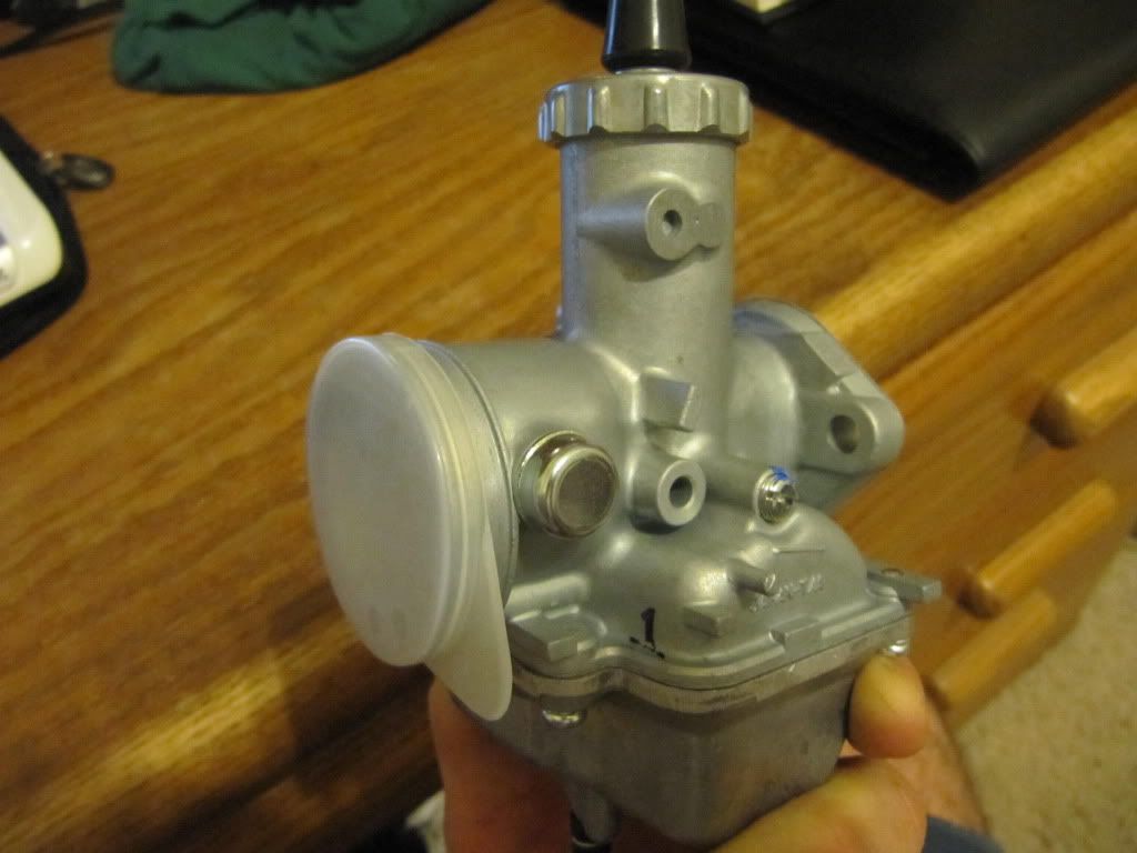

Got my carbs in like I said, but the knockoffs are turning out to be a pretty big pain as the mount on the carb is a flange, and not a spigot. So I think I will send them back and pick up some real Mikunis
Ordered some cables. Speedo, Tach, Front brake. (Got so fork seals in the mail instead of my speedo cable, so now I have to send it back and ask them to send the right thing. Bummer)
Finally ordered some parts from DCC: Headlight mounts, air filter pods, oil filter tool, on/off switch and a couple other things I think.

I just ordered some this morning from phatperformanceparts.com for about $160 shipped. A lot of place have them and some for a little bit cheaper, but most are out of stock and backordered right now.
When I ordered these their site said they would ship in 1-2 days. So I ordered them, a little bit later I got an email saying that the carbs where on backorder for 1-3 weeks. So I canceled my order
A little bit later I got a call from a guy that works there saying he dug around and found one of their distributers that still had a couple and said he would have them send them to me direct. So that's cool. Of course I told him I wanted them. Now I am anxiously awaiting the carbs.
I just have to start doing some research on the right jets for my set up, etc.
