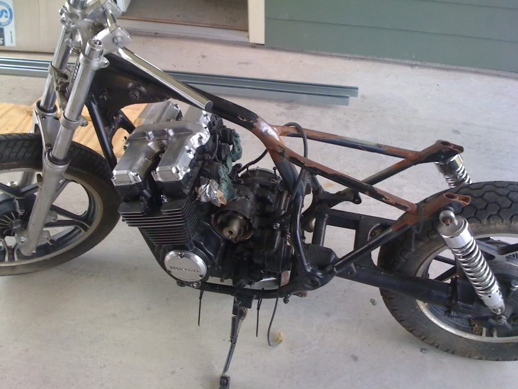

Well, I hope that I don't get the axe for having a DOHC honda but here we go. I bought the bike back in the early 90's for $500 and it was in good condition. I rode it for about 2 years then it started having charging issues and I parked it. I figured that I would tear the bike completely down, clean it, then troubleshoot the electrical when it was going back together....It never got put back together! About 5 years after that I tried an ill faded attempt at a mild "Kong" job only to go unfinished due to no welder. That brings us to the early part of this year when I got the idea to do a full hardtail bobber even though it is a shaft drive.
Here is how it once looked:

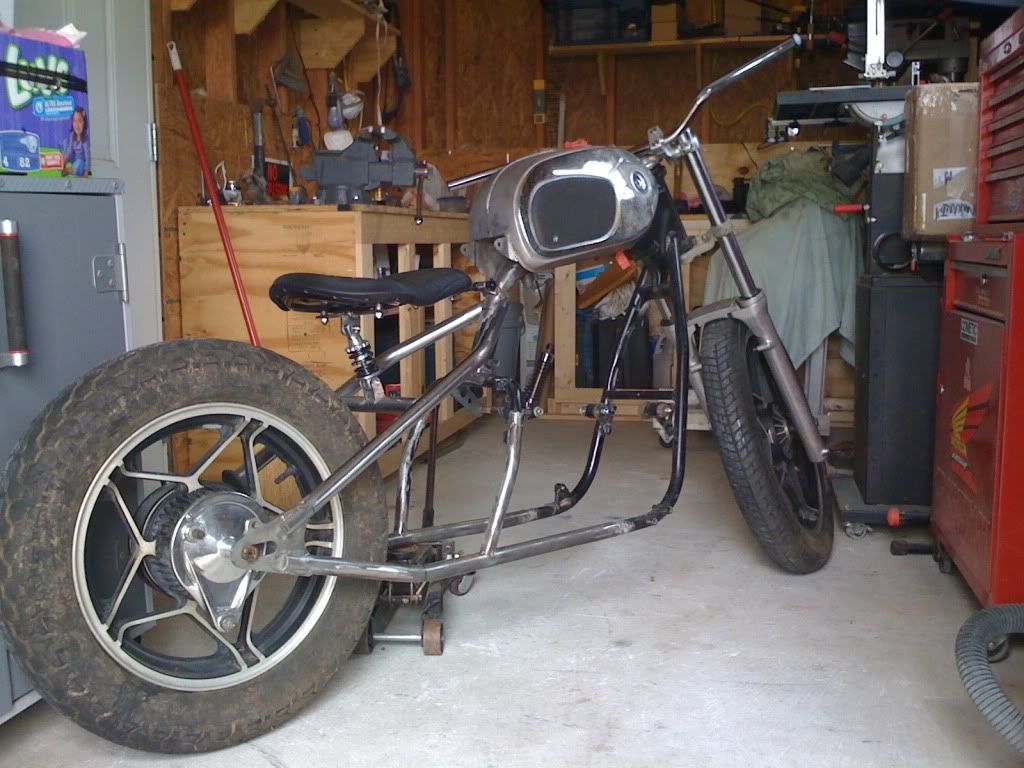

The bobbing process:

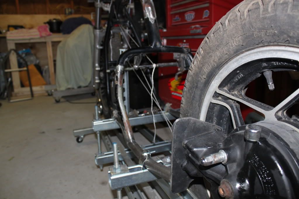

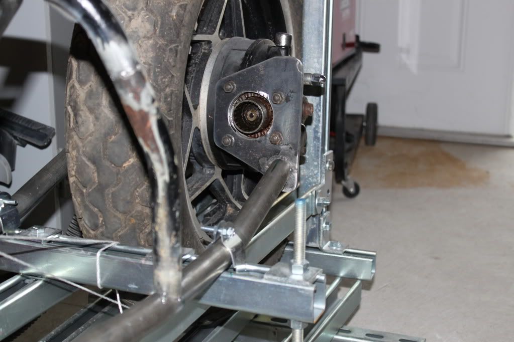

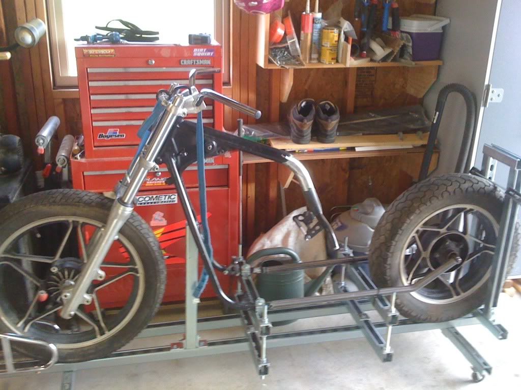

I used a scotch bright pad to get rid of old gasket.  A razor blade can work but you have to he very careful not to cut the aluminum and ruin your mating surfaces.  Cool build BTW.
Nice to see a good frame built with a Jig Etc.  Are you going to run the shaft exposed?  It would be neat to coat it in a nice powder colour that contrasts with whatever you do for a frame colour.

You talking about the unistrut frame jig? Haha
