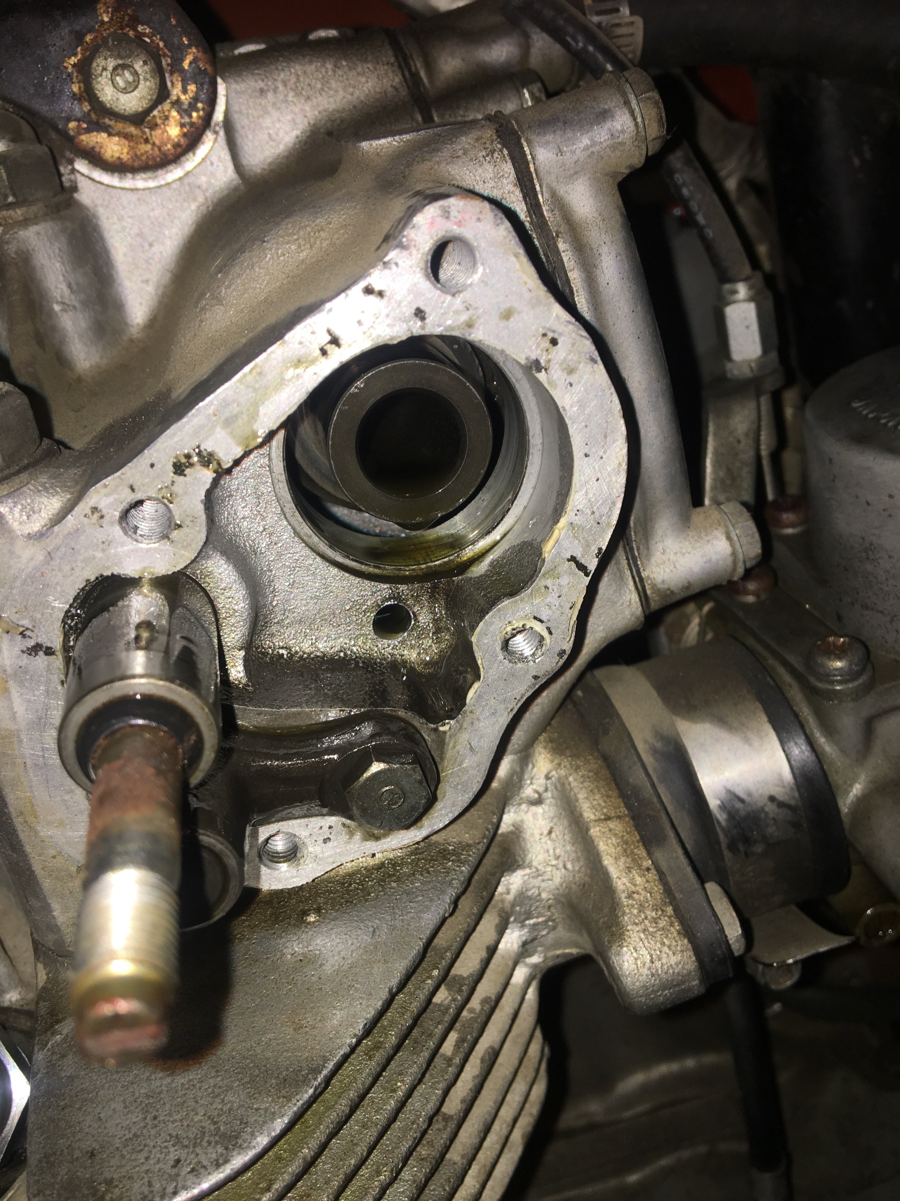

So I need to adjust the valves on this newly acquired (neglected) 72 CB450, as well as adjust the cam chain tension and finally set the timing/points.
I managed to get the stripped screws out... Now is there a smooth way to remove those covers?
Also, how to get to the valve behind the points? Does the entire point assembly come off for that?
Thanks in advance to whoever can help me with this.
Offline redrover
  • Posts: 160
Re: Valve Adjustment HELP (CB450)
« Reply #1 on: Jun 18, 2017, 00:31:59 »

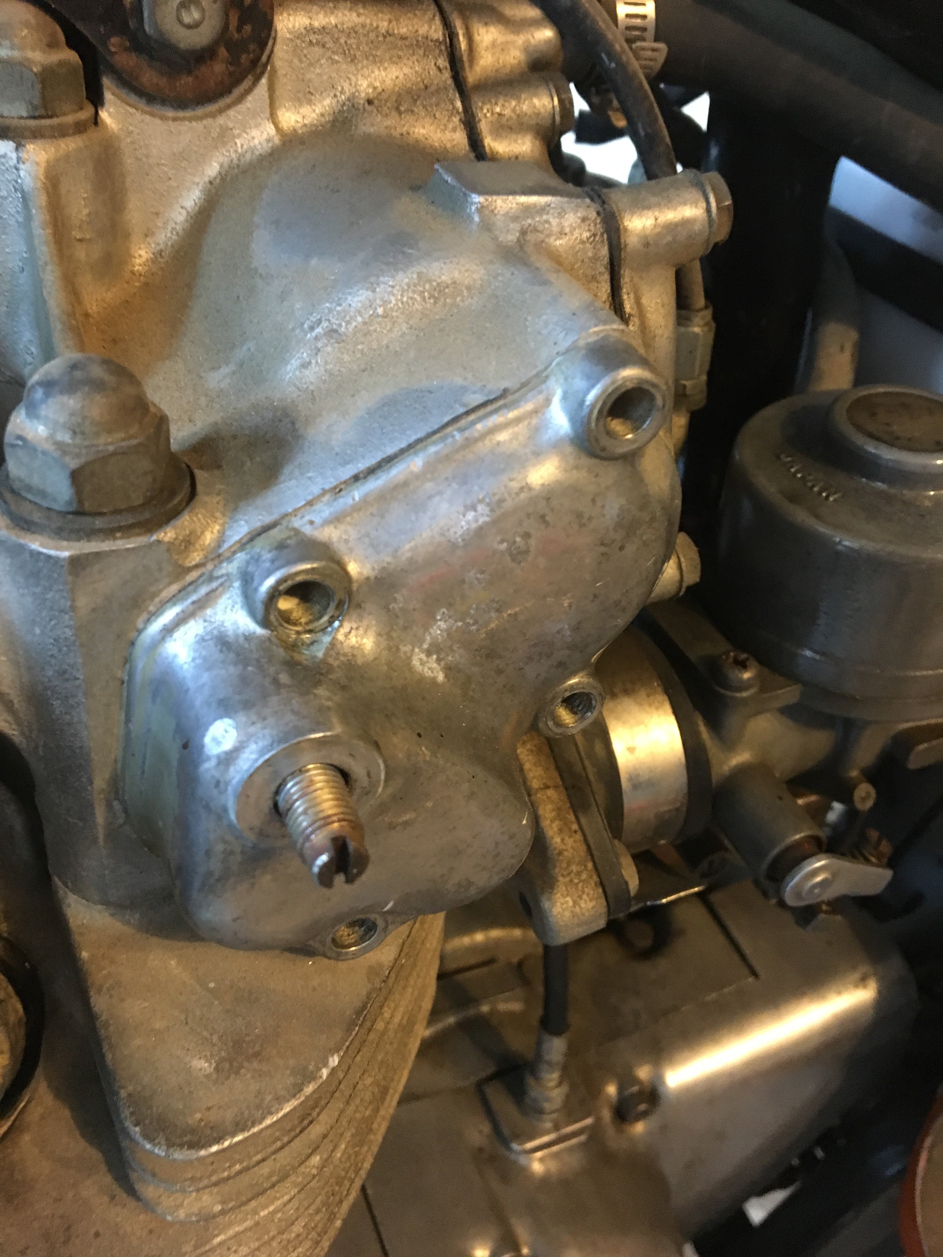

Ok so I managed to pry open one of the covers.
I've never adjusted valves on a 450... it looks way different than any other Honda valves I've seen/adjusted. Must be the torision bars!
Does anyone know how to adjust these valves?

stop what you are doing you have taken the wrong covers off
you have removed the adjuster
you need to get a HONDA SERVICE  manual
you can read this to start
you can screw this motor up right here and now if you are not careful
http://www.cb450stuff.com/manual/#Valve

Those don't look like valves to me...
here's a manual if you didn't have one already. The procedure should be in there.
https://drive.google.com/file/d/0B_ZumJE59-T4YjUwNjllMjgtZDNlYi00ZTcxLTgyNDEtZmIxOTlmM2ZlNTZl/view?usp=drive_web&ddrp=1&hl=en#

Yes!!! STOP!!!  Those aren't the valve covers.  That is the bushing that the cam spins in.  The cam is no longer supported on one side.  You could possibly have altered the cam timing and dropped the cam follower off of the valve.
Trust me.  This is how I bent a valve in my engine and instigated a rebuild.
Listen to cxman.
The valve covers are the big covers on the front and back of the engine, sort of rectangular, right next to there.  Above the exhaust and above the carbs held on with 8 bolts each.  Take those off before you put this piece back on.  If you put this piece back on with the cam follower (valve tappet) next to the valve instead of on it, you will bend the valve and you will have to take the entire top end apart.

Oh no! Too late. Hopefully he won't try to put the cam bushing back without actually checking that the valve tapets are in place and have not slid off the top of the valve stem and is now next to its side.
Dude, if you're not careful and try to put this "cover" back on hoping nothing happens, please stop. When this is removed the rocker arm usually slides off and falls next to the valve stem. And if you try to put the "cover" (really a bushing like Flug explained) you will bent the valve stem as you tighten those screws. If you wonder with it is harder to turn those screws in that expected then it's too late. Flight and I speak from experience. Not proud of it myself, but I learned a lot from this motor, from having to do a rebuild.

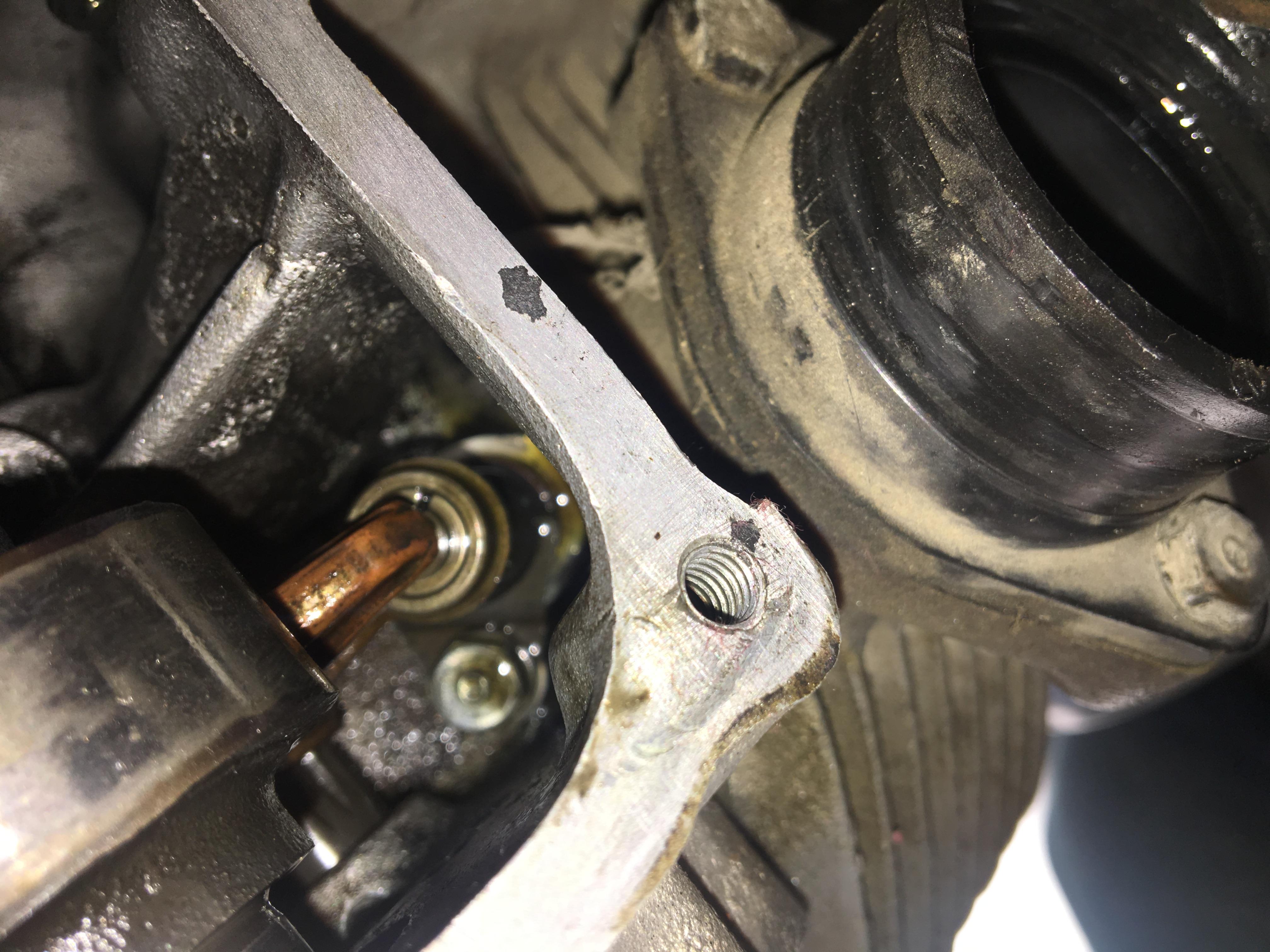

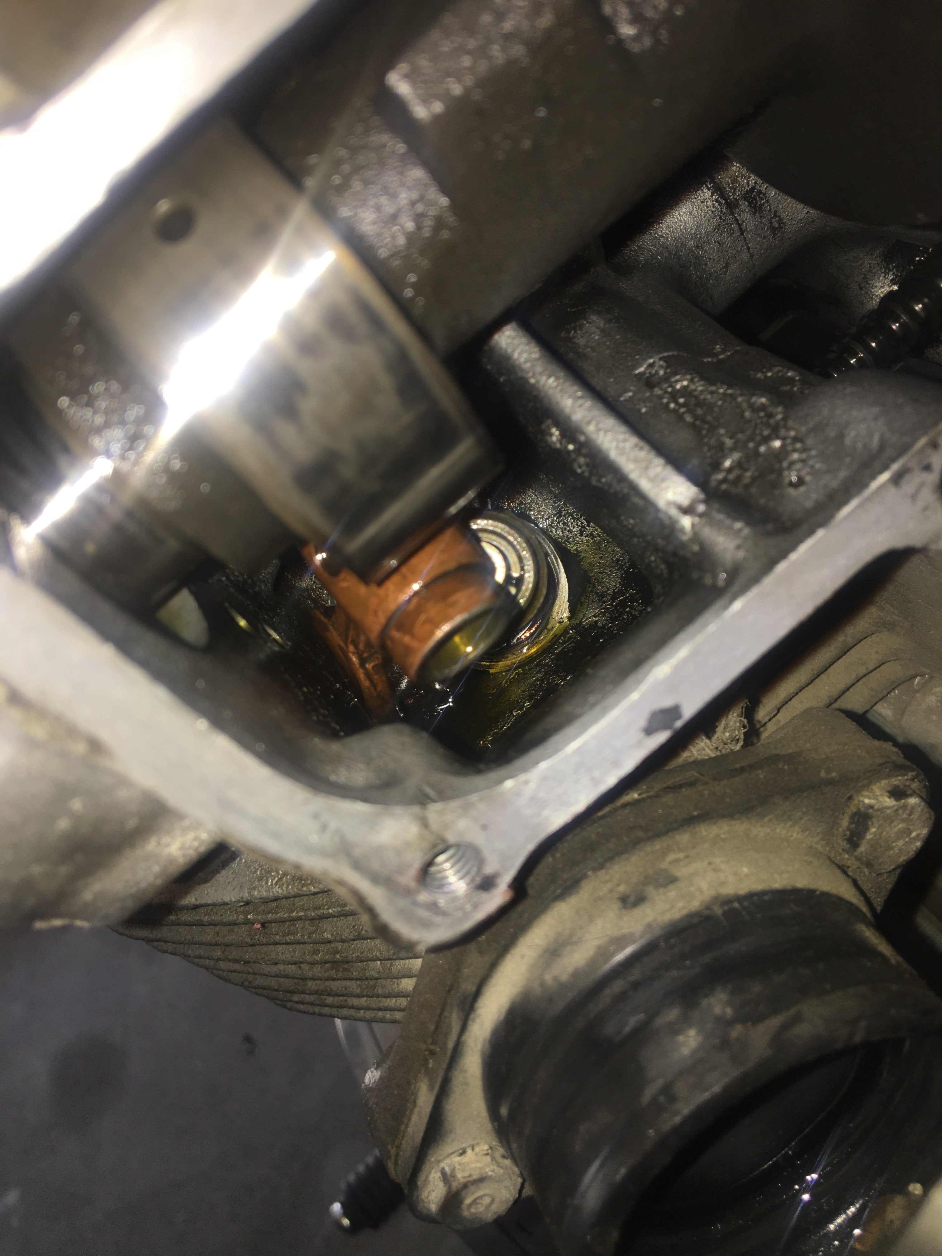

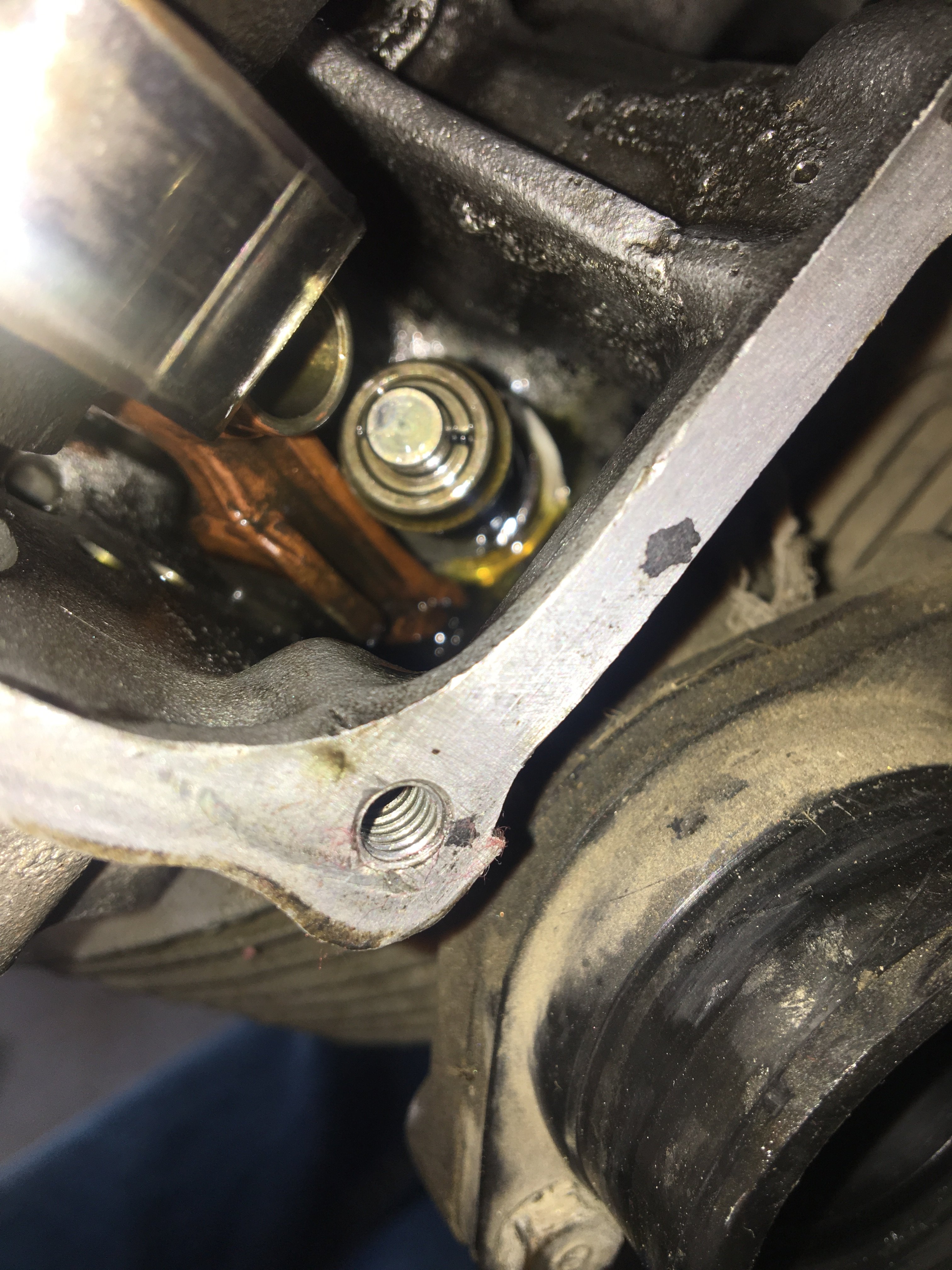

I will take off the front and back valve covers (correct ones this time) and take a photo to make sure that I have put everything back in correct place before putting everything back together.
Offline redrover
  • Posts: 160
« Reply #8 on: Jun 18, 2017, 20:48:07 »
So as you can see in the photo, the rocker arm did slide off and fall off down near the valve (I remember hearing it fall... I feel like shooting myself!). Good news is that I haven't forced anything and quite certain that I did not bend the valve.
Is there a way for me to realign it from this point without tearing into the head?
