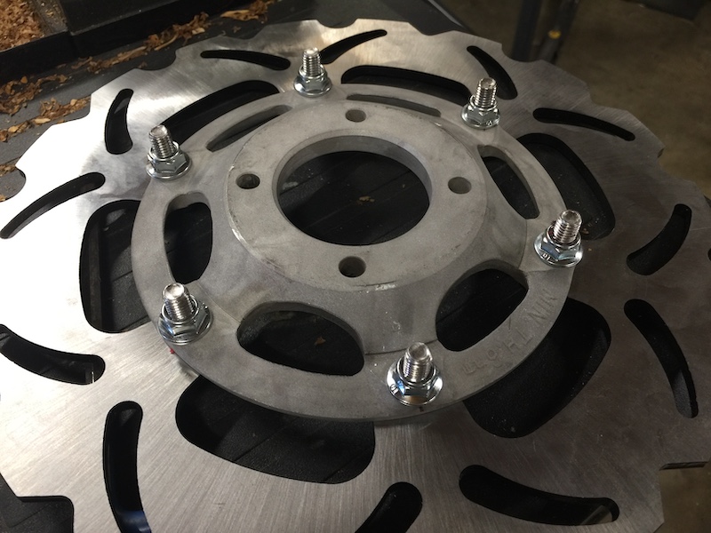

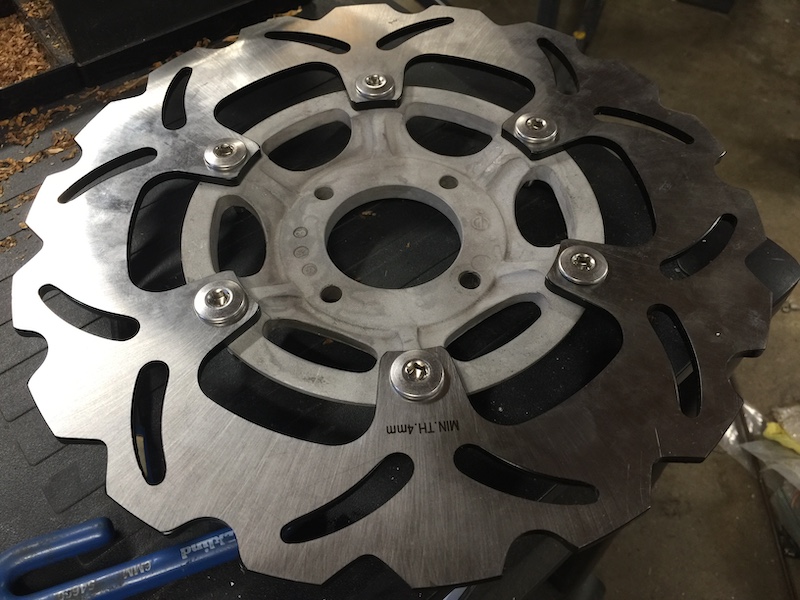

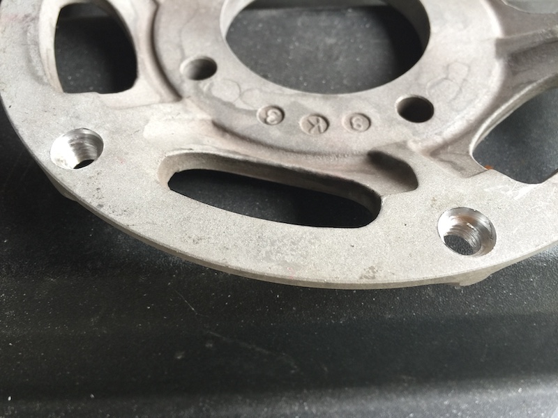

Attempting to replicate Irks brake upgrade.

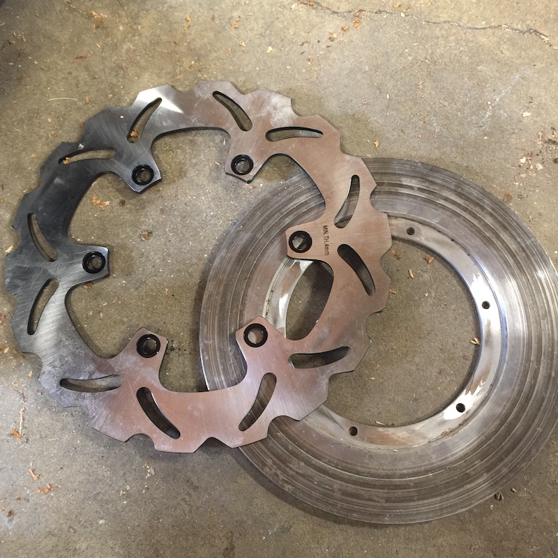

Using factory Honda disc hub w a Kawasaki disc...
the new disc is larger diameter + lighter.  I will weigh parts before installing.

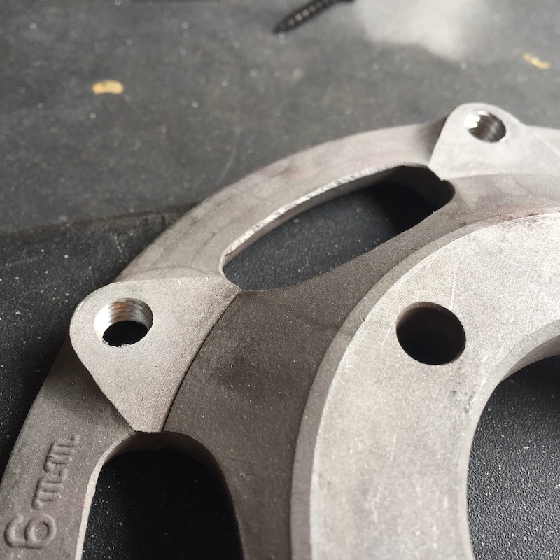

Drilled, tapped and countersunk hub for the shouldered Kawasaki bolts.
Fitted w aluminum crush washers as the bolt heads didn't quite fit the disc as planned.
Jammed w flanged locknuts.  Will knock off excess threads before paint.

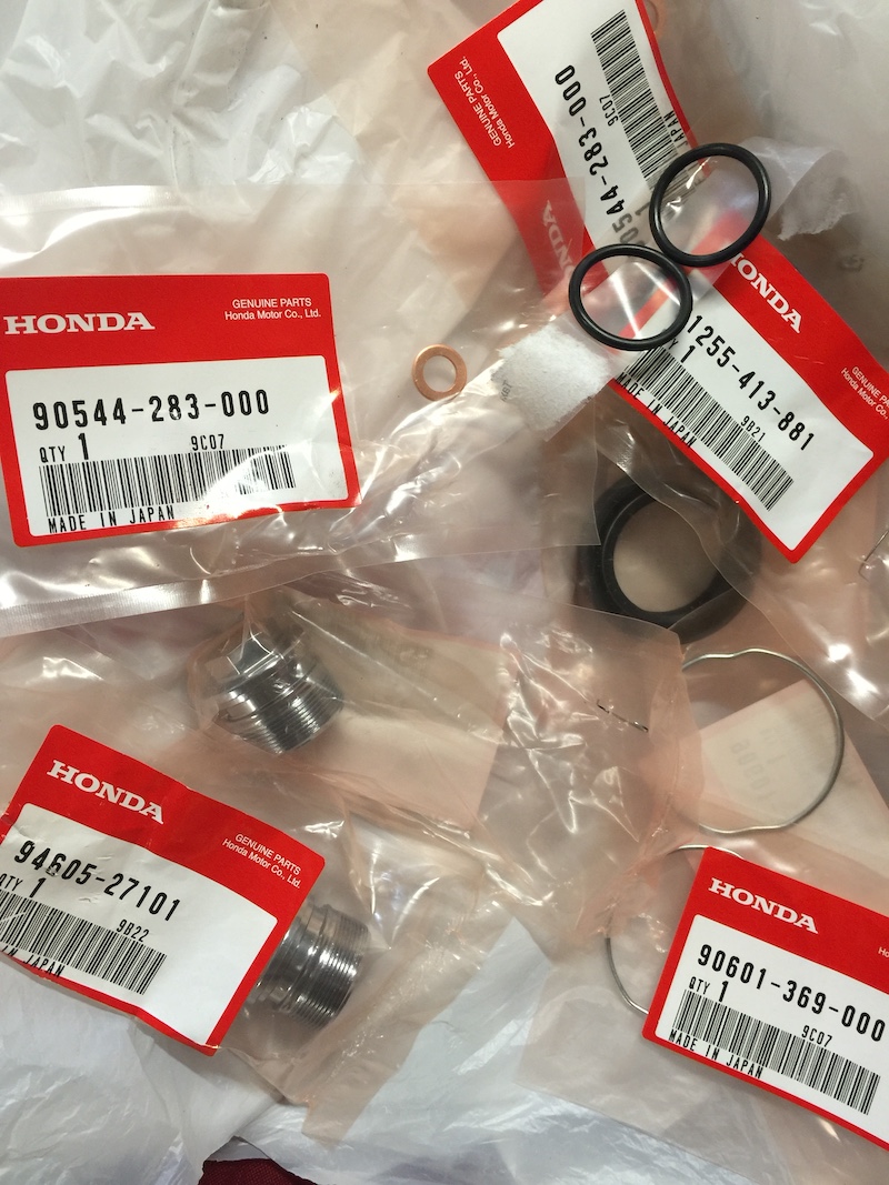

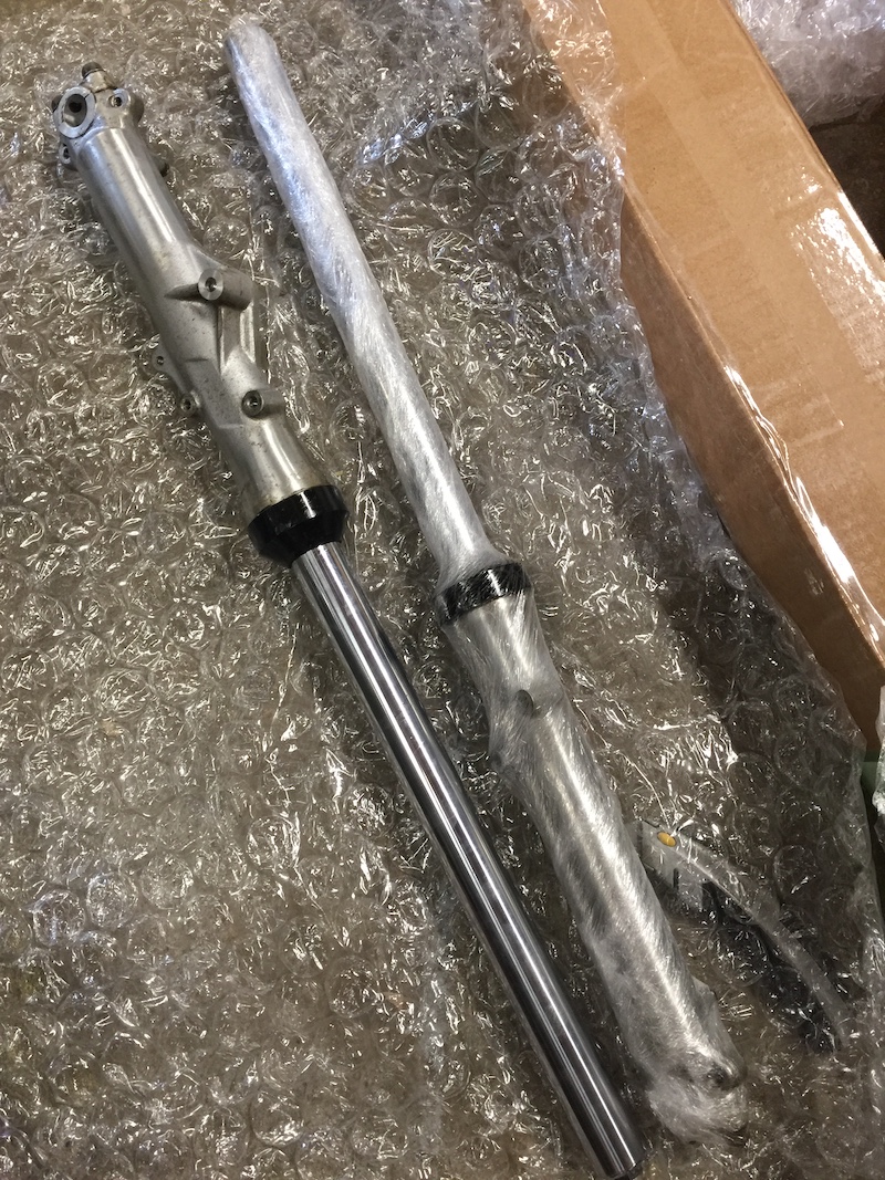

Picked up a second set of forks, along w everything for rebuild...I will swap these for minimal down time.

Looks great.  What Suzuki rotor is that?  I used an EX500 rotor.

« Reply #636 on: Jun 15, 2019, 00:04:23 »
Advertised EX500.  Not made exactly to spec Im sure.
EX500 is Kawasaki. It's a Ninja.
Advertised for Ninja - ex500 - gpz500
That's what I said.  I'm trying to figure out the Suzuki part.  You said Suzuki.
Using factory Honda disc hub w a Suzuki disc...
