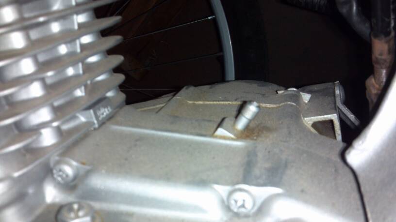

Hey all,
I picked up an almost complete cb100 in September, and have not had a lot of time to work on it. It's a cb frame, and a cl motor. Guy I bought it off did a lot of work but decided to pursue different interests. It had two year old gas and a dead battery, so I cleaned the tank and carb, bought a new 6volt gel battery, and ordered a regulator/rectifier from sonreir. I've never owned a 100, and am wondering if anyone knows what the nipple is for in the pic. Thanks.

That's the crankcase vent. Just attach a hose and route it along the frame to the ground.
