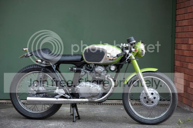

G'day all, I've been on the site for a while now and was really impressed and inspired by many of your bikes, so I thought that I would attempt to build my own cool little bike.
The original plan was a full Cafe Racer, however this evolved into a Bobber as the project was half way through.
I found an old rusted, non running 1970 CB 175 on ebay for $410 and picked her up on April Fools day this year. Now 4 months later, it' finished and just passed its registration inspection today. woooo hooooo.
Here is a link to some before and after pic's of her, let me know what you think !

Here is a couple of other angles.

Very nice indeed, liking the clean lines of it a lot. Just wondering about that front tyre, looks as though you've got it on the wrong way for the direction of the tread...you'll be sucking any water directly into the centre of the tyre and not dispersing it out to the side. Otherwise its a beauty!
Cheers - boingk
Thanks
I thought the same thing about the front tyre, however it has direction marks going that way (different depending if mounted on a front wheel or rear)
This looks great and it's giving me ideas for the bratty build I'm working on.
Did you do the seat yourself? It looks really slick.
Thanks for the feedback,
As for the seat, I took it back to the bare pan, and shortened the front and back, and then mounted the tail light into it, then just took it to a local auto trimmer to have him put it back together.
