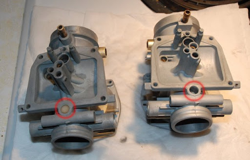

I cleaned the carbs bybrass brushing, boiling in Lemon Juice, Then blasting with the home made soda blaster. Worked GREAT! They look like brand spanking new! BUT seam to have lost a little plug... See below
DAMN THEY LOOK GOOD!
See the Red Circles.... Lost Plug
OTHER GOOD LOOKING SIDE!
Anyone know if I can just seal around this with engine glue??? or tape over it? Or have a spare plug? Or know where I can get one?
Once I find the replacement I'll be putting all the cleaned and painted parts back together.. CAN'T WAIT!!!
Thanks!
BCB

I have a few spare carbs, so I should have an extra one.  Pm me your mailing address.

Anyone ever had stuck slow jet? It is the one below the rubber plug (screws in with a flat head). I can get it to turn and be "loose" but is seems to be stuck in there from years of crud.... I've boiled them in Lemon Juice, Water, and blown the crap outta them with 120 psi! I have replacements so I guess I could kinda drill it out till i can get and easy out to grab... But I was wondering if there was a "Why don't you try this" Idea.... More heads are better than one!
Offline rjz5400
  • Posts: 294
  • grummble grumble
Re: CB350 Cafe... 6 years in the making!
« Reply #29 on: Oct 21, 2009, 18:07:21 »
for things like that which are not rusted or galled in place by dissimilar metals i would use a solvent (such as fresh gas) or wd-40 and just screw it in and then back out in and back out. it seems a little suggestive but i have done this on lots of little things i didn't feel comfortable using pressure on and it eventually works. just wipe the threads with a q tip or my favorite, a gun cleaning cloth, super cheap and low lint, to get the residue you have freed up of the threads.
then relube and repeat, after a while it will come further and further out.
too much force can deform, widened shrink or close off the tiny idle jet hole . so take your time and then when you get it out.......... clean the shit out of the threads inside and out so it doesn't stick in the way back in!
