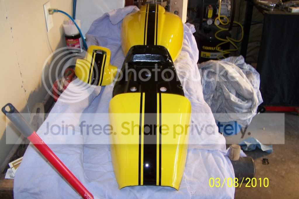

Painted Frame
Painted Body
Different View

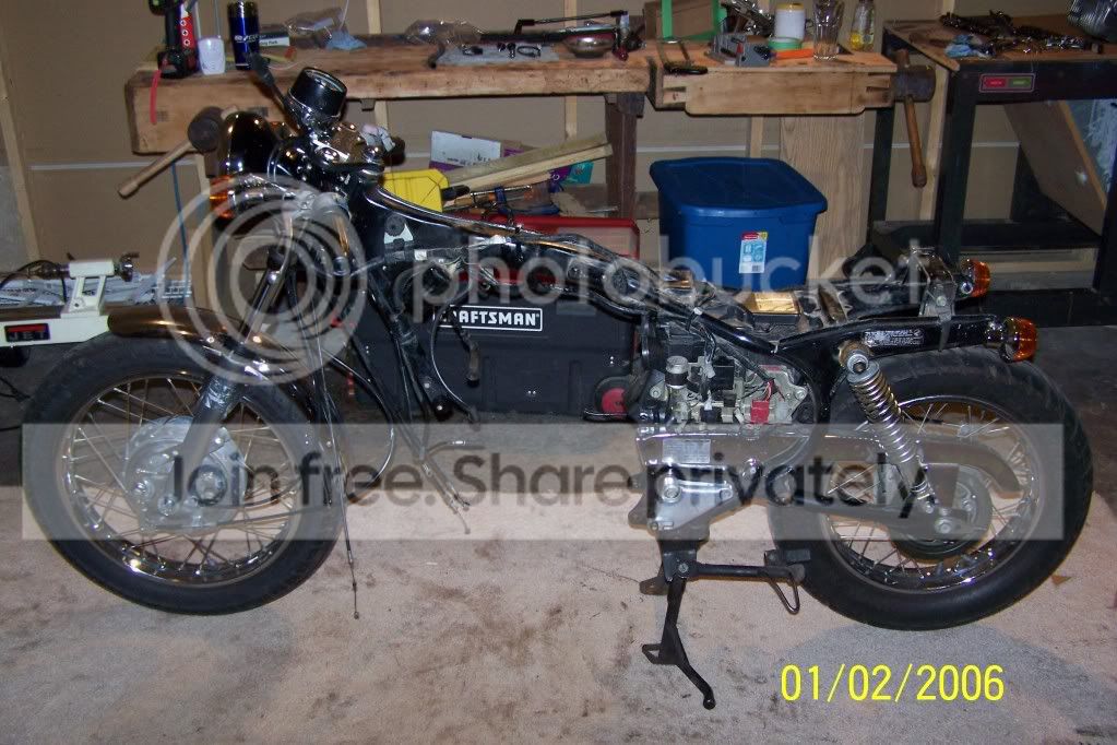

Putting her back together
More Pics
