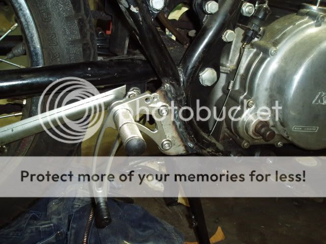

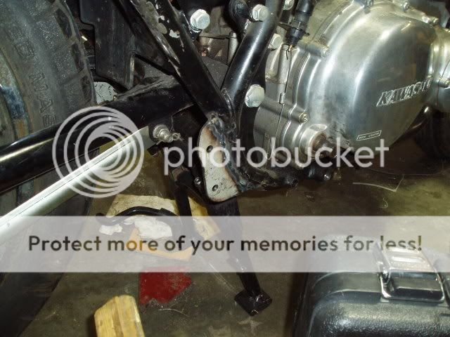

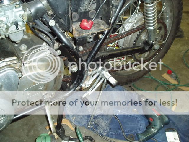

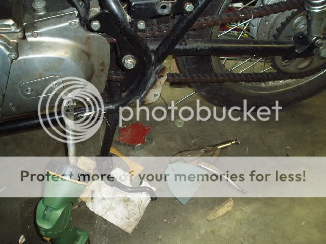

After spending 2 hours in the dentist chair this morning getting 3 crowns I decided to take the day off and work on the bike to take my mind off the pain.  ;)  I got the plates welded on to mount my new rearsets so now I'm on to sorting out the brake and shifter linkages. Unfortunately it look like the shifter linkage that came with the rearsets is too long so I 'll have to find a shorter one and I think I'll make a new brake rod from scratch from some 1/4" rod bent to form and threaded to fit  Here's some quick update pics.
My buddy Dave hard at work...
And the rearsets bolted to up to try them out for placement. They feel perfect.  ;D
They still need some touch up grinding and painting of course but I'm quite pleased overall.

« Reply #66 on: Feb 18, 2010, 01:21:21 »
You may be able to modify that shifter linkage. Might be worth throwing a pic up or at least describing it a little. If its just a rod you could cut it down and rethread it. If its a rod that the ends thread into you can cut it redrill it and tap it. keep it up.

« Reply #69 on: Feb 18, 2010, 11:45:50 »
Oh yeah I forgot to mention a word of caution to the other KZ400 builders that the stock kicker won't clear the new rearsets when mounted where I put them. Fortunately another buddy has his CB550 in the garage as well so I borrowed his kick lever to see if it clears which it does but the grooves on the spline are a little different so I'll have to open it up nice and wide to slide onto the spline and then tighten it down. I'll probably pick up a CB550 kickstart lever sometime this week off Ebay. I'll post pics once I get it and get it on.
