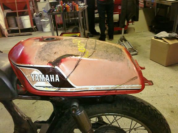

well not quite a killing machine yet but will soon be with A LOT more work anyway, I bought this bike in the summer in good mechanical shape and poor cosmetic shape (just what i needed) and tore it down pretty much right away. an influx of funds has brought me to this point now where i can start buying stuff  ;D for now i working on the seat which will start from this rd400 tank.

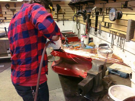

started cutting it promptly.

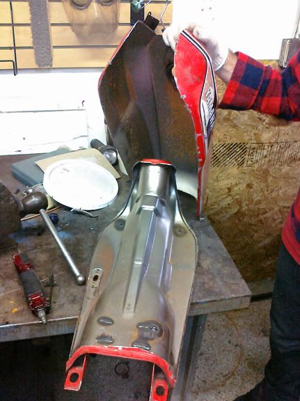

it's a shame it was so clean inside :'(

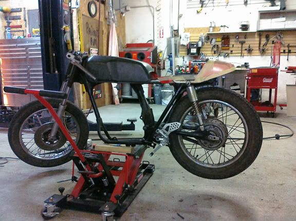

more cutting...
basic shape.

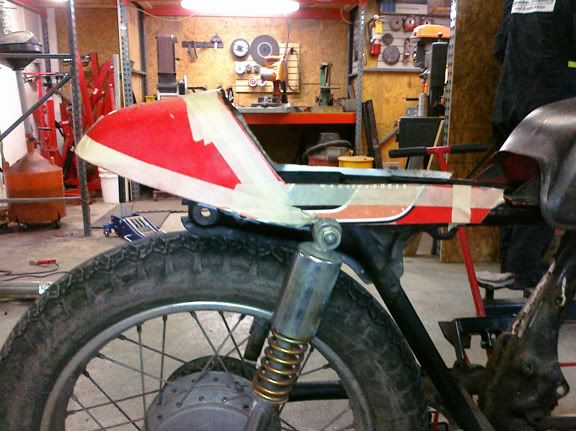

gonna cut off everything visible underneath the rear end of the bump next and finish mounting the tank. (the front is in)

wow.....ive NEVER liked the seats made out of tanks but that is GORGEOUS

Very nice lines... I like

It's a shame to cut up such a clean tank, but it is making a killer seat!

thanks you guys, having the same tank to start with as the one i'm using for the gas tank really helps it flow together. But it's amazing how very little tank I actually used. I'm getting sheet metal this week so more pictures to come.

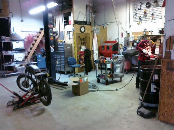

Looking good! Got a CL myself. Is that a metal cam roller? Thats what I wanted but couldn't source one, thought about making one, but changed my mind. Nice looking shop there too btw.
