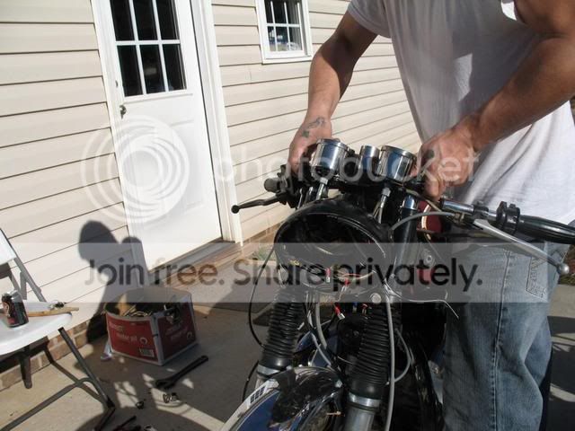

First thing I decided on was to remove the front windshield fairing, Although it looks ok, I personally can do without and it wasn't properly mounted anyways and had some damage.
This doesn't scare me, I've seen worse. Thing is, every other connection has a crimp connection on. I will go the solder route when I get to it. The gauges are not lighting up at the moment.
Here I am removing the brackets for the fairing.

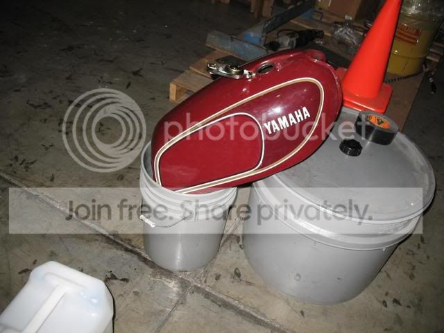

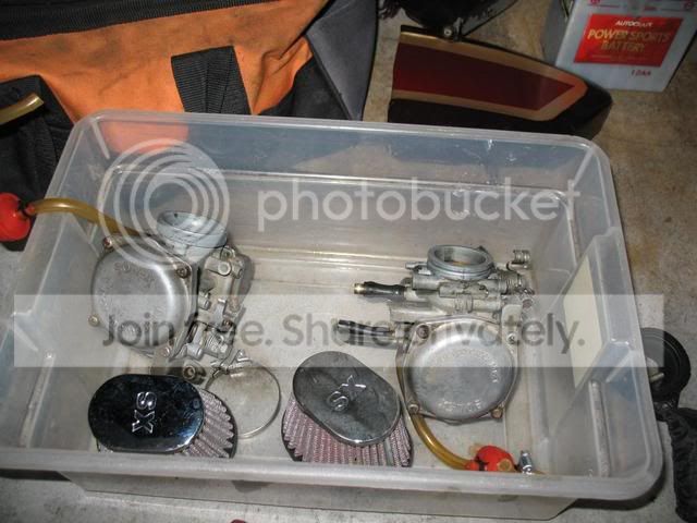

Alright I have been busy with other stuff, this week and last I did a bit more work and it turned into a nightmare. it was supposed to be a "just rejet the carbs and get new tires type deal"
I finished the carbs got new boots then onto the tank i went and what a hack job mess the P.O. had done.
I had to take the tank off because it wasn't sitting straight and I wanted to know why. Well there you go. Now I have to cut and weld tabs on the tank to fit the frame. since the P.O. grinded the tabs off the xs750 tank so he could stick part  the bottom of the stock tank to make it fit.

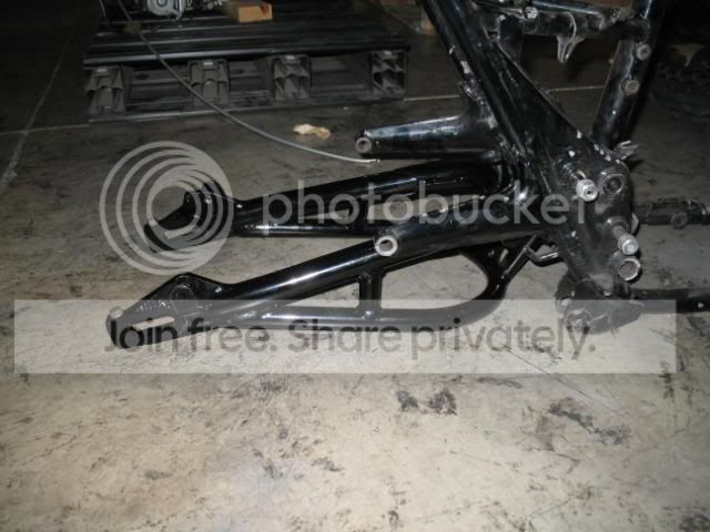

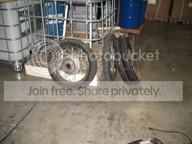

Then I decided to upgrade the swing arm bushings. As I was trying to remove the swingarm to add some brass bushings I realised that the swing arm bolt was seized into the frame and I ended up having to cut the whole swingarm and then drilling thru the bolt to get it to come off the frame.
3 blades, 2 cutting wheels and 6 drill bits later:
Who needs a bike lift when I have this:
So I decided, enough of the chit-chat and took the engine off, the front forks, everything came off.
Next thing I'm about to do is sandblast the frame do some minor work to it and paint it. I haven't decided on a color just yet, but i'm leaning towards red or copper. If red then the tank will be silver and if copper then the tank will be black.

hey... im not the only guy sitting on my frame like that i guess...  ;D ;D
looking good.
any idea what tank that is? im realllyyyy diggin it.
Haha, post your photo of you riding your frame here!
That is a XS750 tank, I'm diging it too. ;)

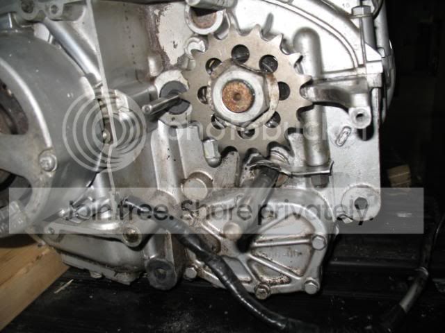

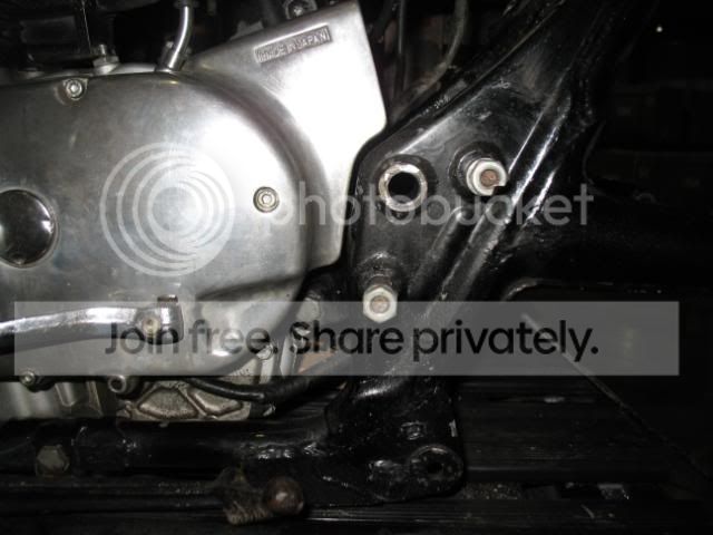

« Reply #13 on: Mar 08, 2010, 12:26:19 »
Well, I had to put on hold my frame powder coating until next week. I have some massaging to do on the frame, remove stuff here and there. I'm still iffy about removing the passenger fot rest brackets as I am making this a two up bike with a quick removal of the rear cowl. My biggest thing is, the battery wil be in the stock location, but i don't want to use the stock tray and want to make it look cleaner. if not, then I will have to use the side covers the bike came with. That would eliminate me having to build a new battery box and relocating the wiring. that so far seems to be the best route. Another thing is, I don't know if i should remove the center stand brackets. I wish the center stand was there to begin with but since they aren't there I'm thinking of just removing and smoothing out the frame by removing the brackets.
I have a big pain and that is removing the exhasut manifold studs. they are all seized in there and I can't seem to get them out, I think I am going to need proffesional assistance with that one.
Anyhow, the motor is still dirty but I replaced the cranck sprocket seal, the shifter seal and the clutch rod seal.
I had my buddy Tom, recreate the frame for me and weld some added tabs.
Also my tank now sits straight.

« Reply #14 on: Mar 08, 2010, 12:31:12 »
Also got this swingarm to replace the one I had to cut to pieces to remove.
the thing is, the passenger foot rest brackets are not on the way, but I feel they are aesthetically or visually on the way. but I want to make this a two up bike so I don't want to cut them off unless I can figure out another way to relocate the passenger pegs.
