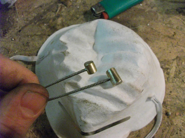

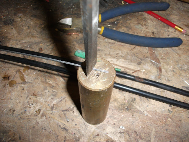

Here's a quick pictoral tutorial on how I did my cables.
Cold chisel worked the best for a sharp clean edge on the cables. I used it on the housing as well. I removed a section of the plastic  outer wrap on the housing then at split in the metal, that's where I put the chisel. No pic of that sorry.

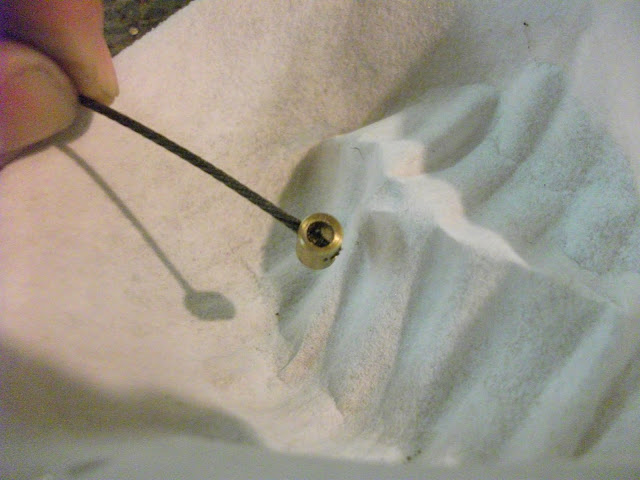

A view through the end. I pushed an awl to spread the wire open so the solder will flow through everything.

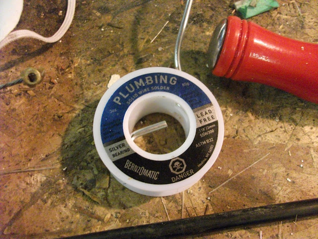

Fluxed the hell out of it.
The solder I used. Bought from Canadian Tire
The finished ends. The larger end is actually brass wire wound around the smooth end of a drill bit that gave me the correct diameter that was needed. A little filling and tada instant cable end.

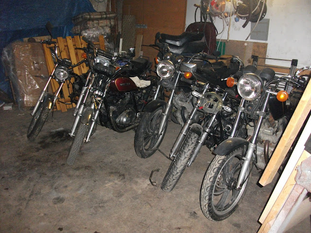

Is that a Suzuki GS425/450 I see inside your row of bikes?

Yep. The row from left to right, 82' sr250, '83 gs450l, '83 xs400 maxim, '79 cb650,  '83 xs400 maxim. Not shown '83 cb650c and another sr250.
