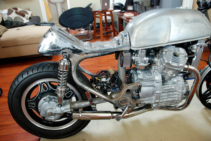

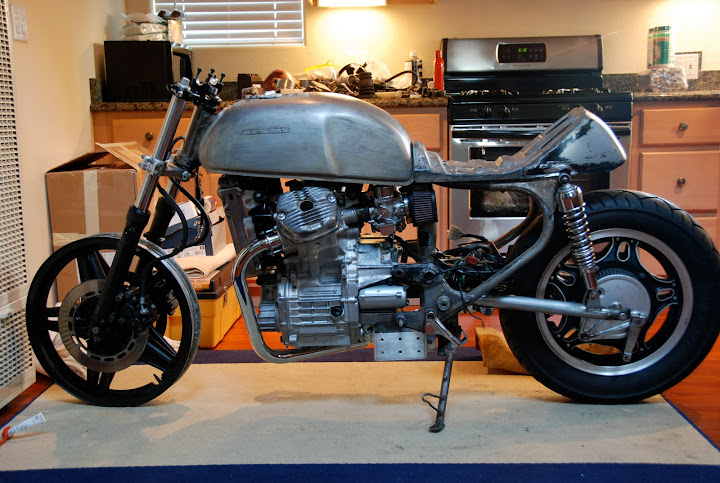

oh how i envy those with garages/workshops/etc etc.  here she is in her new (temporary) home...my kitchen!
i wanted to mount everything up to see how the wiring would route throughout the bike.  and it's also been a really looooong time since she's been in one piece.  it's nice to see things fitting together  ;D
what ya think of the battery box location?  still need to trim a bit more above the shock mount so the seat fits just a bit lower.  and you can also see the nest of wiring i need to get through over the next couple weeks.
man i can't wait to hear how this exhaust sounds  ;D

HA! Cutting up your matress to finish your bike is some real dedication.
Looks great! Kinda scares me to have the battery that low seems a bit scary. Wouldnt want something smacking into it while your flying down the road.

« Reply #44 on: Apr 20, 2010, 13:51:51 »
haha...well it's actually not the actual mattress...just the memory foam pad that goes on top of the mattress.  I don't think i'll miss a couple square feet  :P
It may just be the camera angle...the battery actually tucks in nicely underneath the gearbox.  And there's a ton of clearance with the ground.
