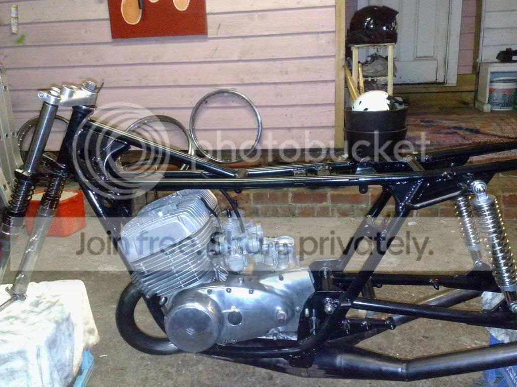

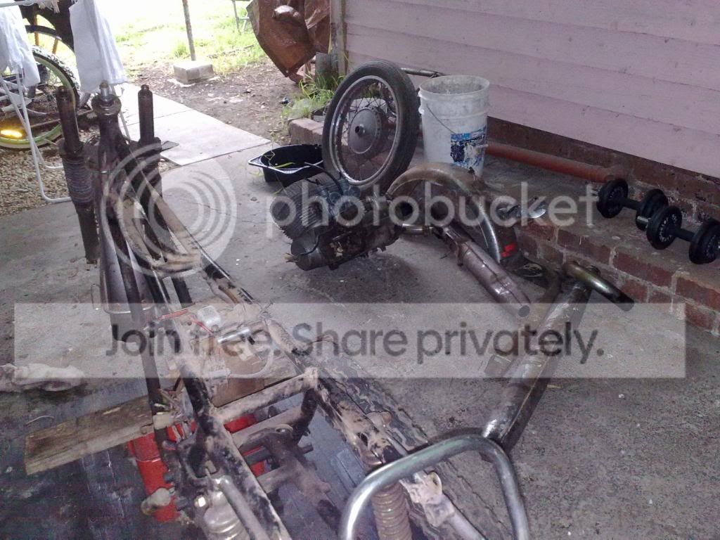

Nearly stripped
Needed new gearbox
frame going together..engine in..
new spokes and a 18 inch front rim instead of 19 inch..
sorted front guard and instrument bracket,exhaust mounted..working on gear lever and foot rest..

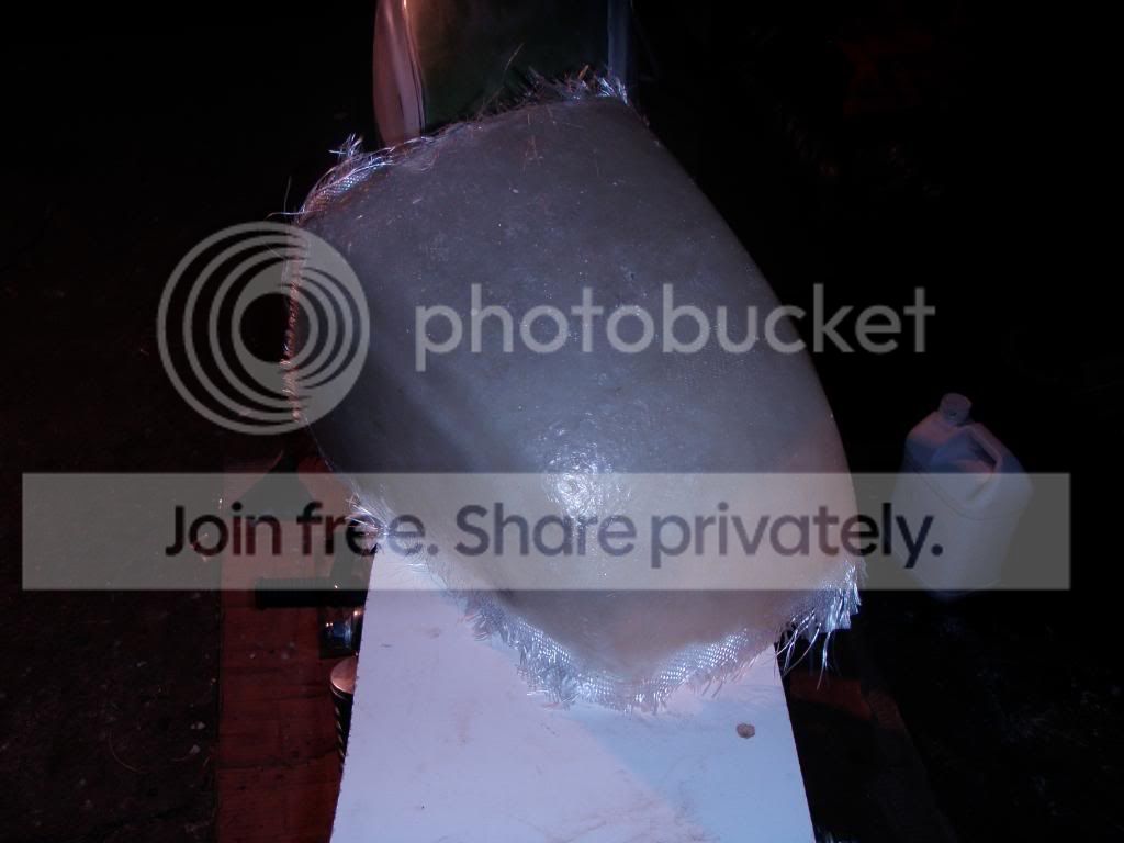

it's been awhile but got some work done..got the bushes in the levers..made sure they were a tight fit with some loctite,hope they'll stay put..needed a peg that flipped up so the kick start would clear it..used some GSX250E passenger pegs I had lying around..got a start on the seat..made a mold outta plaster a paris of back of tank..gonna fibre glass it for the seat hump..took some pics
gonna wax it up layer some PVA glue in it lay in some resin and mat it up..
That's a great idea for making a mold - using the tank.

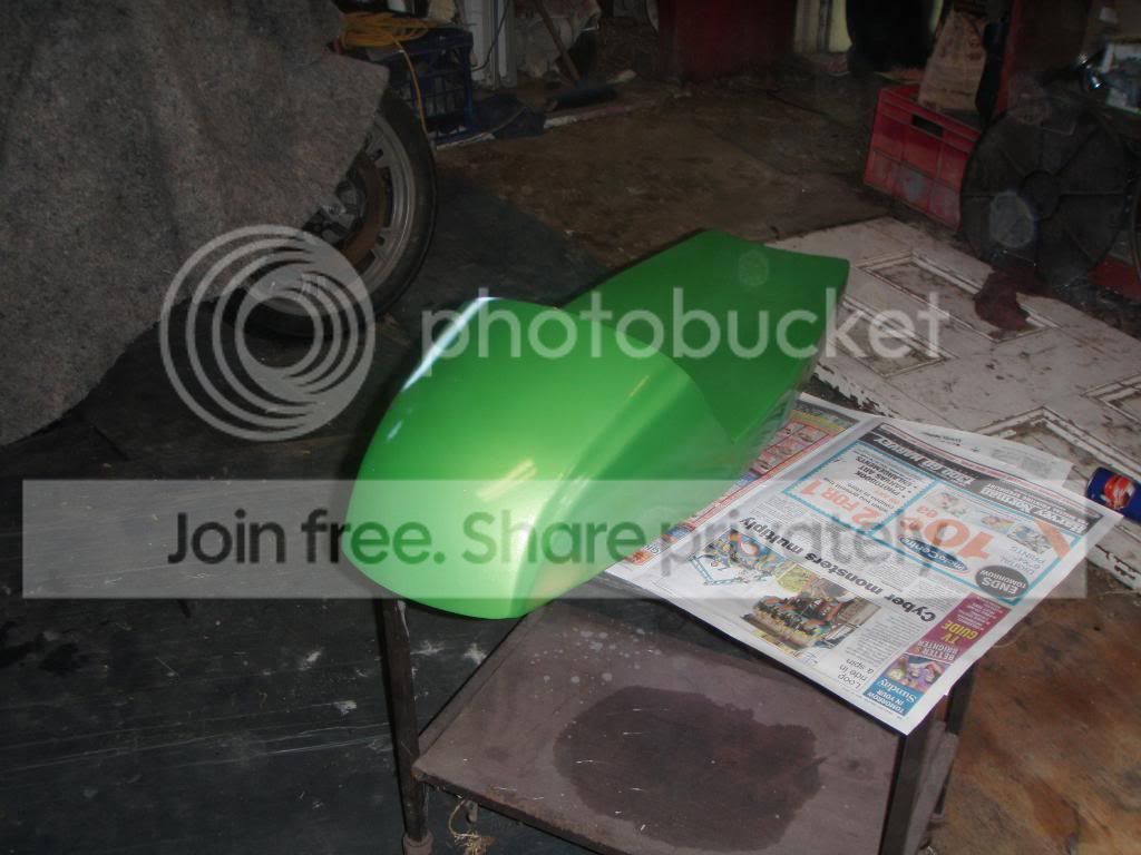

yeah I know what ya mean alpinaclone but its too far gone..heres where the seats at..
I'm thinking maybe the humps abit tall... could come down abit???
Actually, it looks pretty damned good, but I do see what you're saying . You could take 1/2 to 1" off and I think it would look just right. Very good ida for that mold man. Keep it up, I love T500s
Very cool man I like that bike I'm not real familiar with them but that frame is perfect. The seat could use to be cut down some and it would be perfect. the og paint scheme would be tits too. Keep it up.
I think it looks great! It makes me wonder if the RocCity tail I ordered for mine will look too small. Nice work on the rearsets too. Having expansion chambers sure make the shift linkage easier. The stock mufflers don't give much room.
