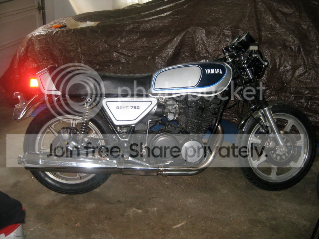

I bought a donor for my '76 Triple and it was in good enough shape that I decided to make it a cafe racer instead. I soon realize 2 bikes to work on was 1 too many for me right now. However, I got so into the idea of a cafe racer I decided to cafe out my daily rider and make the donor a donor again. I am almost done my seat, which has taken forever. Right now I am mainly going for the look and hope to start stripping weight in earnest if I can accomplish this much first. I have gotten a lot of tips on here so far, and am open to any and all suggestion.
Question, I need to cut off about 4" from the end of the frame. Just where the turn signal mounts are. I was going to remove the gas tank first, but is there anything else I need to take off for safety? Carbs?
if you're going to cut your frame with a grinder, make sure you use a cutting wheel and not just a grinding wheel. It will make the job easier, less sparks flying around.
Just cover the carbs with a towel. Besides the spars should be going sideways not towards the engine bay. make sure you dust off or blow off the bike when you're done grinding or cutting away as small metal particles will get near and or on the engine bay or part of the frame and oxidize with time and live you with rust spots all over.

Wow, thanks. I did get this bike because I love the Triumph's but am on a Japanese budget. Are you running clubman's and rearsets. I am putting on clubmans and wanted to go with rearsets mounted to the rear footpeg holes but am not sure if this is the way to go. I would love to hear what another xs rider is doing. I will save this list and shoot for some of the mods once I get a little more comfortable. This is my first project and I just wanted to get my feet wet and get it on the road. Here is my short list for what I want to get dome before riding season.
Cross Drilled Rotors (I know a guy)
New Tires
Fork Gaiters
Cafe Seat
Clubmans
Mini Stalk Signals
Bar end Mirrors
New Muffler (For looks, the old one works fine)
Some Paint
Rear-Sets
Thanks again, and I will definitely save this post. These are all great suggestions and If I have success with the more basic stuff, I definitely want to go further.

Alright, so I made a little progress. Seat is a failure. My styrofoam mold wasn't good enough, when I started sanding bondo and glass I got back down to foam in some spots. I am just going to buy one from roc city. I am playing around with exhaust options. I am just holding the pipes and trying to take the pics so they are a little wonky. I bought pipe and can run them back further. I do like the look of the short pipe but am concerned about the exhaust outlet not being behind me, fumes/heat. Anybody done the shorter pipes? Is this a concern at red-lights and stops?
Maybe like this?
I am also going to order some pod filters today if I can figure out the right size. I plan on cutting the side covers back to follow the bar on the frame to expose more open space once the pods are on. I have a spare set from the parts bike in case it doesn't work out.
