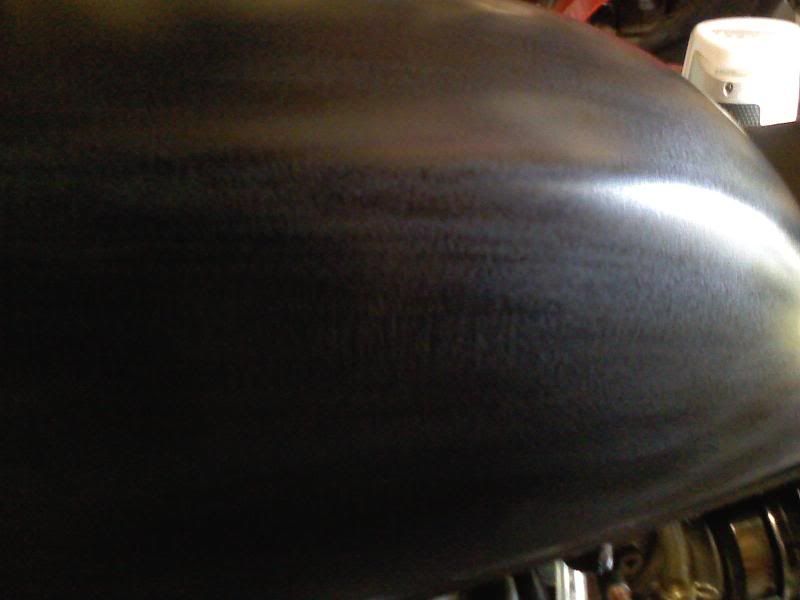

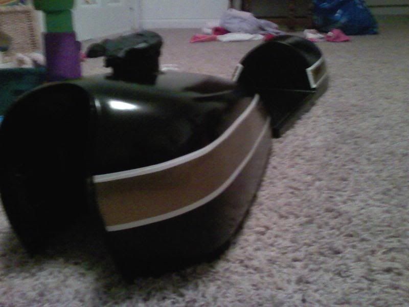

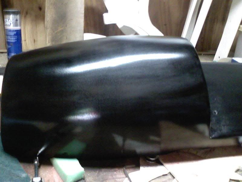

Alright, so, I just wanted to show everyone my failed attempt at a paint job. Thought I had a great base of paint, and started the wet sand process (using 1500 grit). Well, after one swipe with the paper, I knew I was in trouble. Here is my Epic Fail.
Tank:
Tail:
Here's the deal. It is riding season, and I need to ride. So, I am going to throw a couple of coats of clear on her, and ride her just like this until winter.
Oh, and here was my inspiration for the color scheme (black, gold, white).

Any clue what happened here, Brandon?

So, apparently, I am an idiot. When I shot clear over top of it...low and behold nice shiny black again. I will get pics tomorrow night.

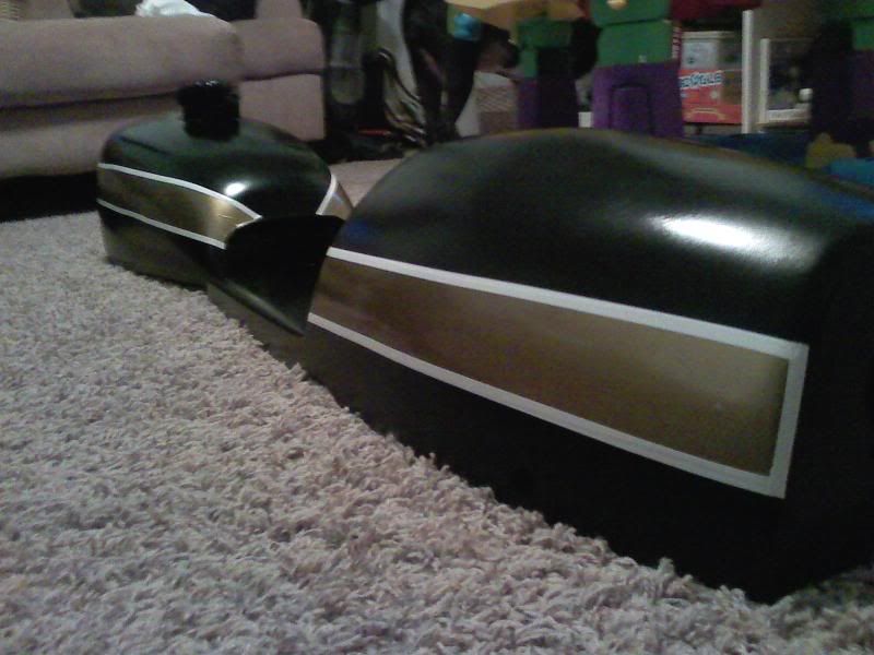

Did a little work on the tank/seat tonight.

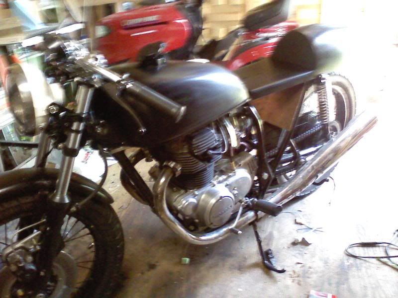

So, I wet sanded, buffed, and waxed the paint.
I then put the tins on the bike, gassed it up, and took it for a spin.
Here are some pics.
Weather permitting, she'll be at the British/European show tomorrow.

« Reply #70 on: May 23, 2010, 05:15:37 »
justin looks sick man... love the black gold white guiness theme.  I gotta say, and I am just being honest, but the seat needs more work... Your bike looks great, paint, everything, but the seat with those wrinkles looks half assed.  Sorry man not trying to be a dick, but I think that with a little heat you should be able to stretch the vinyl (I assume it is vinyl??)  Try a blow dryer on high or a hobby heat gun... even a butane torch works well if you are very (and I mean very) careful.  Just hold the torch back a bit so you dont discolor that nice white material.
Spend some time, Try tacking in one side (small area at a time, like 4 inches) then heat up the vinyl a good bit with a hair dryer. Then pull like hell directly across from where you tacked the first side. After you get it as tight as you possibly can, have a friend (or any one that is willing to help... most people will do this for beer) tack the side your holding. Do this all the way up both sides then do the front by heating the whole front of the seat, pull, and then tack.   You should be golden...

just curious, where did you put your battery?

I made a tray out of ABS plastic, so the battery is under the seat hump.
Boss Man, the seat was exactly what it looks like, half-assed. I fully intend to redo it (or have a nice one upholstered). I have a lot more of the vinyl, so maybenover the next week or so, I will give it another go.

I took "darling" out for a spirited ride last night. I think I need to re-jet. I have a flat spot at around 5500 RPM. She gets all hesitant. However, I did get up to around 75mph or so, and she was still very smooth and had more to give.
However,  Loc-tite is a necessity. Somewhere during the ride I lost three hex-cap screws, 5 nuts, a handful of washers, and my key ignition worked its way loose. Luckily (and I mean extremely lucky) nothing fell off, considering the rear mudguard lost 2 of the four bolts, and both of the remaining two bolts were missing the nuts. Having that sheet of metal getting caught up in the chain/rear tire would not have been pleasant.
