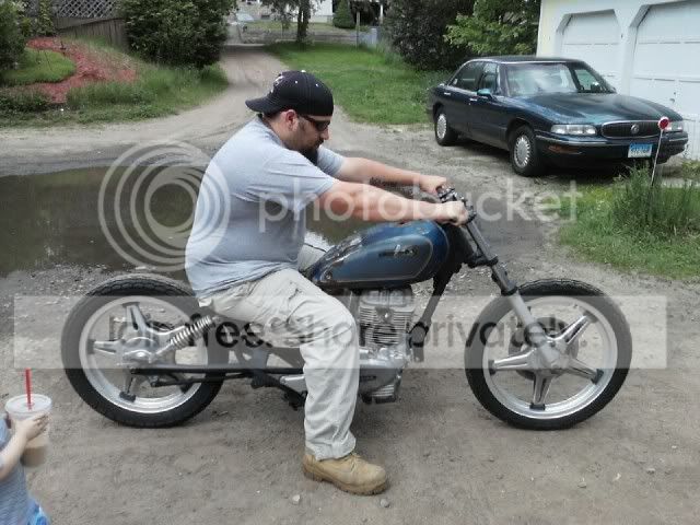

Here is a current pic of it taken yesturday. I cleaned it and painted the frame, wah up the wheel's and fork's.
Cut down the kickstand aswell.
I have a shorter set of fork's of the CB hat i got the rim's off of, I plan on useing the motor from that bike aswell because I want
it to have a kick start. And the motor only has about 5000mi. on it

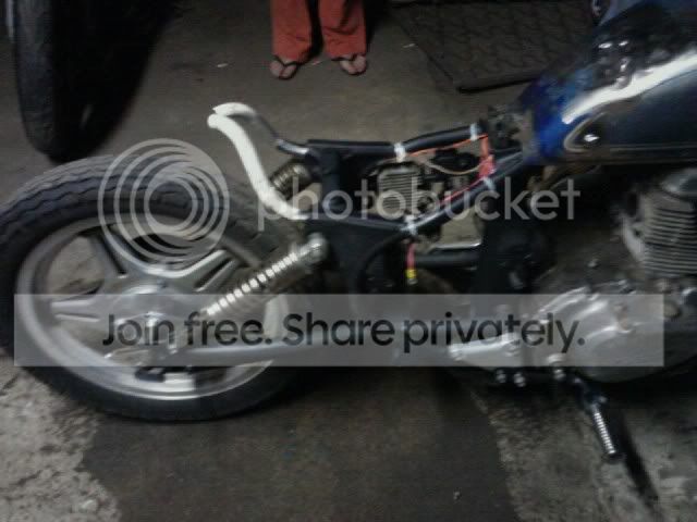

I have not noticed any flex/problem's so far. I did some more work on it this past few day's here are some current pic's.. Trying out different bar's, dont know if I want to run ape's or drag bar's... I welded up what I like to call my ass protector. I have alot more welding/bracing to do this weekend,have to finish up the swingarm. I'm the fat guy!!! ;D Oh yeah I also swapped out the cm450 fork's for the cb400 fork's there's like a 4" or 5" difference in front end drop.
I like the springs in back, Hardtails are cool but I'm diggin the use of springs. Hopefully accomedates for a better ride.
Are those the stock springs you used? just fabbed mounts on the trimmed frame?
Looking good! I prefer the drag bars, that's what I'm going with on my CM400, but I've thought of apes as well. If you go Apes, I'd personally go with something a bit higher than what you've got there.
If I stay with the ape's they will defenently will be higher, those are just what I had laying around. Thank's for the positive comment's. I'm also building 2 of them so one will have drag bar's and the other will have ape's.
