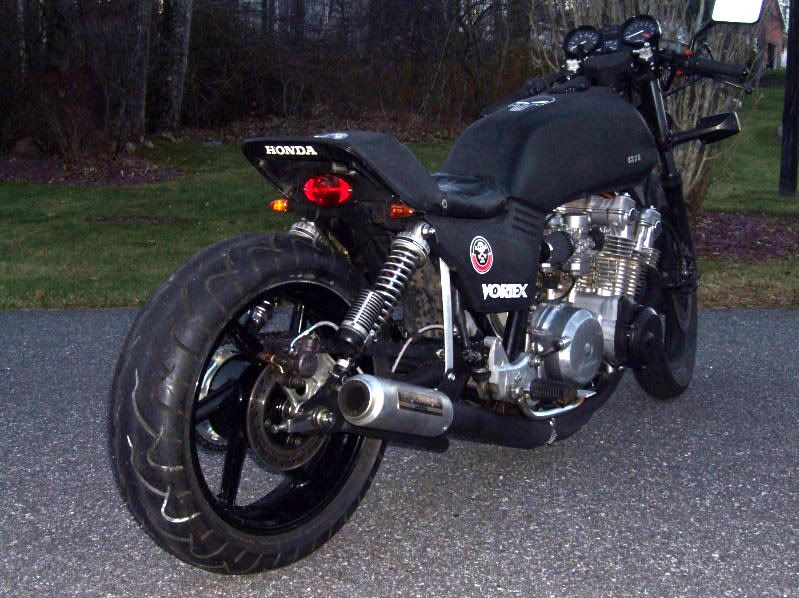

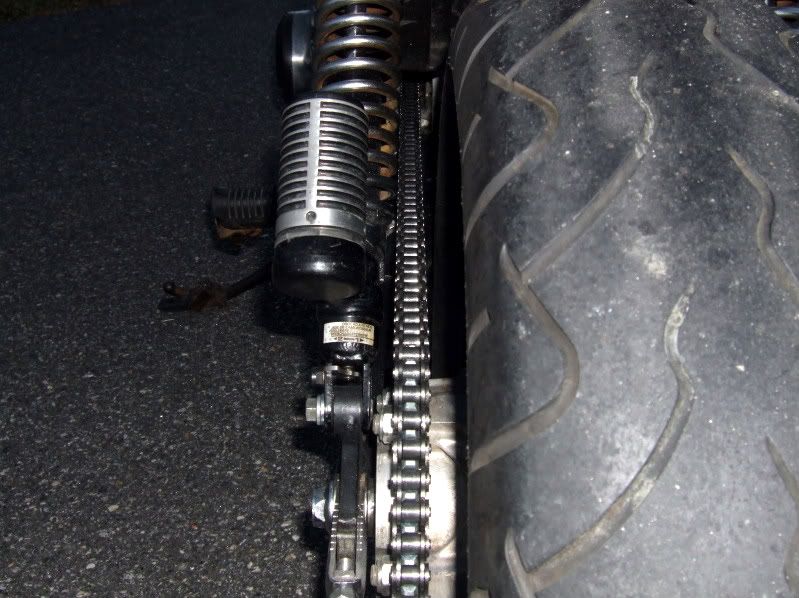

Ok, update time. Landed a CBR 600F2 rear wheel, tire, caliper, caliper arm, axle and spacers. The whole thing bolted up with no special spacers or mods. I did lose a ton of ride hieght because the wheel is one inch shorter that the stock one and I could not use the shock extenders as there was NO clearance by the rear sprocket hub bolts and the lower shock mount. I will have to move the lower shock mounts farther up the swingarm to get my hieght back. Should be a pretty easy fix. Now have to turn attention toward front end.
New 170 vs old 130
On bike
tight squeeze for hub bolts and shock lower mount. but tire is centered and chain is straight
ride hieght is way too low
Will shoot for this hieght by moving shock mount forward on swingarm
Only have to move it forward a few inches

looks sharp! is it longer than stock?

The swingarm was extended 4" on the front end side and braced. I also trimmed the rear of the frame off. The cut frame and extended swingarm toether make it look longer than it really is.

Moved my shock mounts forward on the swinger. Got my shocks back into the proper geometry and got my ride hieght back.
