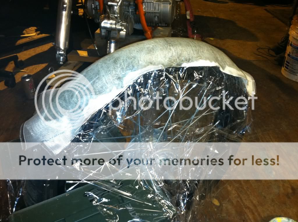

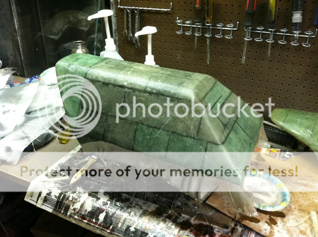

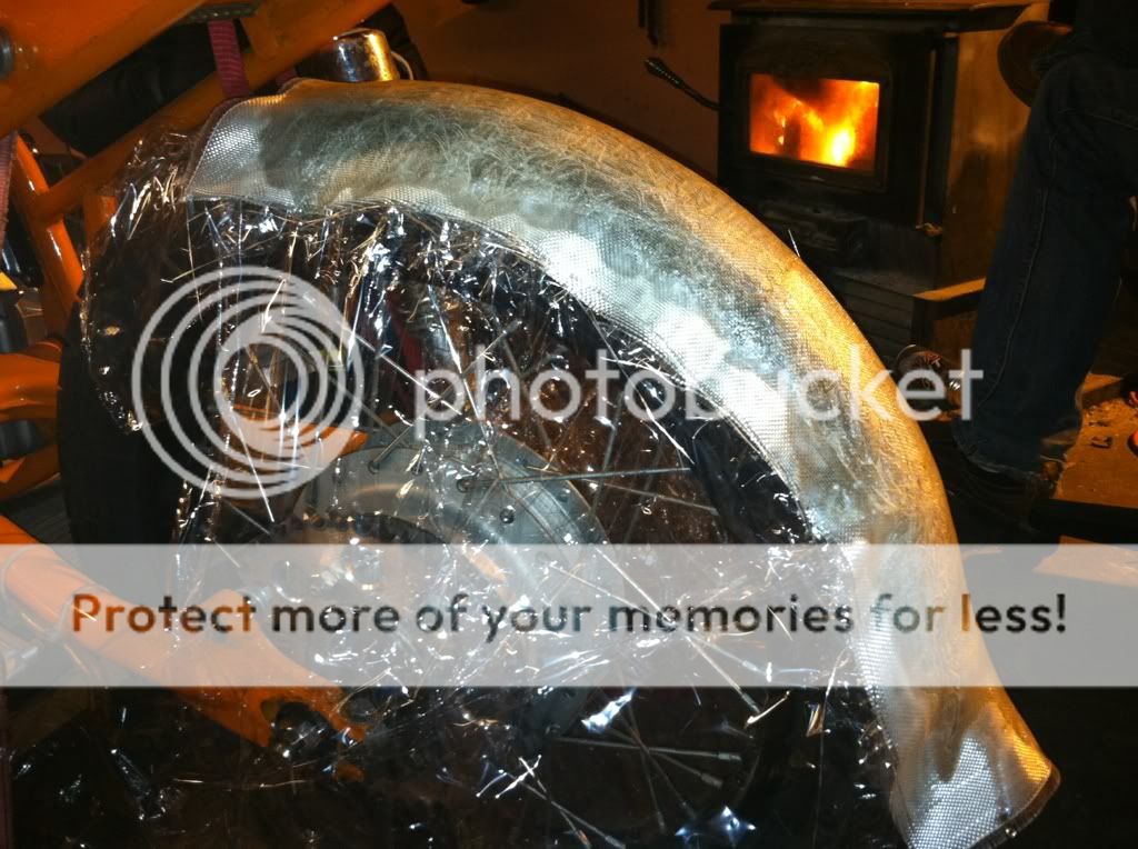

Some slow progress lately.  Building the fender and belly pan plugs has been kicking my ass.  It's such a time-consuming process.  I seem to have blocked out just how labor intensive composite work is.  Last winter I remember it being much quicker.
Here's the belly pan plug.  It will be trimmed, smoothed out, and painted.  Then waxed, PVA'd, and a female mold created from it.  From the female, a carbon fiber part will be made.  Long road ahead...
Here are the beginnings of the front and rear fender plugs.  The end products will be created the same way as the belly pan.  The front fender will mount directly to the Tarozzi fork brace, and will be custom molded to the brace.  The rear will incorporate (hopefully) a chain guard as well.  Not much to look at yet...
