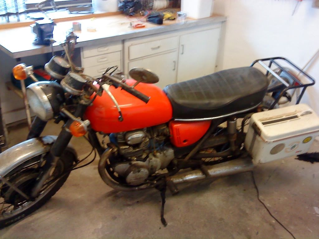

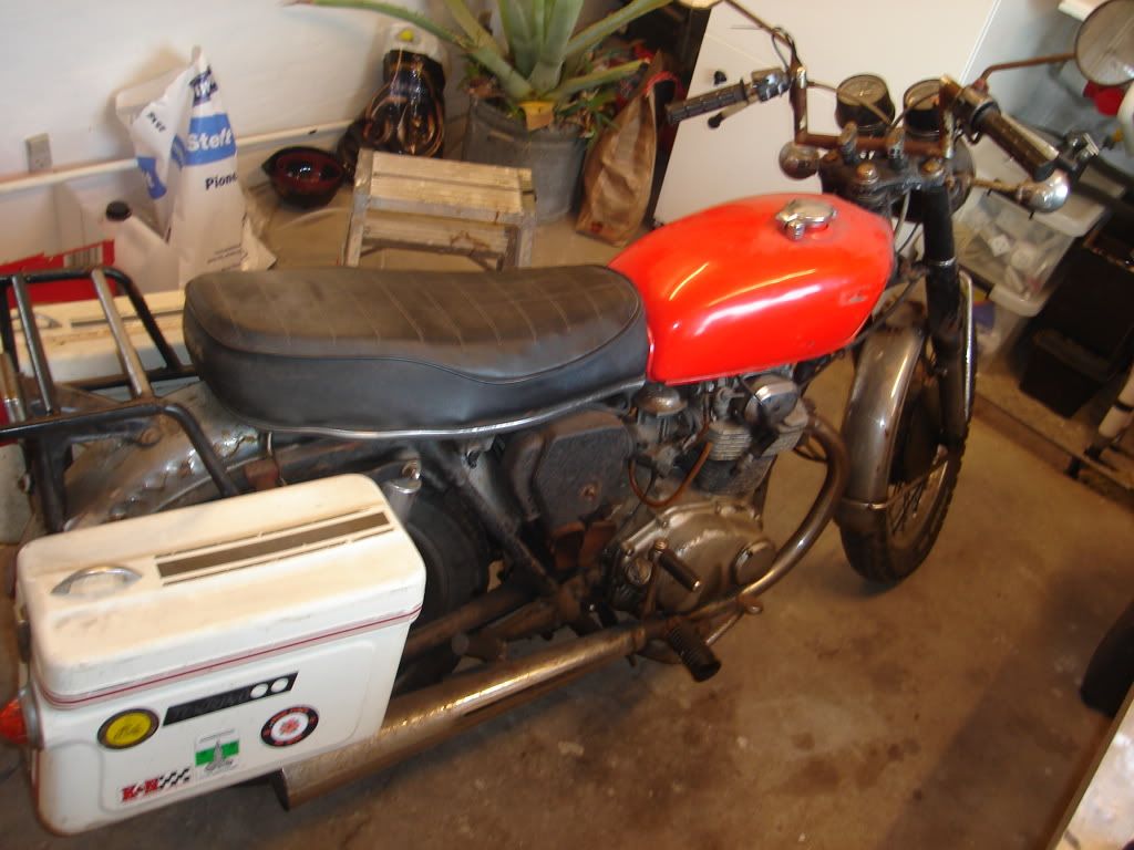

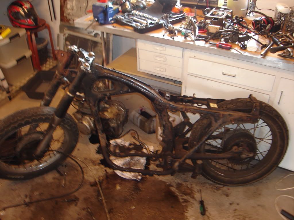

Here's what it looked like when i picked it up:

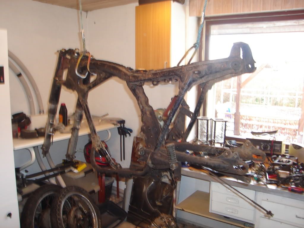

During teardown:

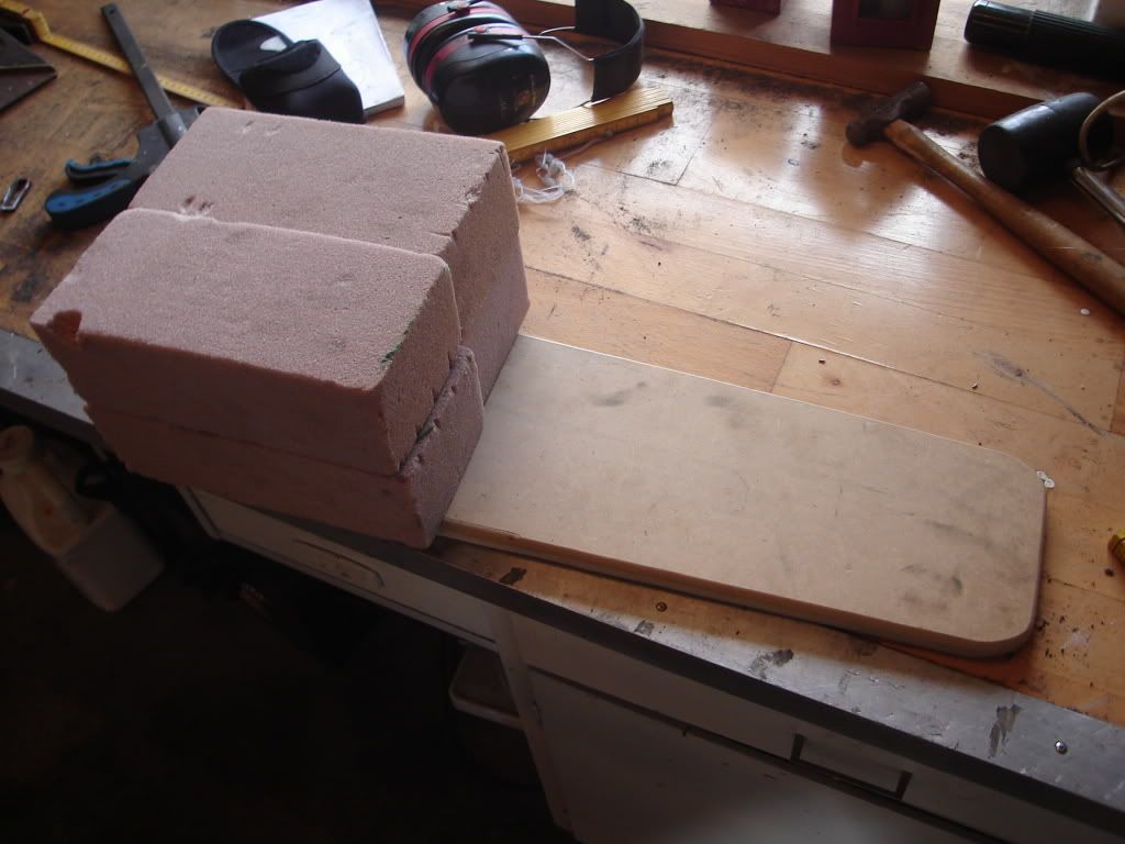

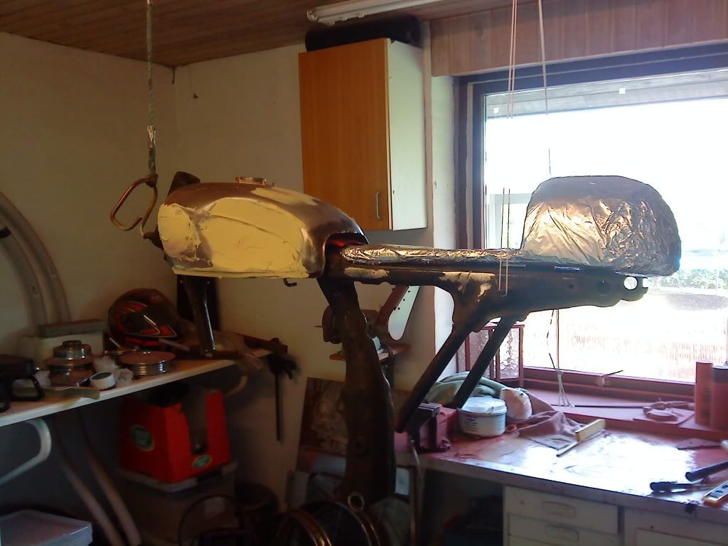

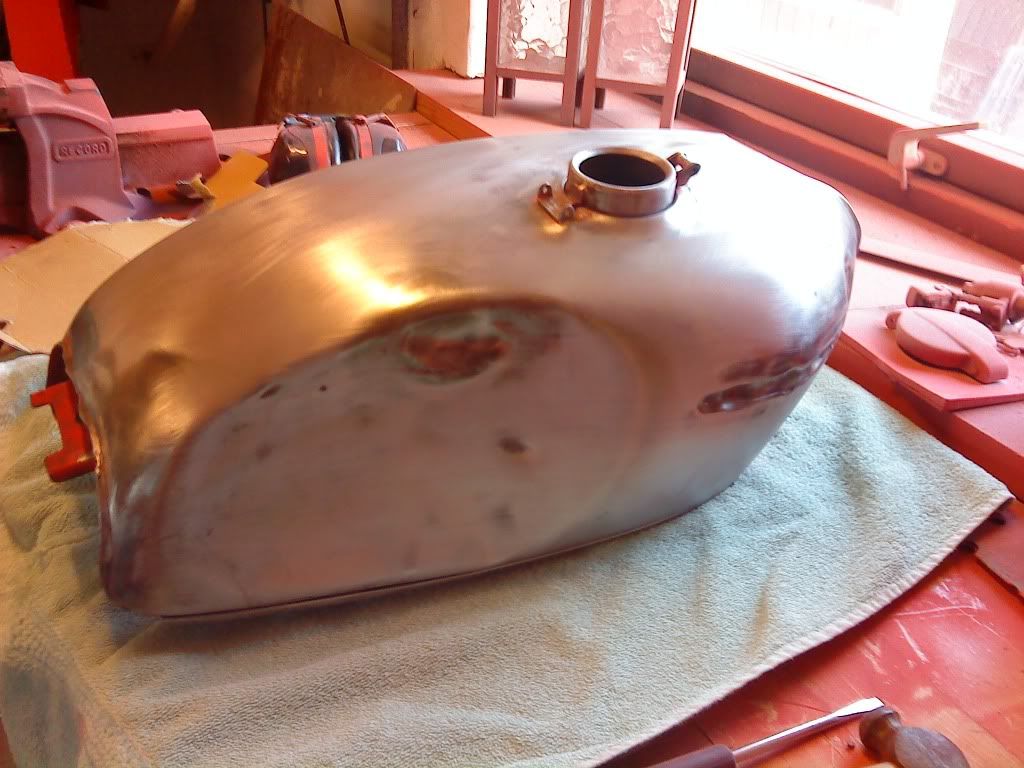

Cafe racer seat making:
First mockup, lower part of frame is cut  because of extensive rust. Hopefully I can make a new lower part or repair it. If not i'll get a new frame or possible a donor bike.

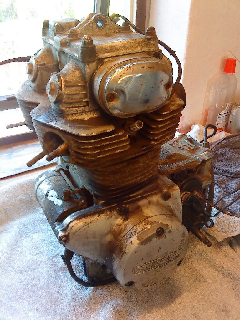

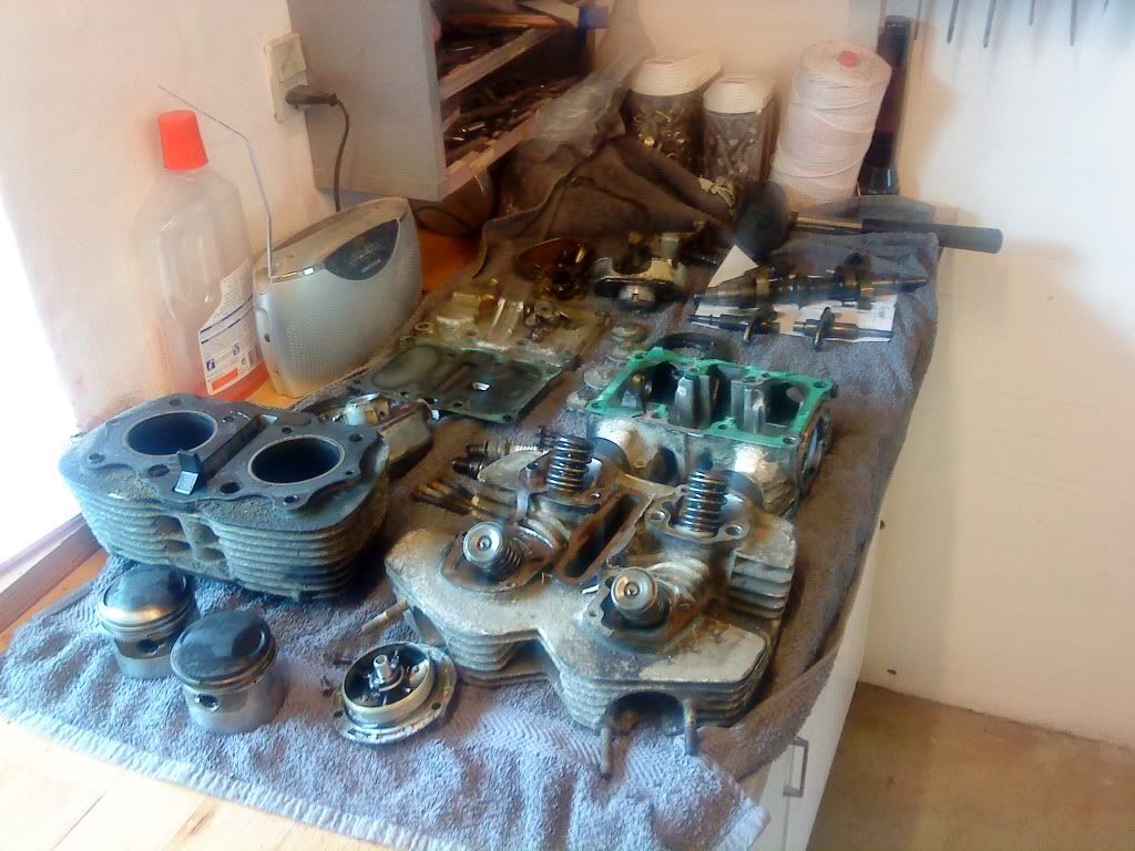

Engine before rebuild:
Top end apart:

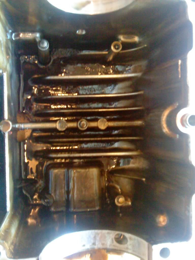

Lower part:

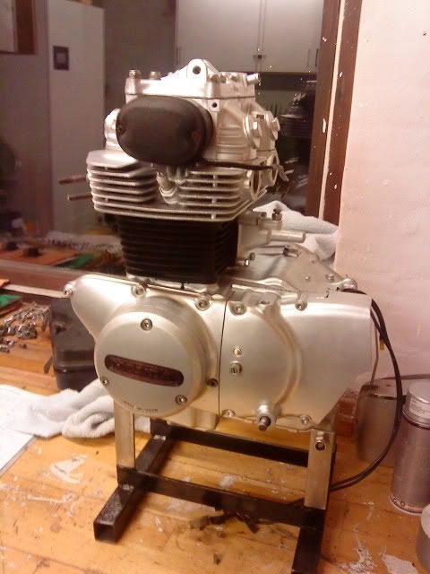

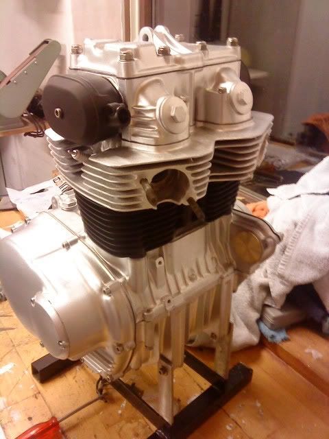

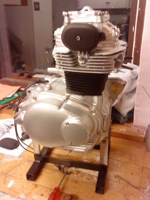

Engine work included:
All new gaskets
All new oil seals
New pistonrings
New valveguides
New camchain and roller.
Lapped valves
Starter plugg off
All old screws is now stainless steel allen heads.
Polished intake and exhaust ports
Camshaft, rockerarms, rockerguides, camhousing, oilpump from donor engine with low miles.
All parts painted and put back together.

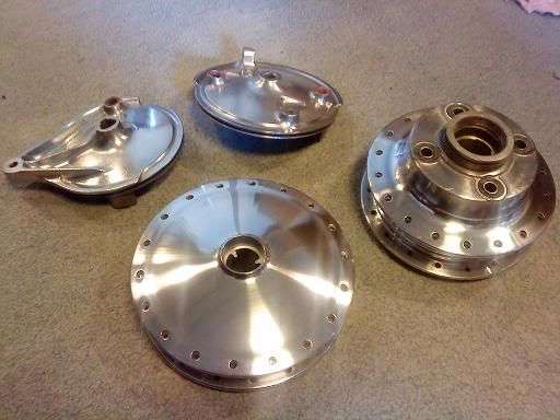

Polished hubs and brake plates:

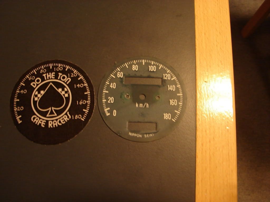

My try at speedo background redo:

Shit man, was the frame really rusty enough to justify chopping it in half?

As far as the frame goes, yes it was pretty bad. Had several cracks, and the tubing was nearly impossible to weld on, due to lack of thickness. The bikes has been used by p.o. all year round and snow, rain salt etc, has left its marks. If everything failes I'll get another frame.
