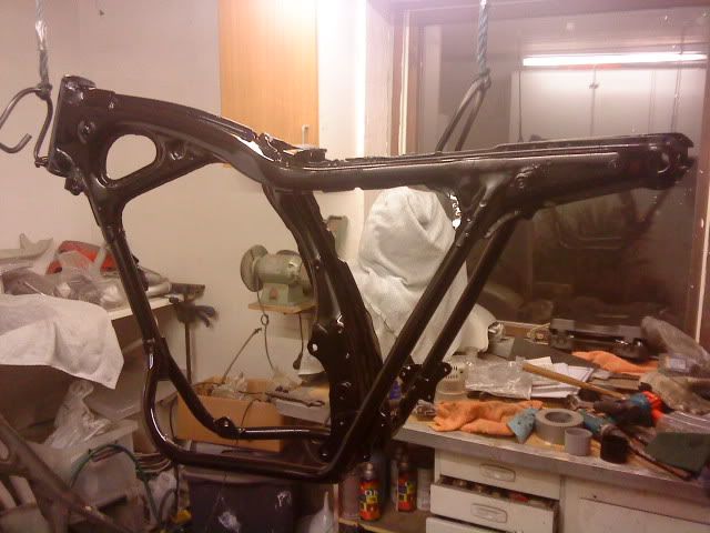

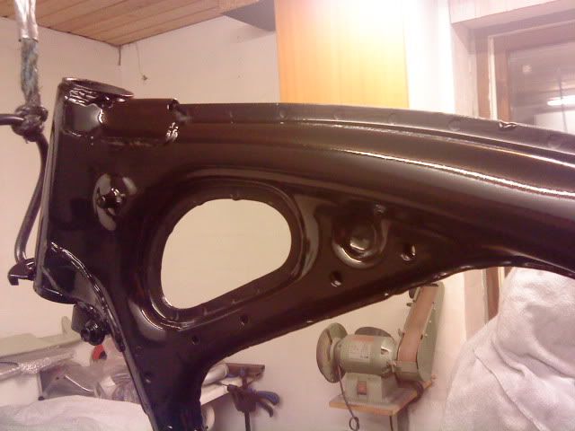

So, decided to skip sunday church and lay some black paint instead:
I'm very pleased with the result, considering it's a spray can job.
Next on my project is to clean up my workshop, start assembly and take some better pictures.
Also i need to organize rest off the build and figure out what i need to finish my projekt.
The Lord understandeth......
