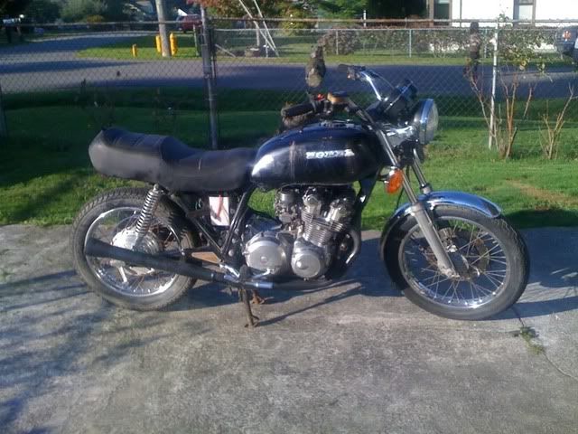

Here's the pics from the back of my PU.

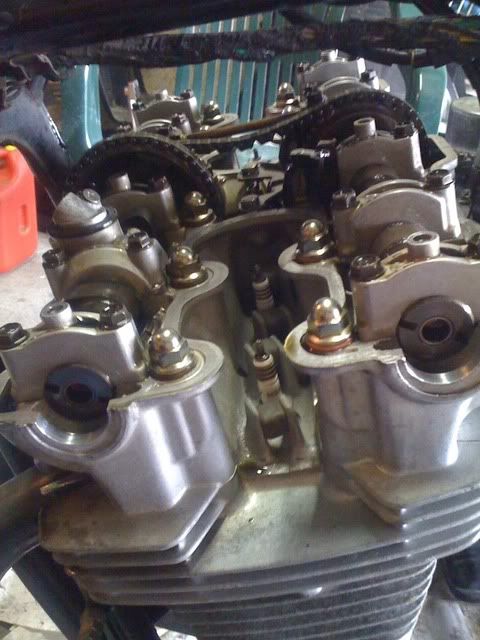

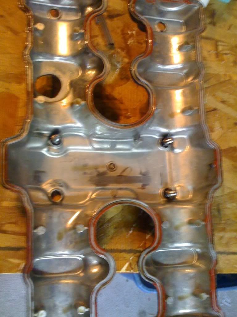

Pulled the valve cover to find this...sorry the pic sucks but you can see where the cam chain has been slapping on the cover.

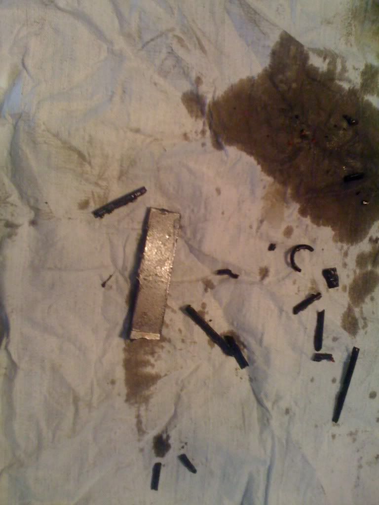

 This is whats left of the cam guide. I found it in the pan.

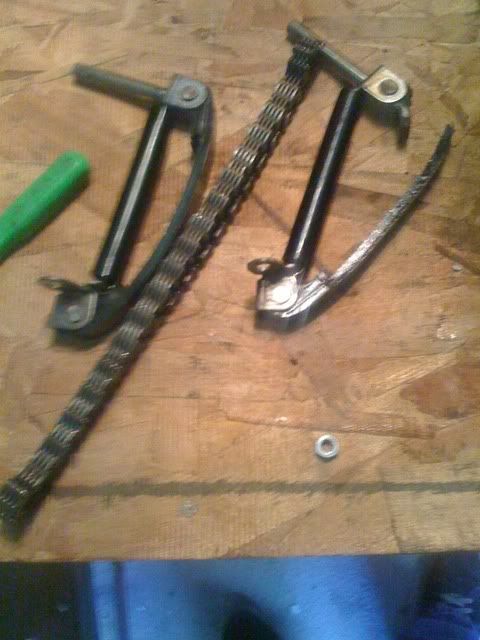

Got a new/old cam chain guide of ebay and installed.
Found the root cause of the failure. The tensioner broke.

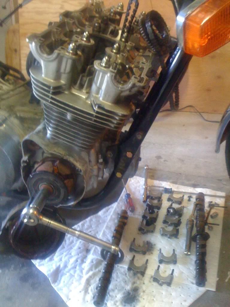

Pulled the engine last weekend. Hell of a heavy damn thing. Did it alone which was all the more fun. Gave it a jerk and clean and got it up on the bench. Christ all mighty!!
self protrait. HA!
So DOHC guy's. if you pull your engine and did not take the alt off first you can use you rear axle as a puller bolt. If you've taken the top end apart and have trouble holding the crank. Take two long half inch bolts' 4-5", cut the heads off and make them into studs. Put them into the wrist pin holes of the #'s 1 and 4 rods so the threads stick outside of the case. Bring the crank around nice and easy until the studs are flush to the case and tighten up the puller bolt. Keep the threaded end of the studs OFF the case as this will make grooves in the gasket surface. BE REALLY NICE TO THE SMALL END OF THE RODS! Tighten puller and smack it with a hammer it "should" come off mine did nicey nice like.
So hear it is as of about wed. night.
Gotta clean cases, hone and re-ring, and reseal it all.
