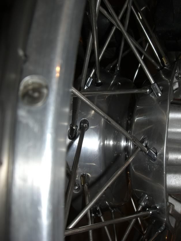

Front Wheel:
RIM - BMW GS?R? 2.5x17" , already polished,www.ebay.de
HUB - Moto-Guzzi , model unknown, www.rebootguzzispares.com
SPOKES - Stainless steel, I bought the guzzi hub and beemer rim not knowing if they were compatible, which they weren't. The spoke  pattern lined up with the rim but the entry angle was about 5 deg. off. So the good guys at www.symotic.com bent the spokes on the rim end and the wheel actually came out quite nice. I'm still not quite happy with the shine level so I'll take them apart this weekend, polish the spokes, hub and rim and put them back together. I also need to build a nipple wrench.  :-X With all the work involved lacing the rim they even came at a reasonable price. (150)

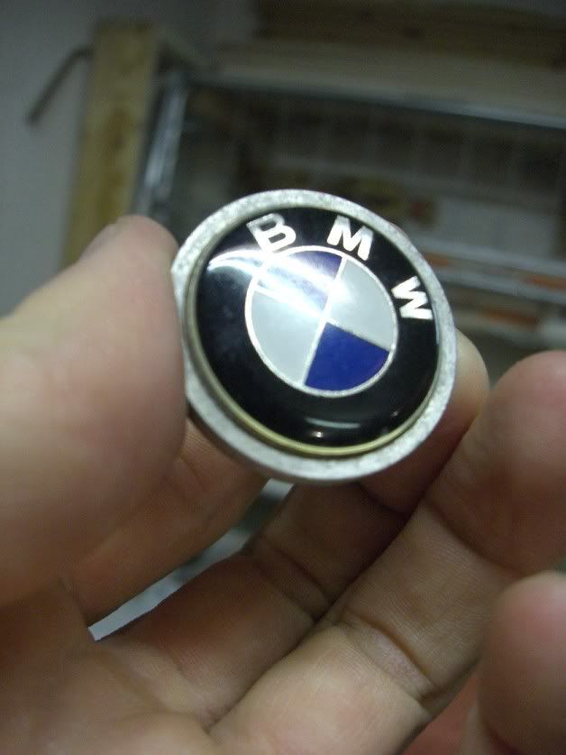

If someone want's this, I'm be willing to send it for the shipping costs. (It's the rear wheel center cap, dia. 1")

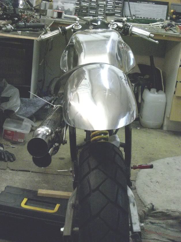

The Status Quo. Still a long way to go, but plenty behind me. I guess I'm about 2-3 weeks behind schedule.
I just put everything together for the pic so the headlight is going to come down lower, the rear might come up and inch or two. Front brake discs are coming(2 X 320mm 8) ) as soon as I find new 6-pot calibers, I have the front fender coming in next weekend, A friend is making an aluminium hugger for the rear etc etc.....

HOLY CRAP!  Love the wheels.  I'd be happy to take the BMW emblem off your hands - I'll find a spot on my R75/6 for it.  I'll PM you my details and let me know how to send you some $ for it.
Fantastic project!

I love that tankkkk and seat/cowl. Chrome or Polished stuff or whatever that is looks soooo damned cool!!! I'm sooo badly waiting for my next bikeeee >:(

Looks so much better with the rear shocks out of the way, excellent choice on the mono shock.
I am glad I did it as well .  ;D
Me too, its quite a setup! I really like this thread, only wish it was updated more frequently  ;D ;D
