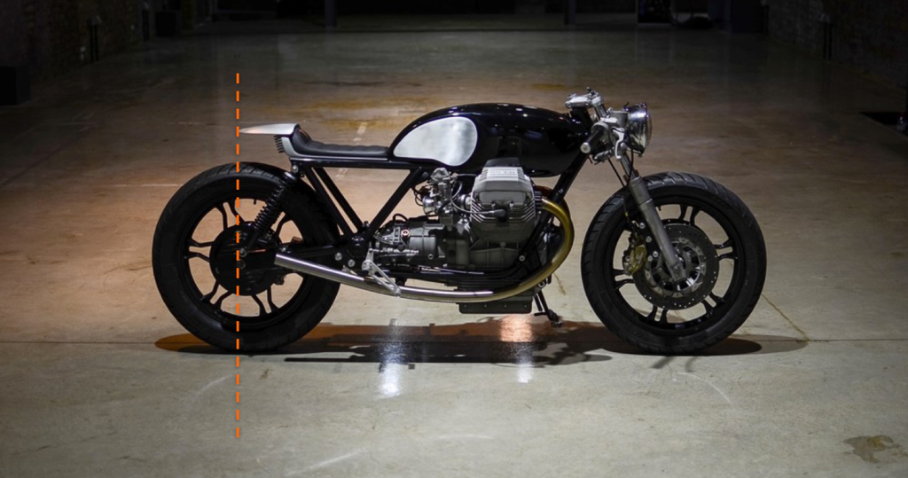

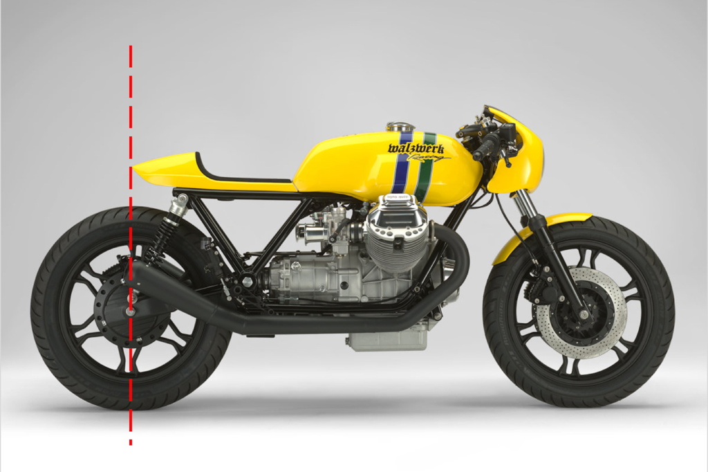

In terms of the fundamental principals governing the ascetics I now hope to achieve, it is my believe that to achieve a visual sense of balance in the design of a cafe racer, the end of the rear seat and any cowl needs to end before the centerline of the rear wheel.

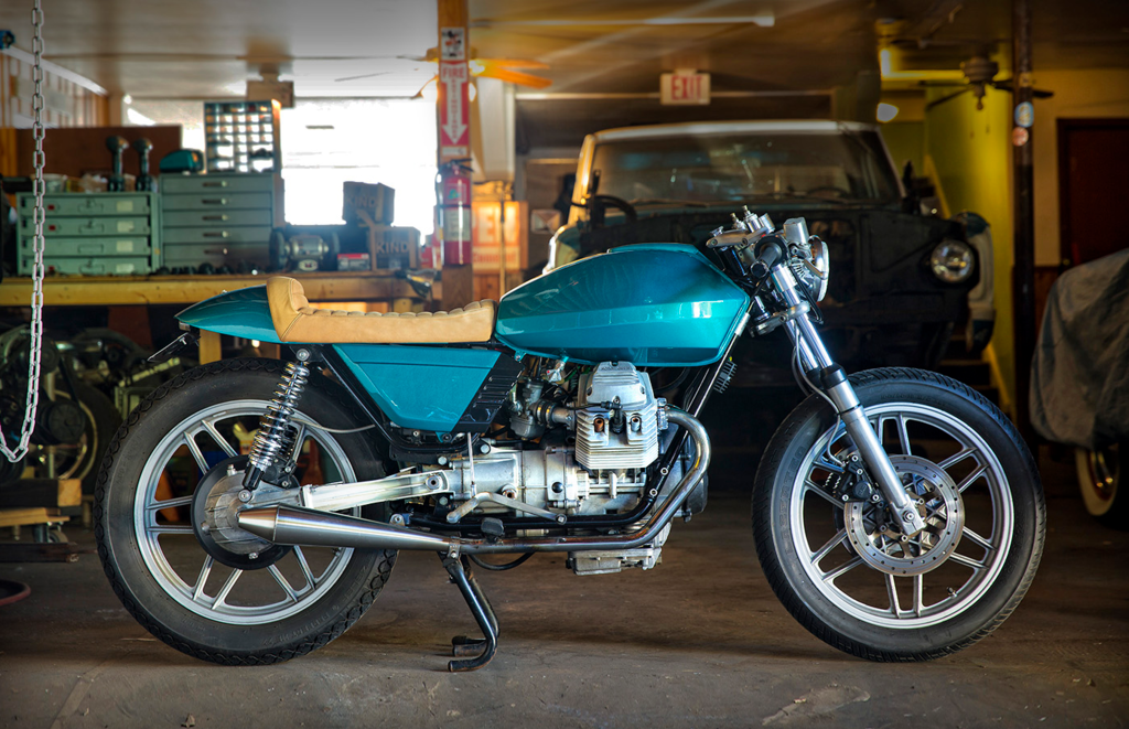

For example, Marcus Walz of Walswerk understands this, and the Guzzi produced by his shop is a shining example of this and most all else holy:
From here: http://www.bikeexif.com/marcus-walz

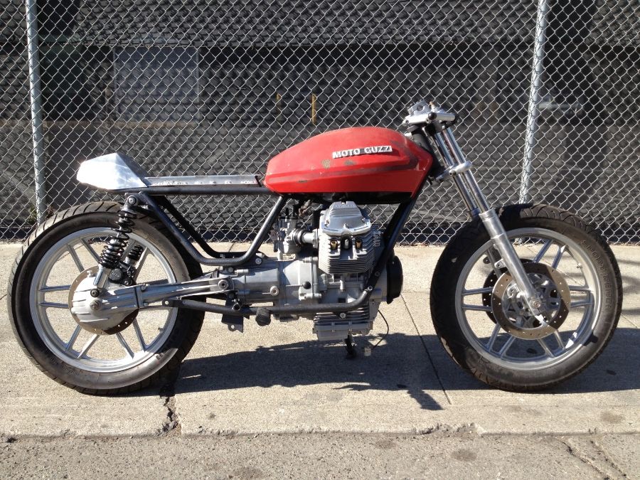

Conversly, Axel Budde of Kaffeemaschine demonstrates time and again that he does not.  Viz:
From here:http://www.bikeexif.com/tag/kaffeemaschine
Further, I don't know how you leave those stock tabs in place at the back end of the frame and still call yourself a pro shop.

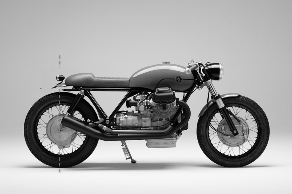

The guys over at Autofabrica, who do hands down amongst the best work I have seen, really drive home the point nicely with this "sex machine":
Ugh. So good. From here:https://www.autofabrica.com/type-9

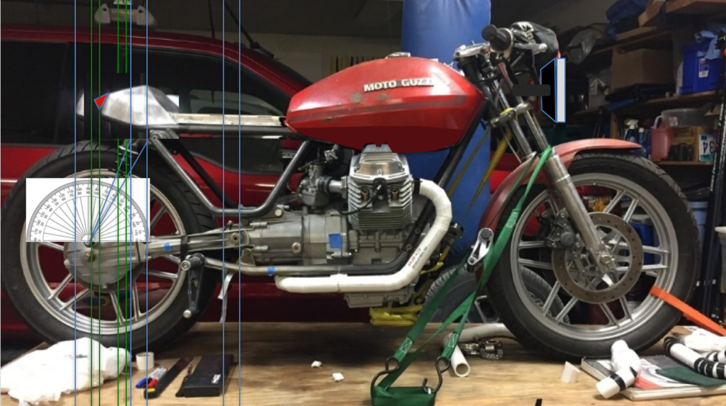

Here is a true measure, perhaps even optimistic given the vantage point of the camera, of where the critical meridian lies in relation to the design I have constructed:
Errr...fail...

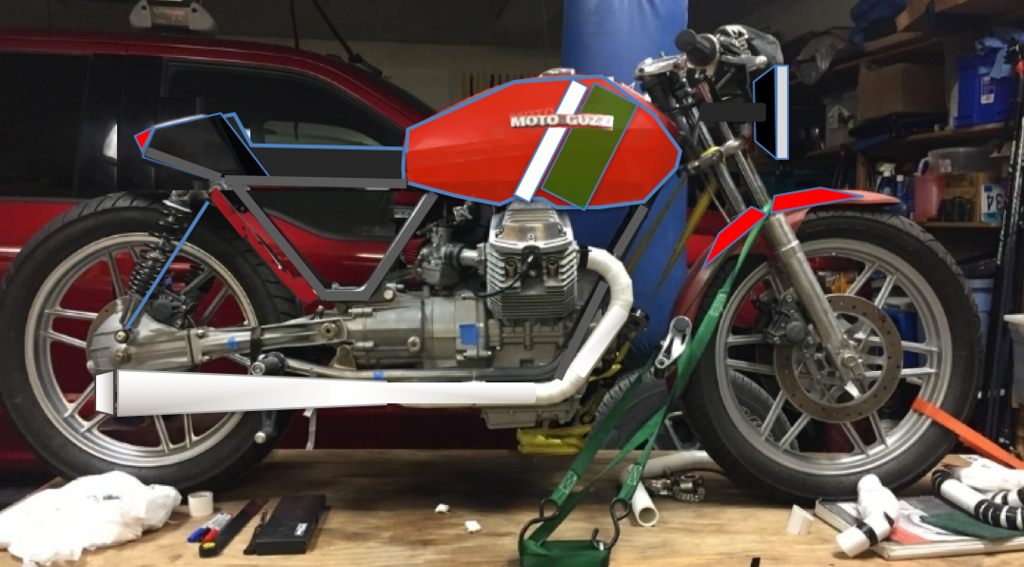

With this in mind, I fired up my copy of MS Office, and set about exploring what the project would look like if I corrected this.  I certainly could have had a better photo for conducting all of this, but I am 1500 mi away from the project, so I had to work with what I had.

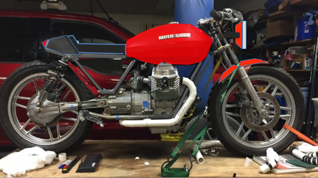

For step one I doubled checked to see if simply adding the headlight on could save the balance, and it it helps, but it doesn't save truly save the day:

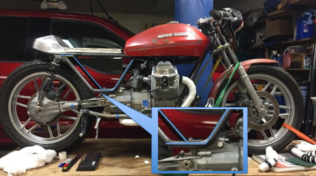

Accepting this, I began exploring what shorting the rear subframe, although it is really not a subframe, would look like.  There are brackets that attach the the transmission that I had previously shortened, and with these shortened, it leaves a section of pointless hanging frame rail, which has long bothered me.  This exercise provided the perfect opportunity to imagine what the bike would look like if I cut all that out.  So, I explore that here:
Personally I thought that this actually brought about the effect we previously observed with the KaffeMaschines bike, so I worked with it further.
An exact dimensional check is achieved with the following, and I included a specific eye to the impact on the rear suspension (will result in a ~3-5 CM drop on the rear end using the stock shocks):

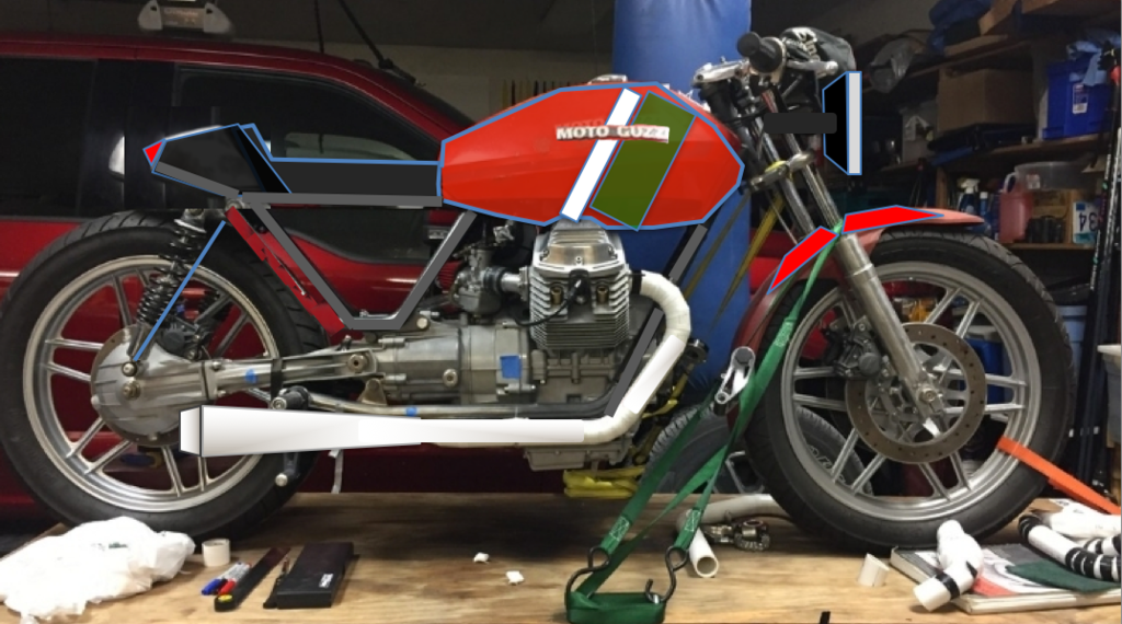

All seemed to be going well, so I toyed with paint.  Here is a Dale inspire version:
In my humble opinion, not bad and certainly better.

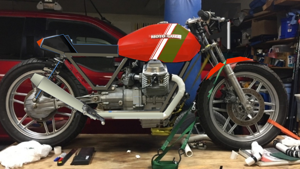

Up next was exhaust concepts.
There was the "keep it stock" solution:
And the "keep it a shortened version of stock" solution:
Both a little lack luster in my own opinion.
I really like the look of the mistral-style exhausts (http://www.mgcycle.com/index.php?main_page=product_info&cPath=26_105&products_id=2577) such as those used on the Walz Werk bike, so I sampled one of those:
Hazza. And this really pleases my eye.
So, after two years of dreaming of designs for the project that is painfully far away, this design, I think, is really pretty sweet.  And, this is the direction I would like the project to head in when it is time to pick back up.  Actually pulling this off will require me to go much further with fabrication matters than I have gone to date, but I am up for at least trying.
At the moment my idea is to finish a version 1.0 of the current setup and begin tinkering with how it rides while I work on fabricating v2.0.  The latter intended to capture the above design.  Towards these ends, I picked up a second frame for ~$25 on ebay, and it can be the basis of the shortened version.  It is a bit tweaked too (hence the price), so I won't feel to bad having at it.
I am also planning to produce the slash-tip exhaust system that exits just behind the rear sets first because I think there is something to it that is not showing up in power point.  I also think it will be really fun to build.

Also, I am aware that the floating cans and rear sets in the final design pic are physically impossible.  I haven't figured out how to address that yet.

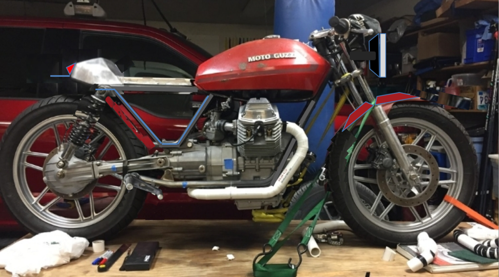

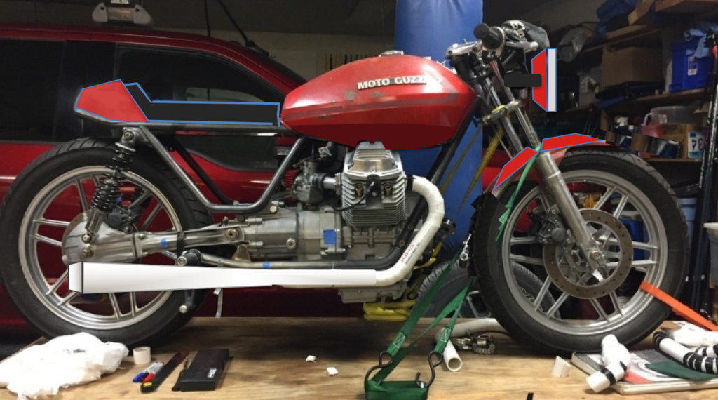

So, in the past few months I made it back to where the project resides at present.  Managed to get a better shot for playing around with designs.
For the fun of it, here is a concept that expands upon prior designs:
I think I finally got the concept of the shorty slash-tip exhaust looking as good in the mock ups as it does in the pvc model I built.
I also spent a bit of time goofing around frame concepts.  Need to graft those ideas onto this new stock photo.
