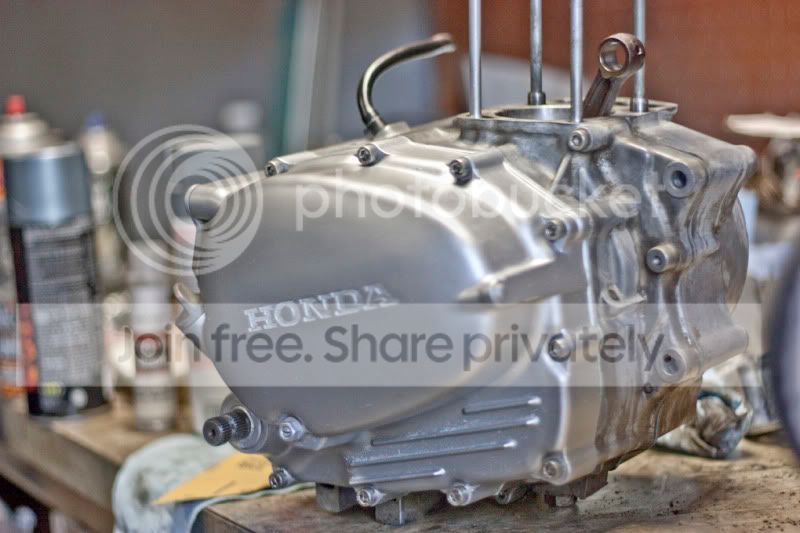

Kick start shaft spring was broken. To replace the $3 part requires a full teardown so it got new piston rings camchain bla bla bla.
Clean motor

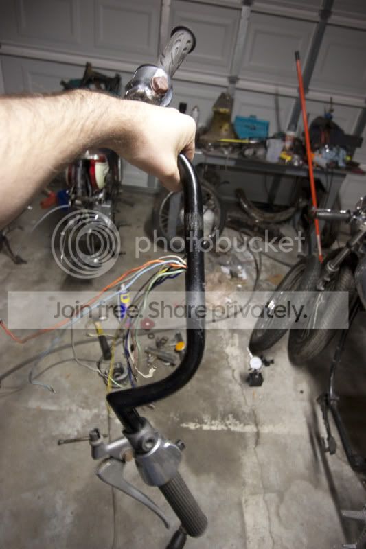

Pull wires through clubmans, yes clubmans. It is nearly impossible but i did it.
