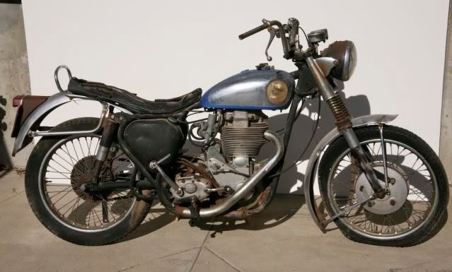

1962 BSA DBD34 Gold Star Restoration
Someday…How many times have you told yourself “Someday, I will find the bike I have always wanted?" Well for me, “someday” finally arrived and I feel like the luckiest bastard in the world. After 10 years of patience, perseverance and pure luck, I found a barn fresh 1962 DBD34 Gold Star that I could afford. My goal is to restore her from the crank up to full UK clubman specs and then will ride the hell out of her this spring.
My bike arrived from Texas and I am the one who found it in the first few minutes it was listed on Craigslist and snapped it up. I feel like a I won the f%#@ng lottery…

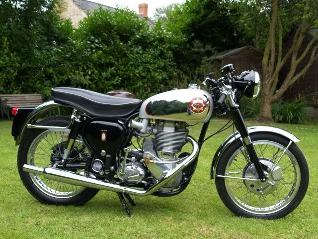

Original US Clubman Specification
My goal is to bring it to UK Clubman specs like this bike.

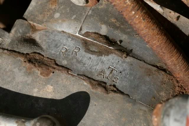

Then I asked “Now could you read the numbers and letters atop the gearbox on the right side?”
Brad wiped off the dust and dirt and said “ RRaT2”
Hmm, Is this the legendary close ratio RRT2 gearbox or not? Maybe, but I still own a standard box in great shape I could use…

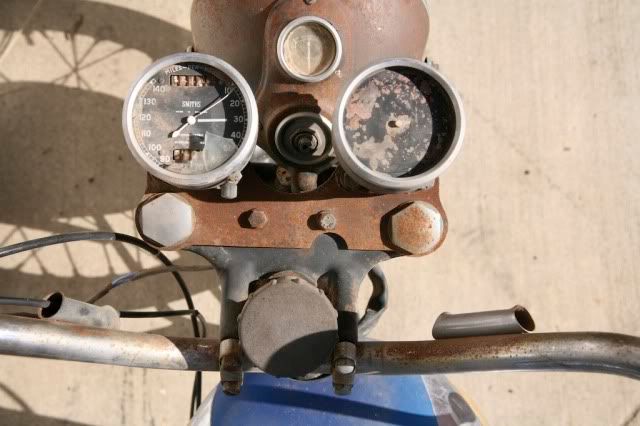

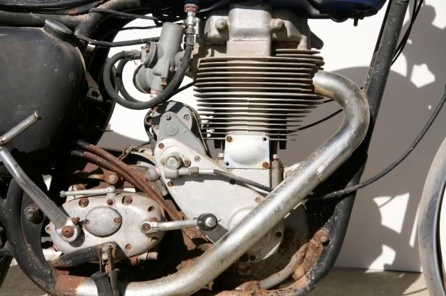

First Impressions

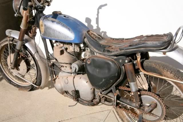

Steve Loken dropped off my new bike on my day off. It was a beautiful warm Indian summer day and I got to spend some quality time photographing, assessing and breaking the bike down. The bike may look terrible to most people, but to me, it is a shining jewel. The good news is nearly everything is there: tank, clocks, 190mm front drum brake, transmission kicks through and shifts, etc. The bad news is the motor is seized (frozen rings?), the cylinder head has a broken top fin, no Amal GP carb, the clocks are cores for rebuilds at best, no side or center stands, one of the centerstand tabs is broken off the frame, spokes and rims are bad, seat pan has rust holes, broken Lucas head and tail light lens, dented tool box and oil tank and a few other minor things. So what, the frame and motor match and every missing part is available in the US or UK. I have my Goldie at last.
A broken clock gives the correct time twice a day. My clocks tell me I will be spending hundreds of dollars to restore them.
Anyone home?
My dirty kinky girl

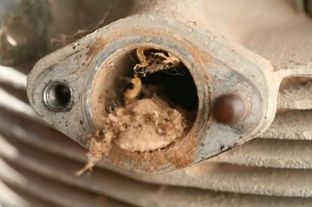

My bike spent 30 some years in storage in the dry New Mexico climate. I sprayed all the hardware, fasteners and moving parts in PB Blast penetrant and nearly everything came off easily. No drilling or easyouts, no snapped bolt heads, no impact driver. The only parts that gave my grief were the dreaded swing arm bolt removal and the fork sliders. I had Winona Welding and Sandblasting try and press out he swing arm bolt, but they needed to cut it and press out the remaining part. The fork sliders were siezed beyond belief and I have spent many frustrating hours trying to free them. No luck, so I found a used pair through the www.britbike.com forum. Everything else was photographed, cleaned, removed, labeled, bagged and boxed.
Weapons of Mass Deconstruction
The frame appears to be straight, rust free, and without repair. The only damage was a missing centerstand mounting tab.
Missing centerstand tab.

The gearbox shifts easily through all gears and the kickstart is smooth. On the other hand the motor is frozen solid. I have been soaking the rings and bearings in PB Blast, ATF and acetone, Sea Foam Deep Creep and Marvel Mystery Oil for more than a month. I need to weld up an engine stand so I can bring the motor into a machine shop to press down the piston and remove the cylinder. Once I get the motor broken down, Peter at Mods and Rockers in Mankato, MN www.modsrockers.com is going to vaporblast this beauty back to foundry fresh.
