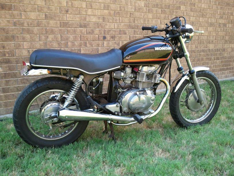

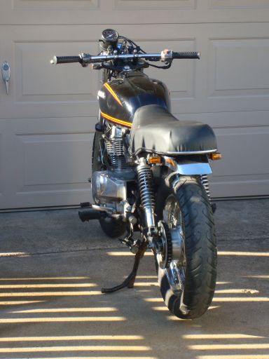

1980 CM400 ALL DONE
jachana
Almost finished, has come a long way, just needs exhaust built and some wiring done.

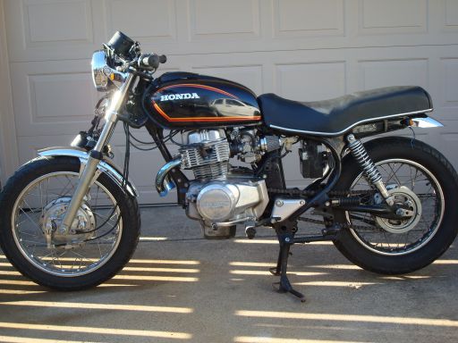

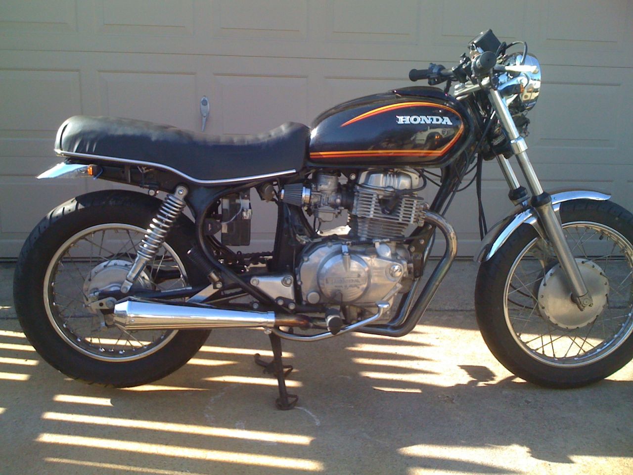

Re: 1980 CM400 E Almost Done
some more pics, almost done!

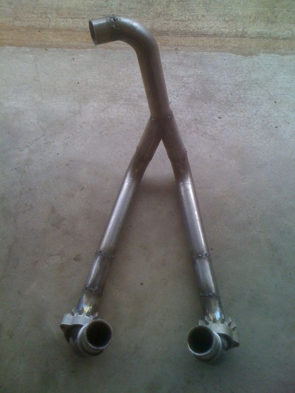

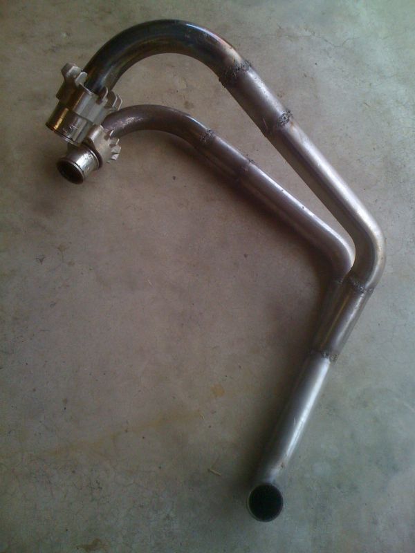

new exhaust build today, still have to tig it together and grind and panit or chrome, but 2-1 exhaust is almost done.

just need to find a muffler, probably going to do a reverse cone shorty muffler. I think it will sound nice!
your getting a lot of unnecesary restriction at that collector...
Unnecessary restriction? Do I need a larger exit pipe from the collector? I wanted to make sure I had enough back pressure built in. What do you recommend?
Is the collector pipe a larger diametre than the headers?
What are the diametres you have used?
I don't have the answers but if you give the info some one will probably be along who will.
I do know that if you go too big you will lose exhaust gas velocity and back pressure.
I've been building a single 125 system following advice from mates and guys on here and it is defo a dark art.
You could post any questions in 0800 cafe help?
The entire setup is made in 1.5" mild steel exhaust tubing. I got a dunstal shorty reverse cone muffler as well. We will see how it sounds, bet it will sound great!

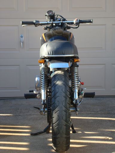

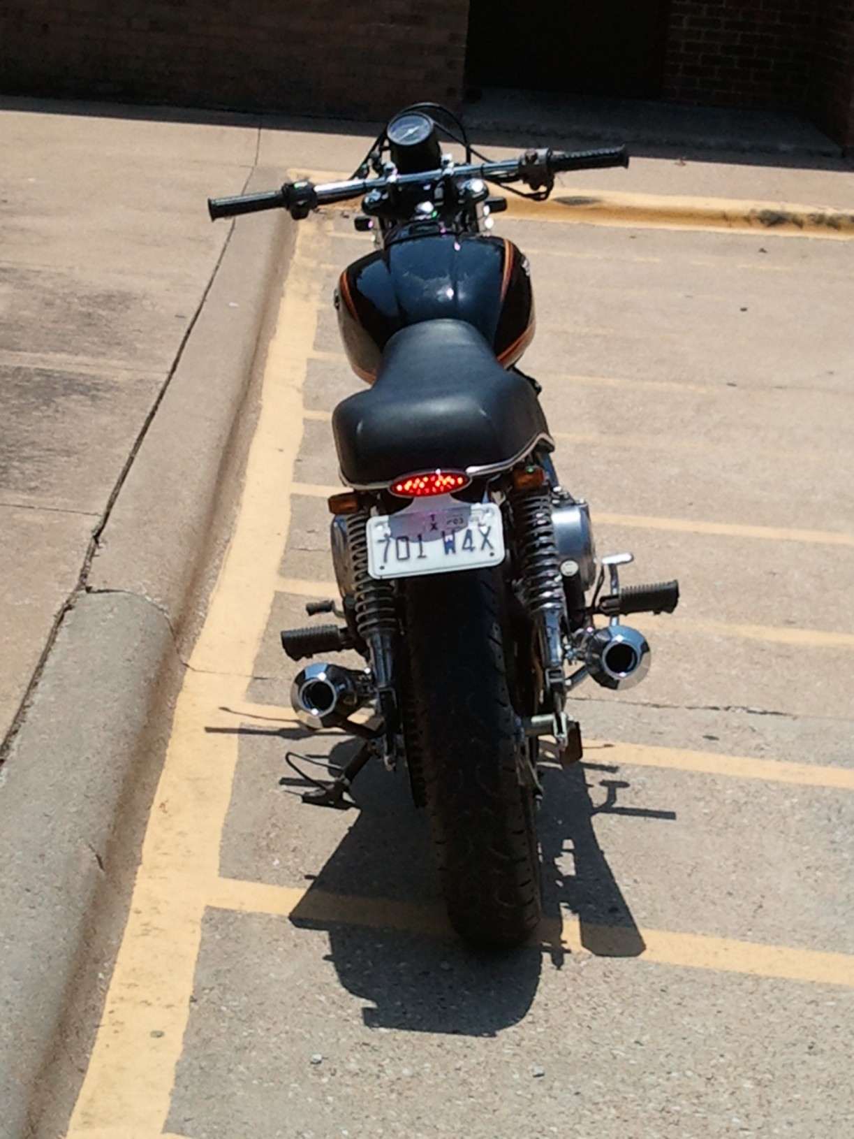

Nice! Glad you got the bigger one on there, I am sure that looks great, snap a pic when you can. I am loving the exhaust, the 2 in 1 setup totally changed the way the bike sounds and its a bit more peppy. I will attach a pic. Let me know how your project is going. Mine is almost done except for a few things-tail light, paint the pipes, and re-register and insure it, then its ready to ride.

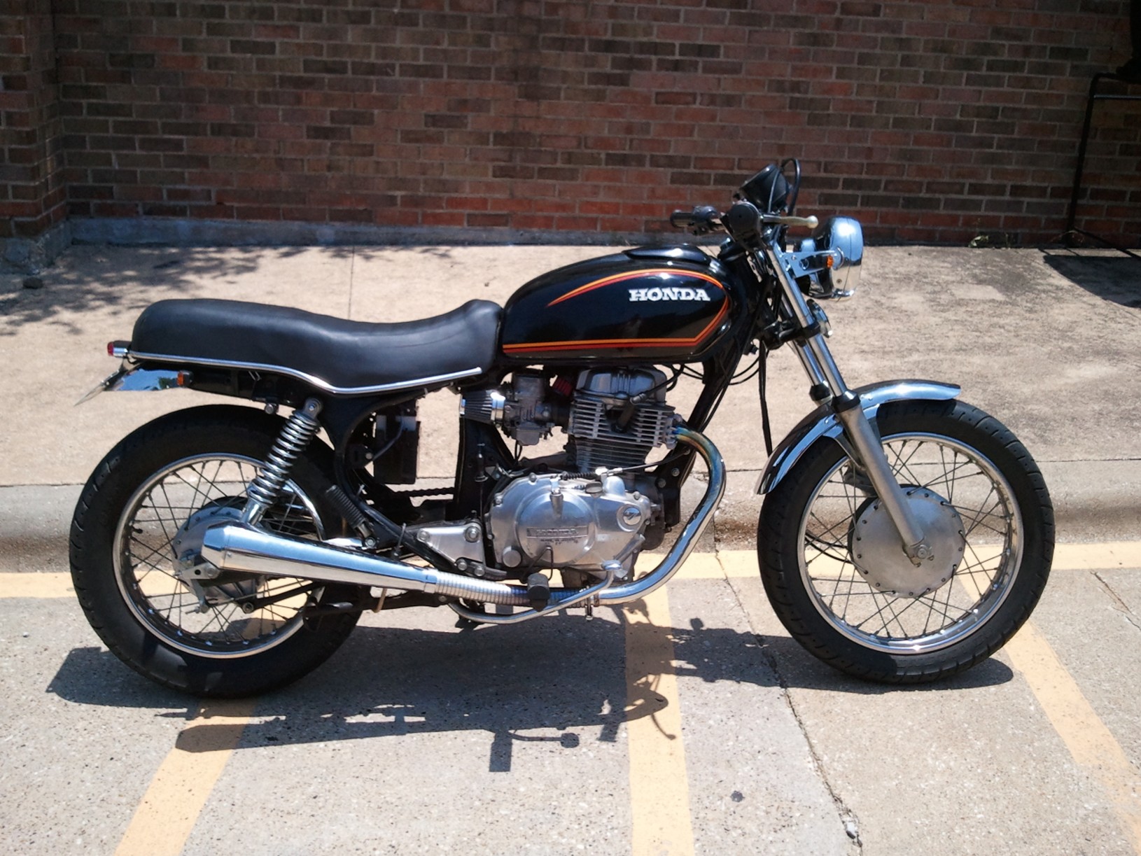

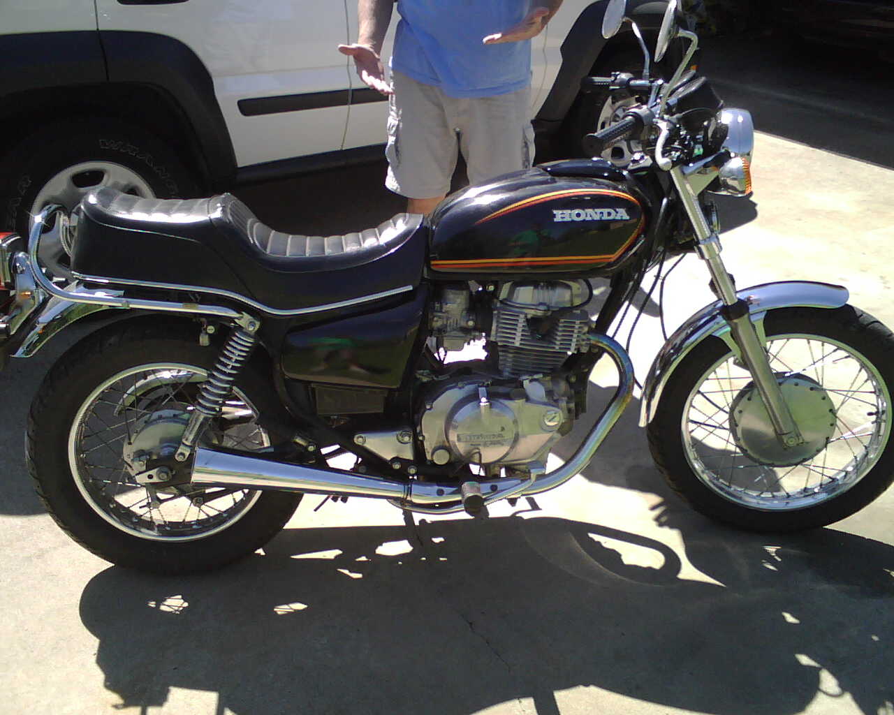

Finally finished, its much lighter now, much more powerful, and looks so much better! See before and after pics.
