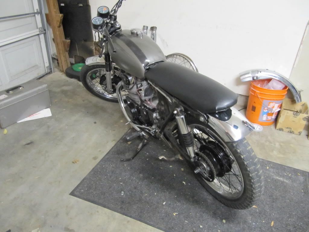

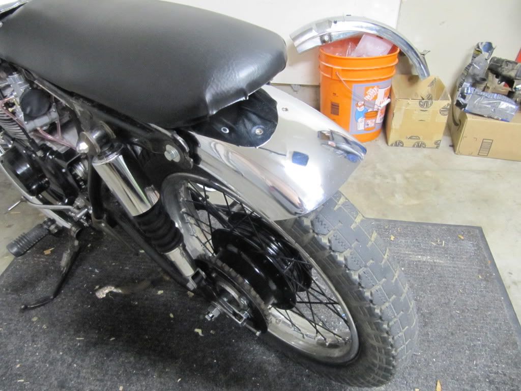

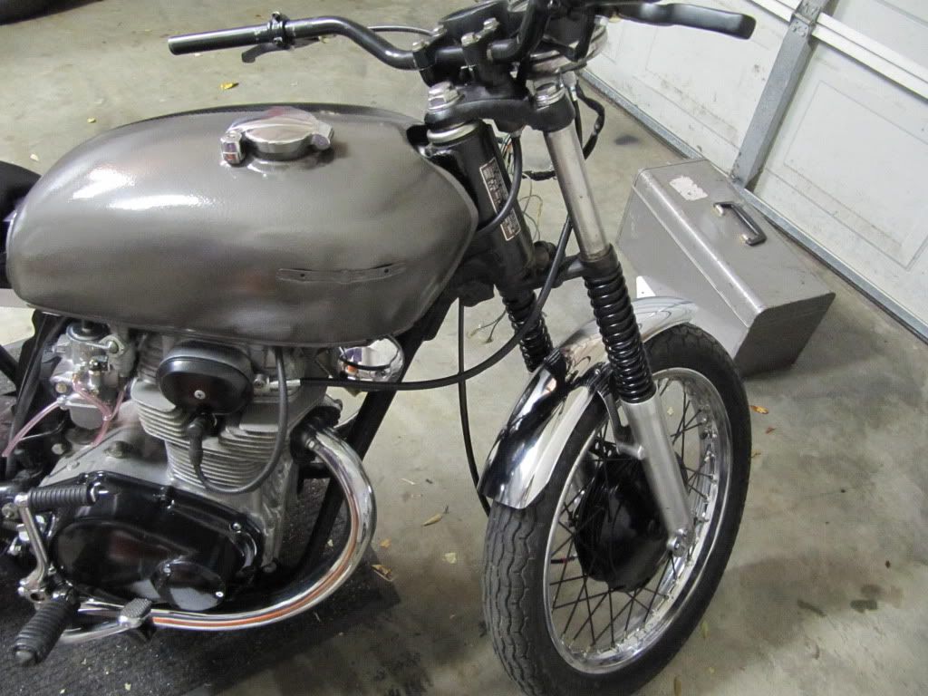

Made some progress finally.
Put 145 Mains in my Mikuni VM30's (So easy to do, I already love these things)
Chopped both front and back fenders (Good old hacksaw and elbow grease)
Covered my seat (It turned out ok, first time doing something like that and in total cost just under $30)
Clear coated my tank and got it all ready to go (Need to find one front rubber mount)
Got my levers in and hooked up the cables
Still waiting on more parts. (For some reason DCC is taking FOREVER)
Was hoping to fire her up this weekend, but I dont have any filters yet. VM30's use 57mm, is this correct?
Still need to order:
Chain
Throttle assembly and cable
Taillight
Pod Filters
Like 5 rear spokes
Shifter rubber
Mufflers
Tires
Tank Decals
Four bolts that hold the rear sprocket on (PO somehow ground these up nice and good, and they are a mess)
Clubmans, Bar end mirrors, etc,etc
Do I need to get #176 Style Bleed Type Needle jets?
Thats it for now.
