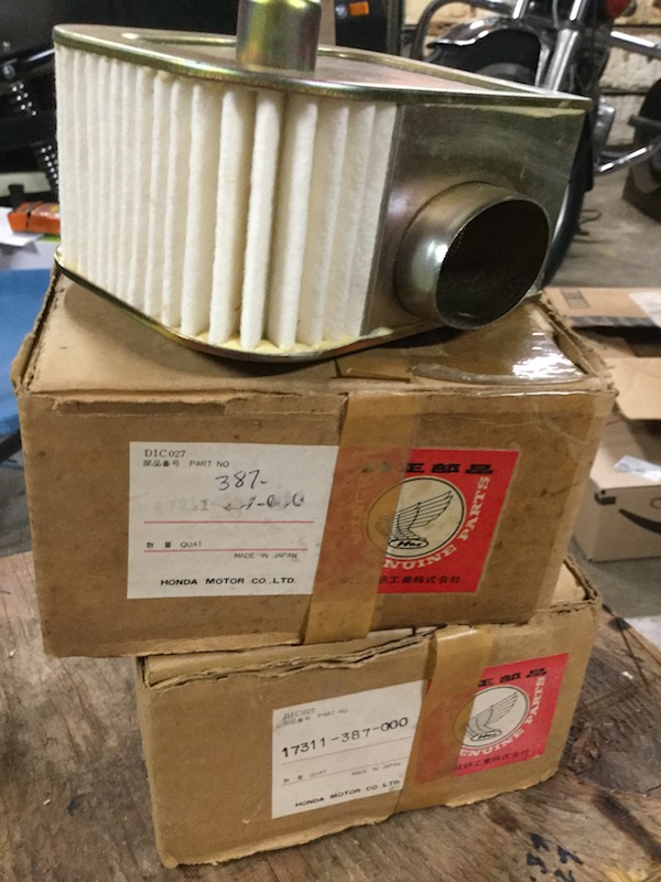

It starts w an NOS pair of filters I bought off ebay years ago when I first got my bike.  I think I paid $25 for the pair.  Times have changed.

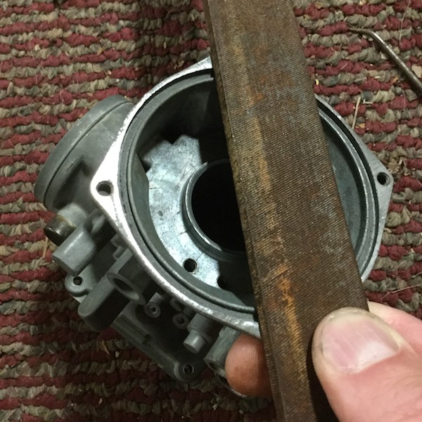

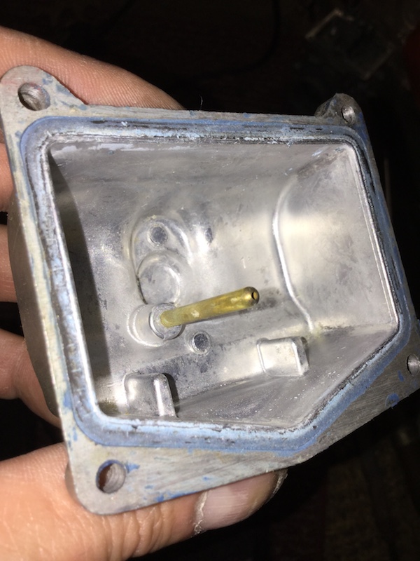

I use a big flat file to LIGHTLY run over tops and bowls to ensure they are flat (looking for any warping that could affect O-ring sealing)

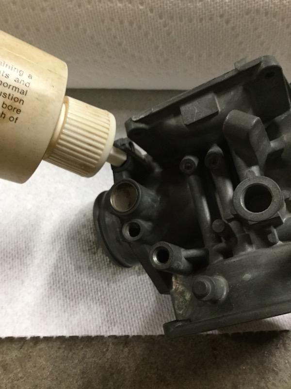

PO tried sealing bowls w blue RTV.  It wont work.  Blue RTV is not fuel resistant and will make a mess out of things.
Clean that shit out carefully.  Dont scratch the O-ring surface.  Heat gun helps w hardened bowl gaskets.

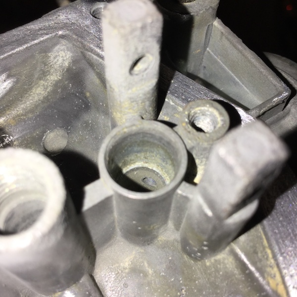

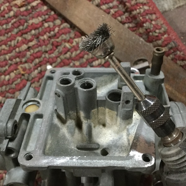

Blue silicone turns into crusty powdery shit CLOG and its hard to clean.  I will get as much as possible w dremel.

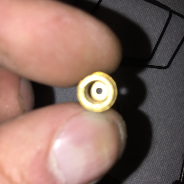

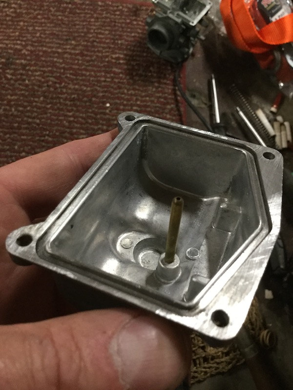

Make sure to clean/polish float seat o-ring sealing surface as good as possible and double check it for burrs.

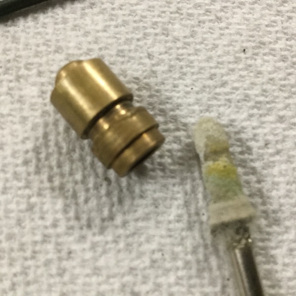

I learned to use a felt dremel bit and dab of toothpaste to polish float needle seat surface.

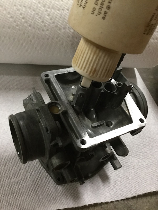

After removing from dip, rinse well w water.  Make absolutely certain water sprays from ALL 3 pilot holes and the larger single idle feed, by spraying hose into the Air/Fuel adj needle hole.  These two circuits are combined internally and can be difficult to clear debris trapped inside.
Watch for good flow through air corrector holes (under diaphragm in carb tops) the feed to the jetting holes.
And from fuel inlet through the float seat hole.

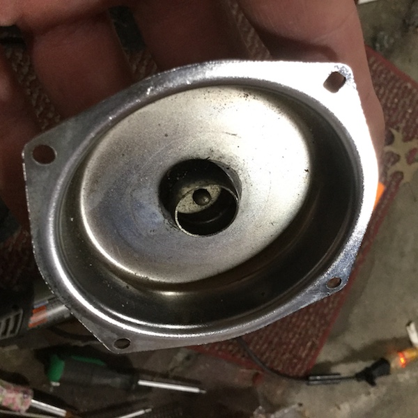

Inspect the overflow tubes in bowls for hairline cracks.  this was on my wifes 78 CB400a

Back at it I see. Neat little trick for the needle and seat, I need to try that on the XL...right now if i dont have a screwdriver handy i get fuel all over the floor of the shop.
I had to modify the felt polishing tip small enough to fit inside the needle seat.
I chucked up the larger felt tip in dremel got it spinning up to speed, turned on the bench grinder and gently ground the felt tip down to a good fit.
