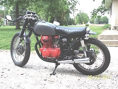

BEFORE STRETCH

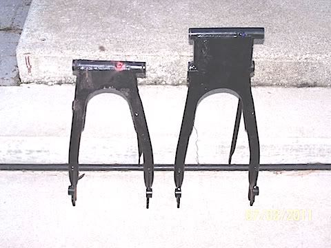

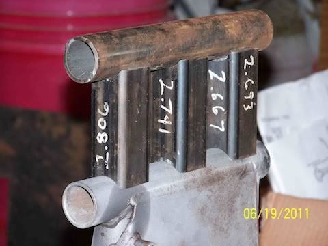

Before welding,got the tubing from speedymetals.com about $30 incl shipping. they have great selection I was able to get the same size and thickness tube as honda used.  best for wire welding.
The numbers are now meaningless, thats what I had after notching myself, not even close to right.  Machine shop touched em up and made them perfect.  All 3 corrected to be right.  If its not perfect...try again.  check and triple check measurements as your welding.  check for warping.  your ass will be riding on these welds.  My friend did the welding for me, I trust his welds.  I WOULD DIE ON MY WELDS.  He is educated has a certification...his welds have reason and purpose.

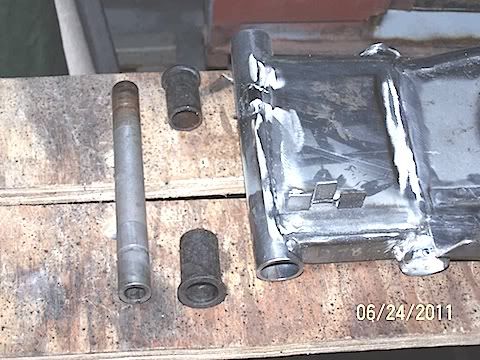

After welding w new bushings ready for install.  Machine shop bored tube correctly for bushings.

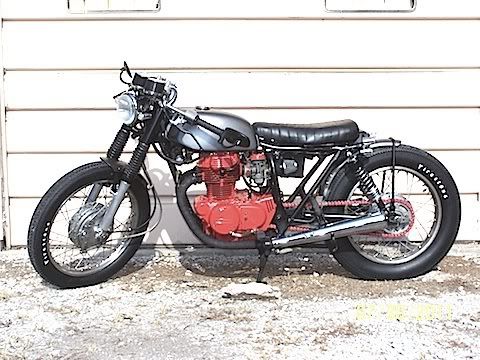

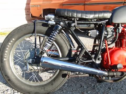

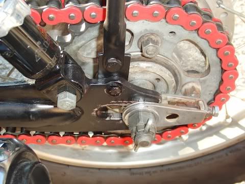

End result.  Rides great, new bushings helped that.  New chain, longer shocks from DCC lowered it a bit but not much, modified a brake lever connector rod using longer one off 69 CL350 sprint.  Had it up to but never over 80 mph on good straight road.  Barely noticeable in cornering.  I dont take hard turns at high speed anyway.  Im a 44 year old dad.  pretty conservative rider.  I am delighted it actually worked and I didnt have to scrap it.

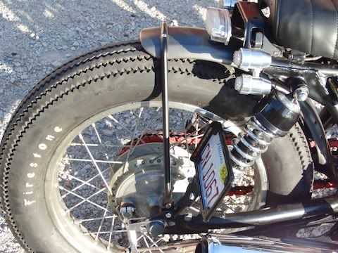

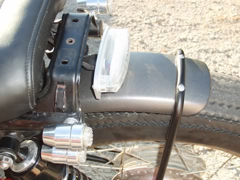

Rear Fender mount....
  A couple guys have contacted me about the rear fender on swing arm.
I have plans to improve it this winter.  Right now its kinda scabby.  I was ready to ride so I just threw it on there in about 30 minutes.  its held up real good though doesnt rub and haven't  touched it since install.
This is the original cb360t front fender.  I had ground the rivets off to remove the brace rod.
So, I had to dig brace out of the garage.  I couldnt believe I kept it.  I cant believe I found it.
My plan is to hide the brace rod behind the shocks for a cleaner appearance.  But to get it on the road this is what I did.
The brace rods are about an inch short of what I needed for tire clearance.  So I cut and drilled little tabs to add the height I needed (first scabby part,  I intend to re-do nicer this winter.
Next I cut front mount from piece of sheet metal.  and drilled and tapped swing arm sheet metal.  1/4-28 bolts.  I used fine thread cause the swing arm steel is pretty thin.  This bracket could also be nicer looking.
Moved tail light from bracket behind seat to fender cause it left a big gaping hole.  So taillight fills 2 1/4" gap tween seat and fender.

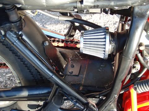

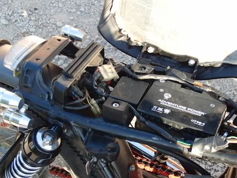

also all the electronics (rect, regulator, solenoid are hid under seat.)
so thats it. PM me if you have any more questions

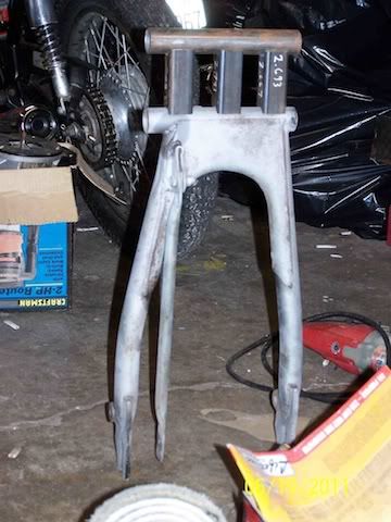

Before I started
Cut for extending
extension peaces
Welded together
Cleaned up
Installed . Finished product
I've been wanting to do this since I brought the bike home . So thursday night I got some time after work  ((considering it was after midnight and no one was awake ) and started cutting the donor swing arm . Finished it up last night .

Looks great, did you add some tubes or anything inside for added strength and stiffness?   Or did you just butt weld the tubes together?  Im sure there is a bunch of twisting pressure happens to the swing arm when cornering.  Is your rear tire nice and plumb, level and square?  With the frame and front tire.  Like before you started this.  DCC has good prices on longer shocks to bring it back up closer to level.

I made it stronger  buy adding a couple pieces of pipe and plug welding it and the welding the pieces together . It still needs a bit od tweeking but it will be fine . I'm not looking for bigger shocks , I'm looking into honda rebel shocks to bring the ass end down more.

trec how did you come up with your chain ? Did you just add to your existing one with master links or .....?
Offline trek97
  • Posts: 1367
  • "You are surrounded. Get off the babysitter!"
    • hondabrat.com
Re: Lets see your Swing Arm Stretch, PICS & How you did it.
« Reply #9 on: Aug 08, 2011, 08:23:28 »
I got a new 120 link chain from d2moto.  So I just cut out a few links.  they have all different colors to choose from.  check it out.  $39.99 + shipping.

Trec thanks for the concern but checking great forums such as this and being around fabrication for years I new I needed to put a slug in there to streathen it up. Thanks for the info on the chain .
