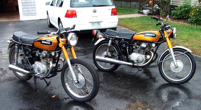

Last year I picked up a 71 Honda CB175. My first bike in about ten years. After one accident twenty years ago and a couple of close calls I thought I had sworn them off. Yeah right. I had planned on turning the 175 into a cafe project, but it was in such good shape I couldn't bear to cut it up. A couple of months later the same exact bike goes up on Craig's List for 200 bucks. It's pretty rusty, but it runs and the side covers are intact. Sold!

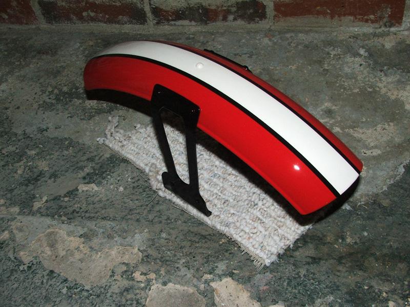

As far as the paint goes, I'm having a little trouble with the clear coat. The front fender started "crackling" about a year after it was completed. I was able to sand and buff it out, though I would like to know what caused it. I am only using rattle cans. Rustoleum automotive paint, so I'm not expecting fantastic results, but I wasn't expecting it to do what it did. I am sanding between all of the coats of primer, paint and clear with 1000 grit wet paper. Is the 1000 too high? Should I go lower, or is it something else?

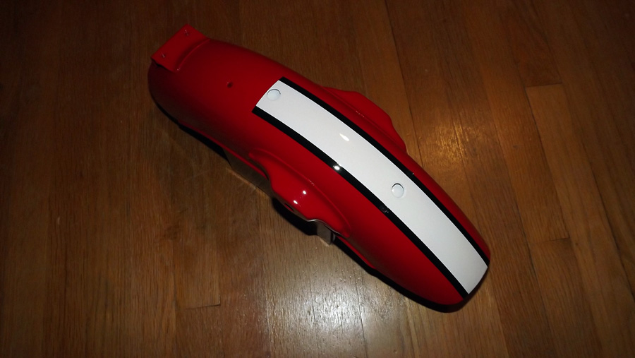

Finally finished all of the polishing I'm going to do.
Chopped the rear fender and about half way through the paint.

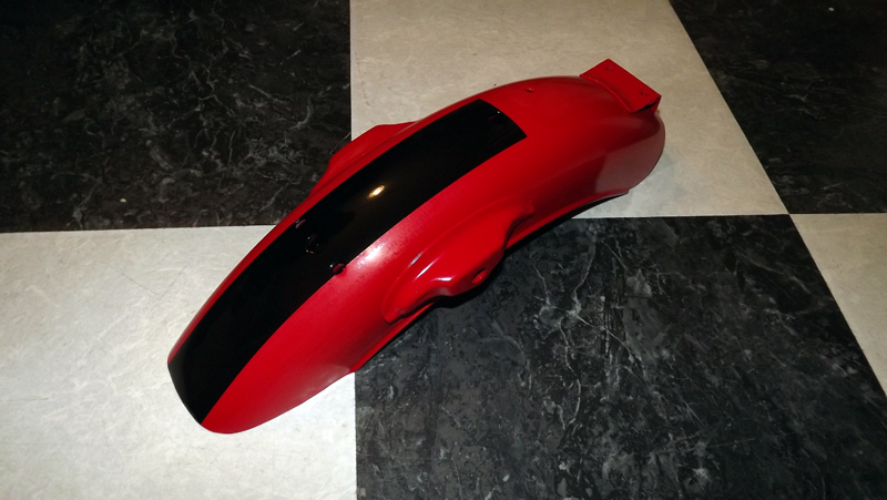

Rear fender is finished. I think it came out pretty decent for a rattle can job.

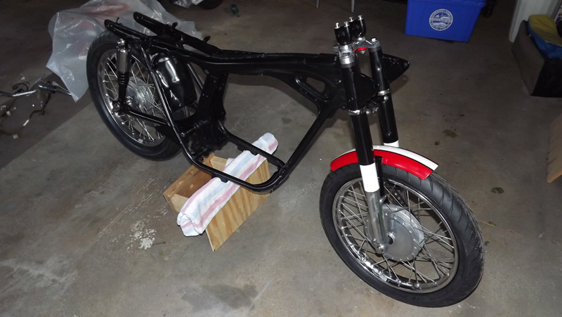

Been making some steady progress through the spring. Wheels are on. The engine is in. The wiring is just about all sorted out. Just need to pick up a tail light, and that should finish it off. The speedo is in. Hopefully it will work. Headers are cleaned up (again), painted, and ready to be installed.
