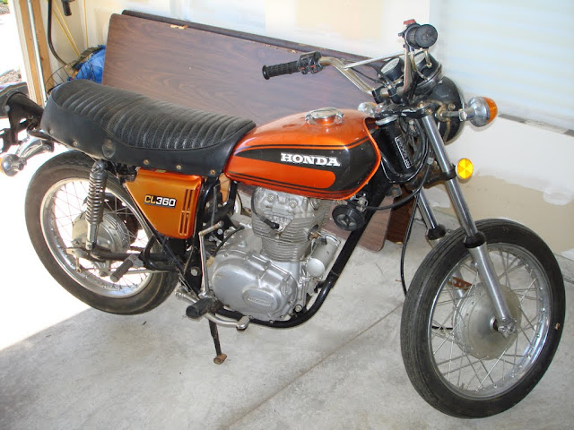

1974 CB360. Some stunter must have owned it because it came with a 12 O'clock bar and a stunt cage.
I originally picked up this CL360 but it didn't have a title. Here in Ohio they seem to think that if you have a bike with no title, then you are a thief. There was no one at any of the title offices that I called or visited that offered even the slightest bit of help. Oh well, $125 lesson learned. It was worth it just for parts.

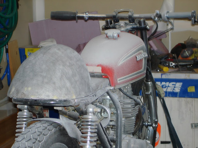

I wanted to build my own seat. I have worked with fiberglass a little working on race bike fairings. I also have the advantage of working for a company that builds large fiberglass fans.
My first try - I kinda like it and kinda don't.
I also grabbed the drum front wheel and pipes from the CL and put them on the CB.

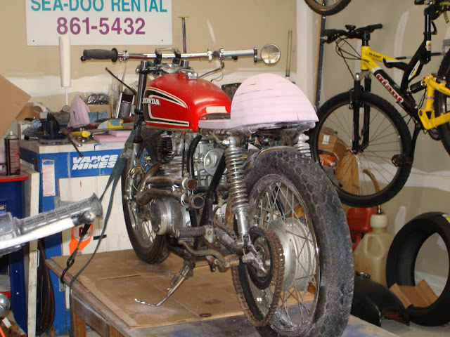

I tried another design, something different.
It only cost me $20 for the foam and it was enough to do a bunch of designs. Good thing since it is hard to get them symmetrical.
Going more traditional cafe.
Foil, tape and waxed.
couple layers of glass and topped with some carbon fiber that I had laying around from an old project.
The carbon has some silver in it, but it didn't look as good in person as I thought it would.
