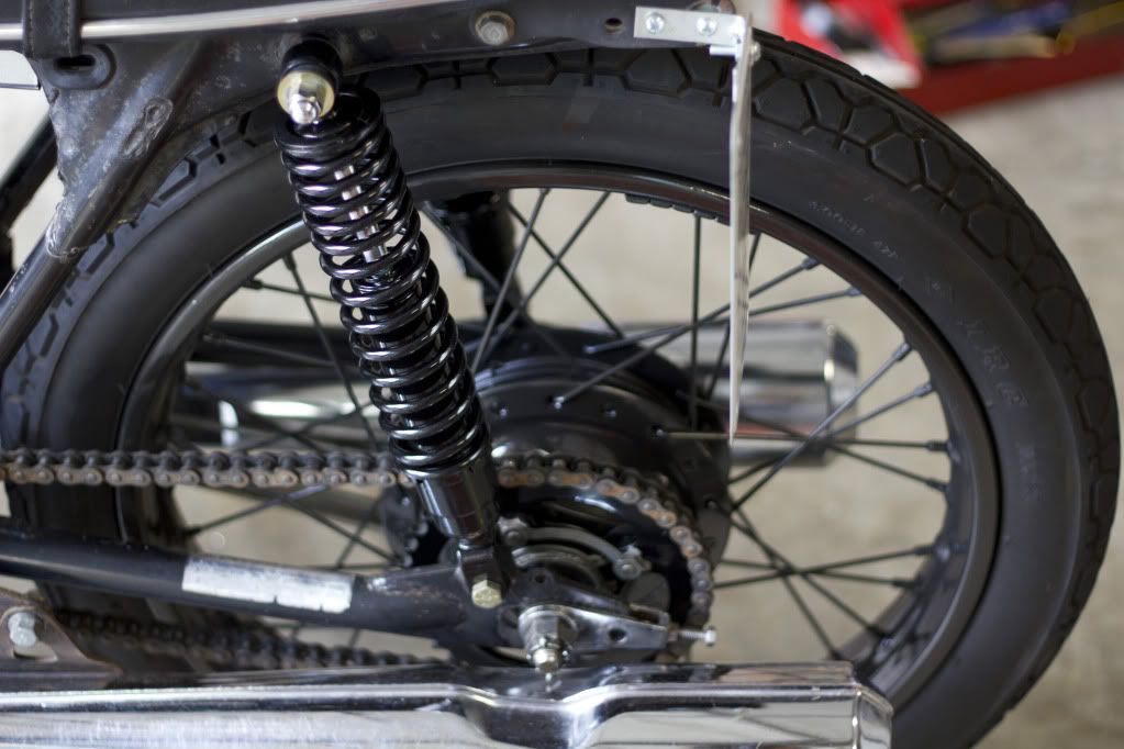

Well today should have been an easy reinstall the painted rear wheel and rear shocks, remove started motor and plug hole, check timing and valve clearances and then RIDE.
Not so much :( >:( :(

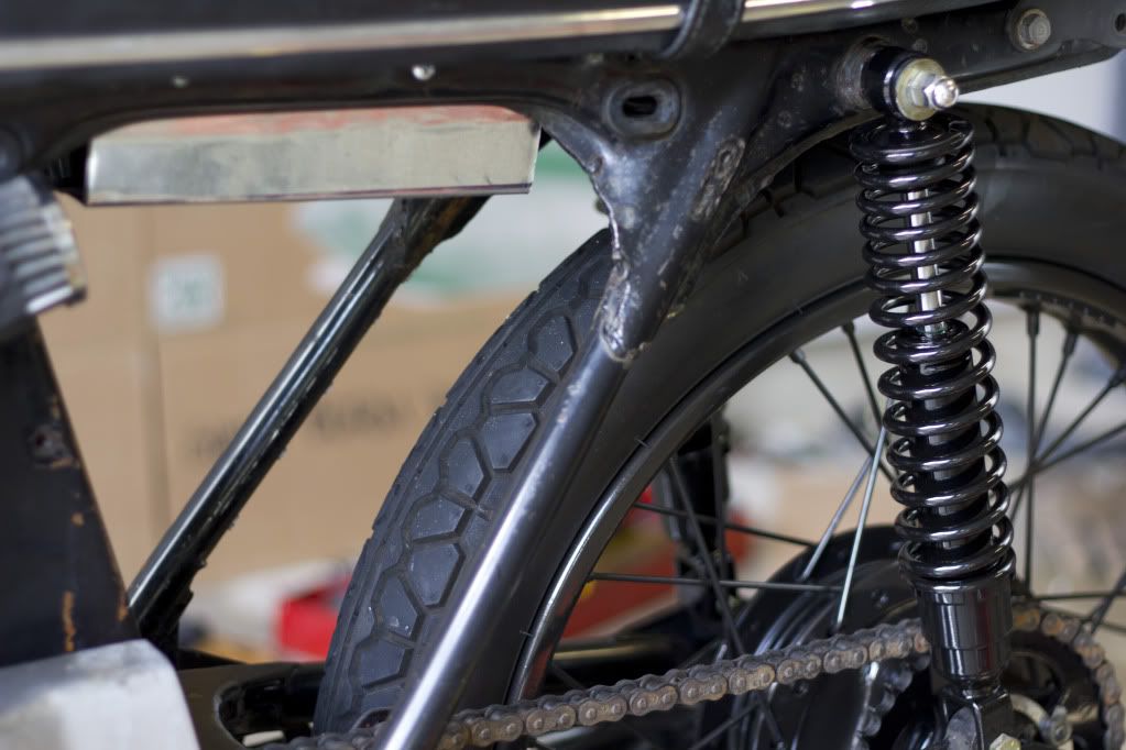

The rear wheel and shocks turned out pretty good
Also notice the lack of the rear mudguard thing. Really opened it up nicely

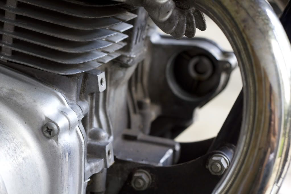

Then I pulled the left engine cover to remove the start motor, gear, and chain. No problems. But I grabbed the wrong size plug DUUHHHPPP >:(

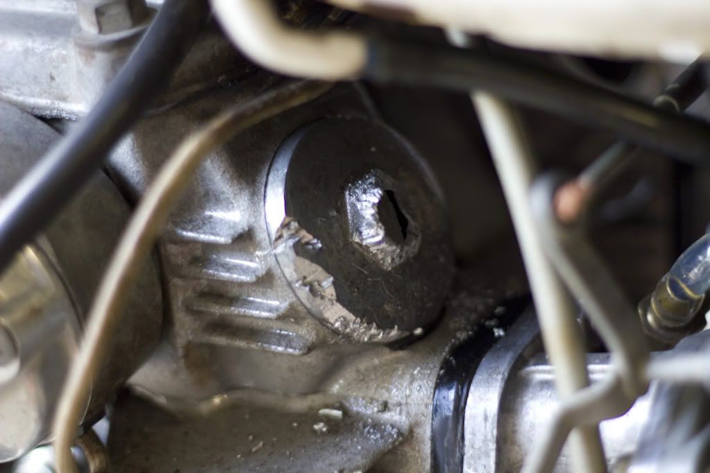

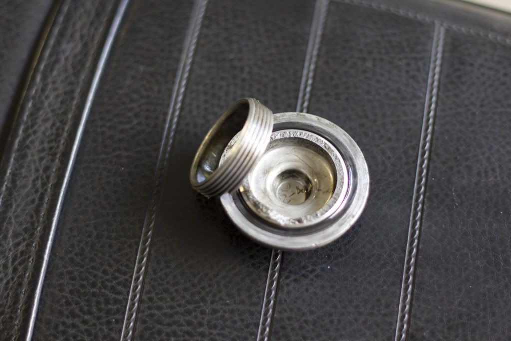

Next started on the valve clearances, both exhaust valve tappet covers were pretty snug but came off. Set both of them. Next the intake clearances, and all hell broke loose. These things were SNUG. The first one snapped off at the threads. What the heck!! >:(  Luckily the threads came out easily. The second one was even worse, got stripped then I busted out the vice grips, they stripped it even more. This thing will not move. Then the head snapped in half. The last picture is where the cover currently sits. What a frustrating day, I just wanted to ride. >:(  Now I am in need of two tappet covers. Done ranting! I love wrenching on these old terds.

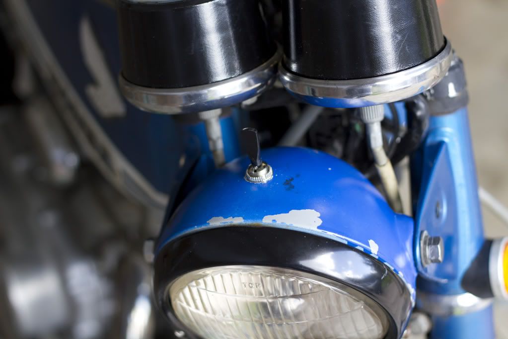

Oh, here is a picture of the new hi/lo/off switch for my headlights

Damn, you really went at it with those vice grips haha, you should invest in an impact driver. I got cheap one for about 30 bucks at auto zone and haven't had any trouble getting any stubborn nut or bolt off.

Wow. I don't even know what to tell you about that cover........
You don't plan on running it without some kind of inner fender, do you? That will just throw crap directly at your carbs.
