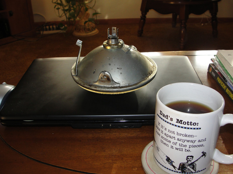

Next up was the burned out headlight.
After investing a few hours online, and finding no direct bolt-in replacement. I decided to try to modify my existing light, to accept a halogen H4 bulb.
First I pry up the tabs on the center of the housing.
Before:

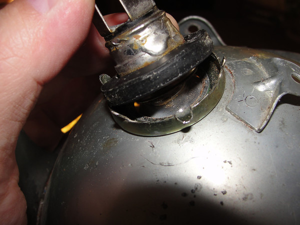

Then I pry out the retaining ring, and pull the rubber sealed bulb out of the housing.
But the bulb itself is bigger than the hole it fits into in the housing/reflector.
(How did they get that in there?)
So I had to take a sharp punch and a brad-hammer to bust the bulb. (It shattered nicely and was easy to pour out of the reflector/housing)

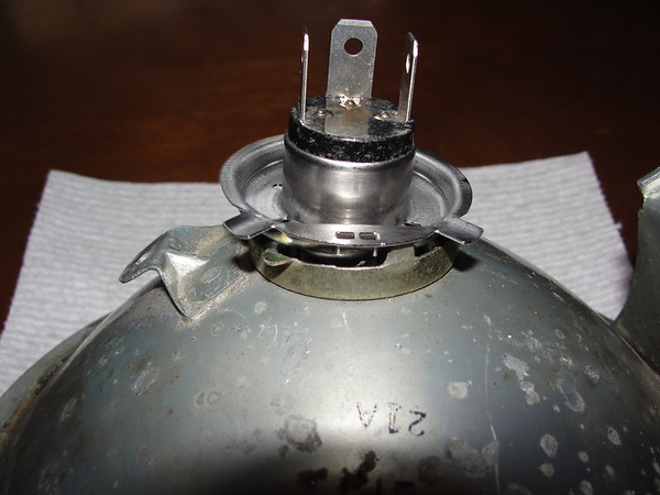

The H4 halogen bulb has a larger flange than can fit.
So I make a series of radial cuts to flatten the flange, and reduce the diameter.
Then I trim the diameter to size. It was nice of our German friends to place lettering in the proper diameter.
Too bad I went to the outside of the lettering, instead of the inside. So I had to do it over.
After carefully de-burring with a fine file, I re-used the rubber seal from the original.
