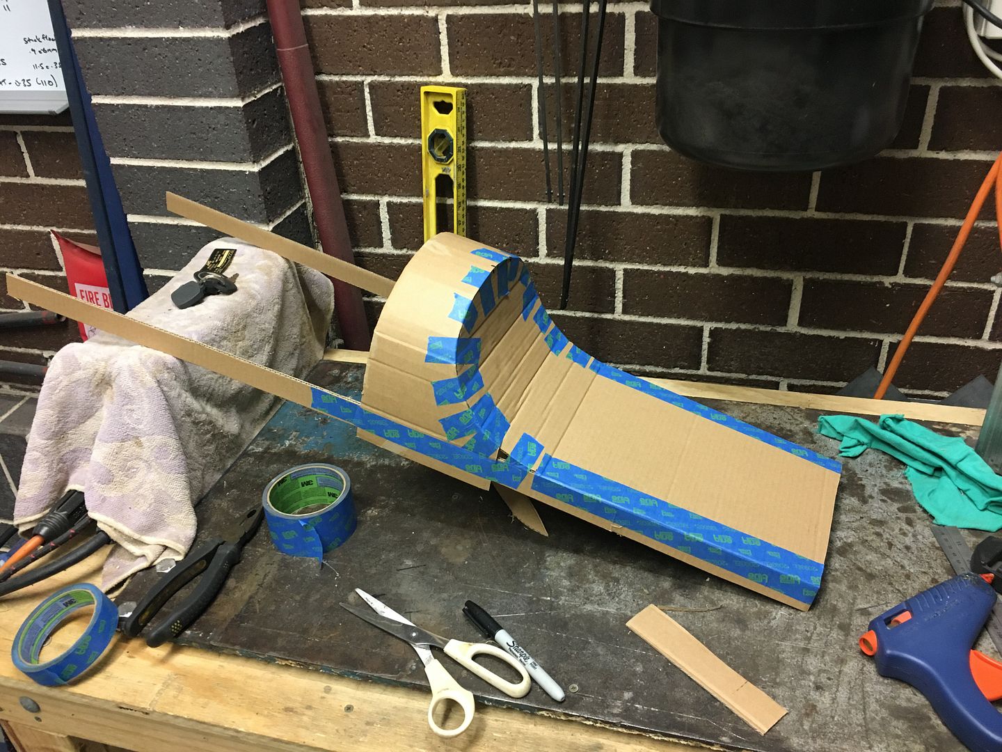

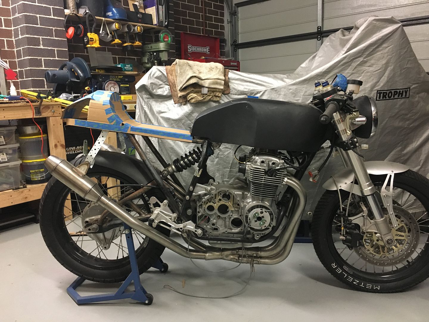

Been mucking around with other projects and lost time to work on the 400F.
However today I got back in the shed and started something Iíve been avoiding for a long time... seat v2.0

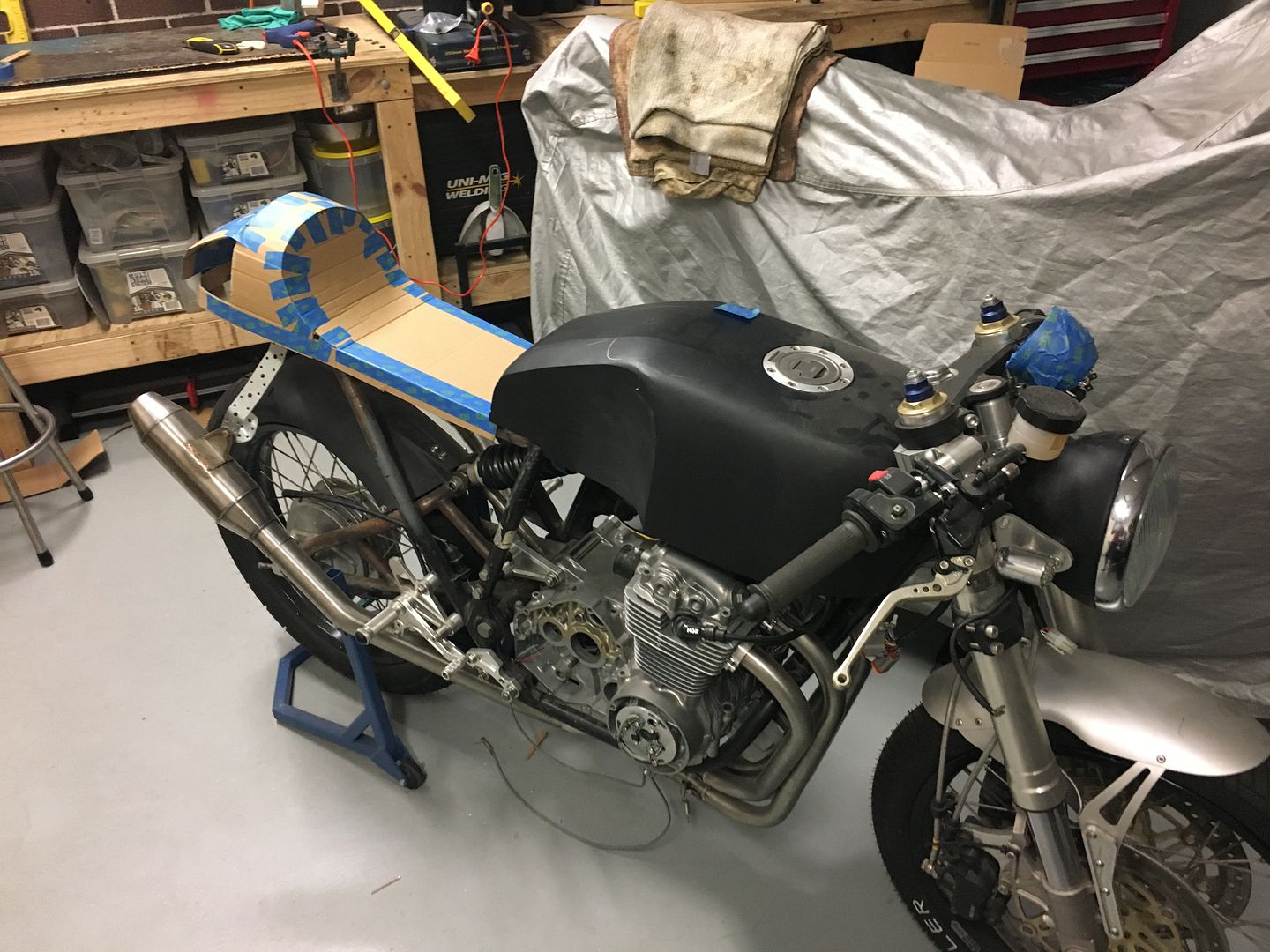

First up a refresher of where the bike sits:
Had to remove the wiring harness because itís hardly needed at this stage.

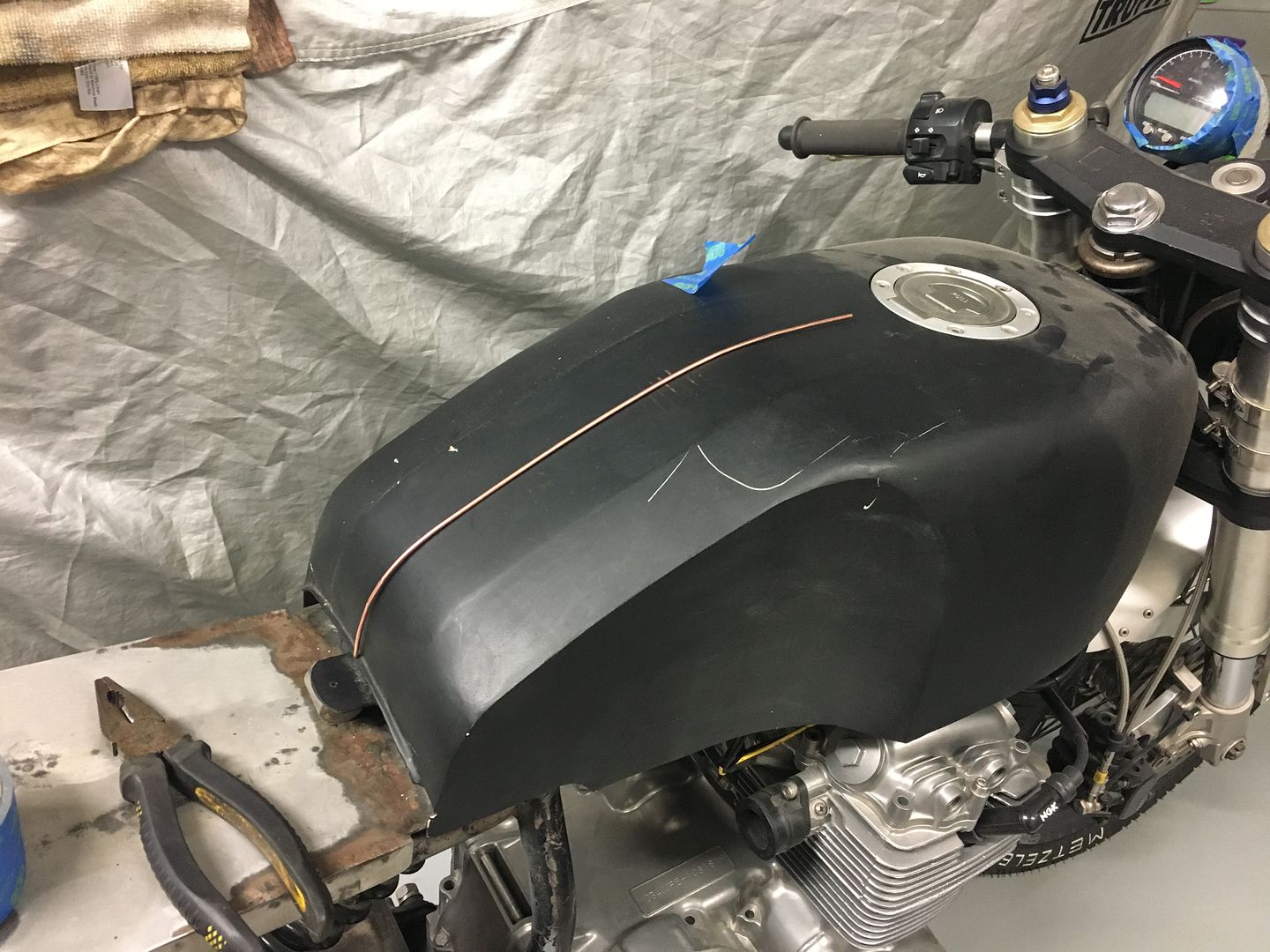

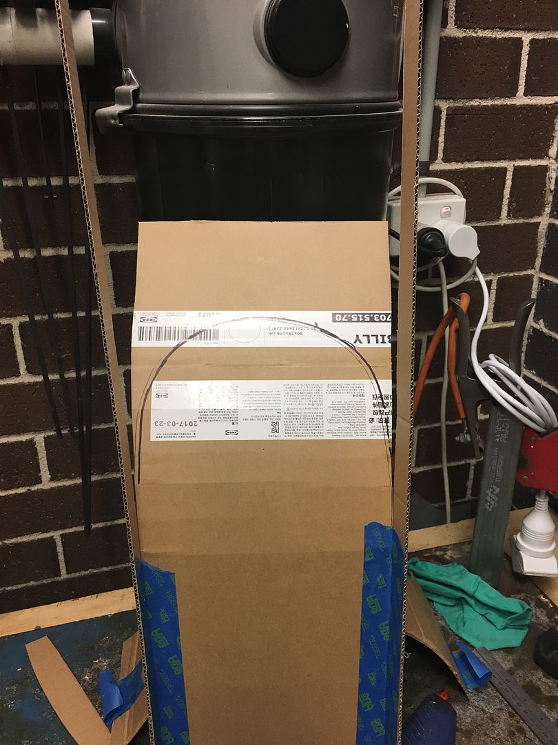

Many people have been hinting to use the rear end shape of the tank as a guide, so I grabbed some welding rod and set about copying the shape:

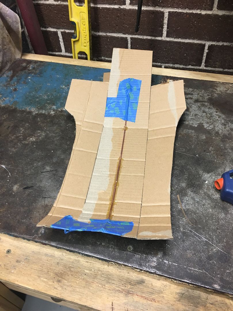

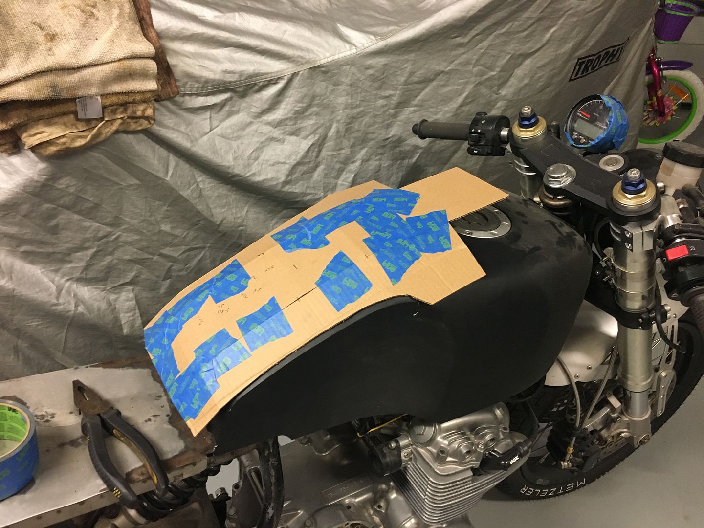

Next I took the tank and thought to copy the main centre strip and 2 side strips:
Glued the welding rod to the underside to hold the shape:
Iím still a fan of the seat area so I copied that in cardboard as the front half of the seat:

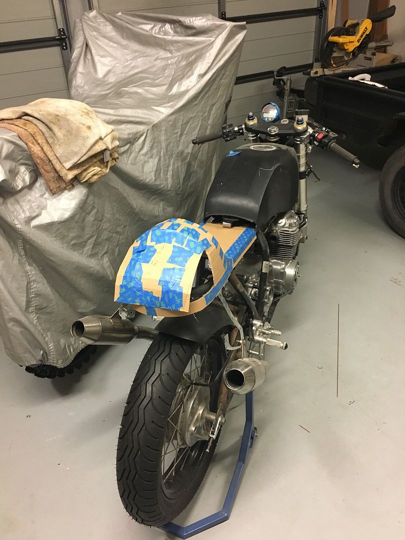

Combined the two (loosely) and discovered two things:
1. Getting the straight panels to merge nicely in a seat will require some artistic licence, eg Iíll need to shrink the width of the panels down a lot or merge it much nicer, at the moment it looks like shit and I donít think it will improve much with the current idea. I donít want a square seat either, just donít like the look.
2. The added length of the seat does look better balanced on the rear end.
So thatís where Iím up to so far. Unfortunately Iíve run out of argon, otherwise Iíd start to cut some steel and tack some stuff up, so much easier to get these angles and curves in steel than cardboard.
My next move will be to make the frame so I can get the length I want. I think it will be about 1Ē less than the cardboard version (1Ē longer than the current steel seat). Then Iíll play around with a few more cardboard options before committing in steel. I think itíll end up being another compound curve seat unless anyone has some ideas on how to merge the flatter shape of the rear of the tank with the rounded seat I prefer.

I find it very important to mock up the upholstered portion of the seat when I am deciding on the cowl shape.  You can carve up an old seat foam to roughly fit and wrap it or paint it dark like the cover you intend to use to approximate the end result.  I make mine from fiberglass with the seat base and cowl as a single component, so it is easy for me to shape the rigid foam for the cowl and soft foam for the seat at the same time.  Looks like you can do the same thing adjusting your cardboard mock up with the seat foam until you get the shape of both to look like you want.  I see an awful lot of bikes that would have looked a lot better if the upholstered portion didn't look like the separate project it was.
