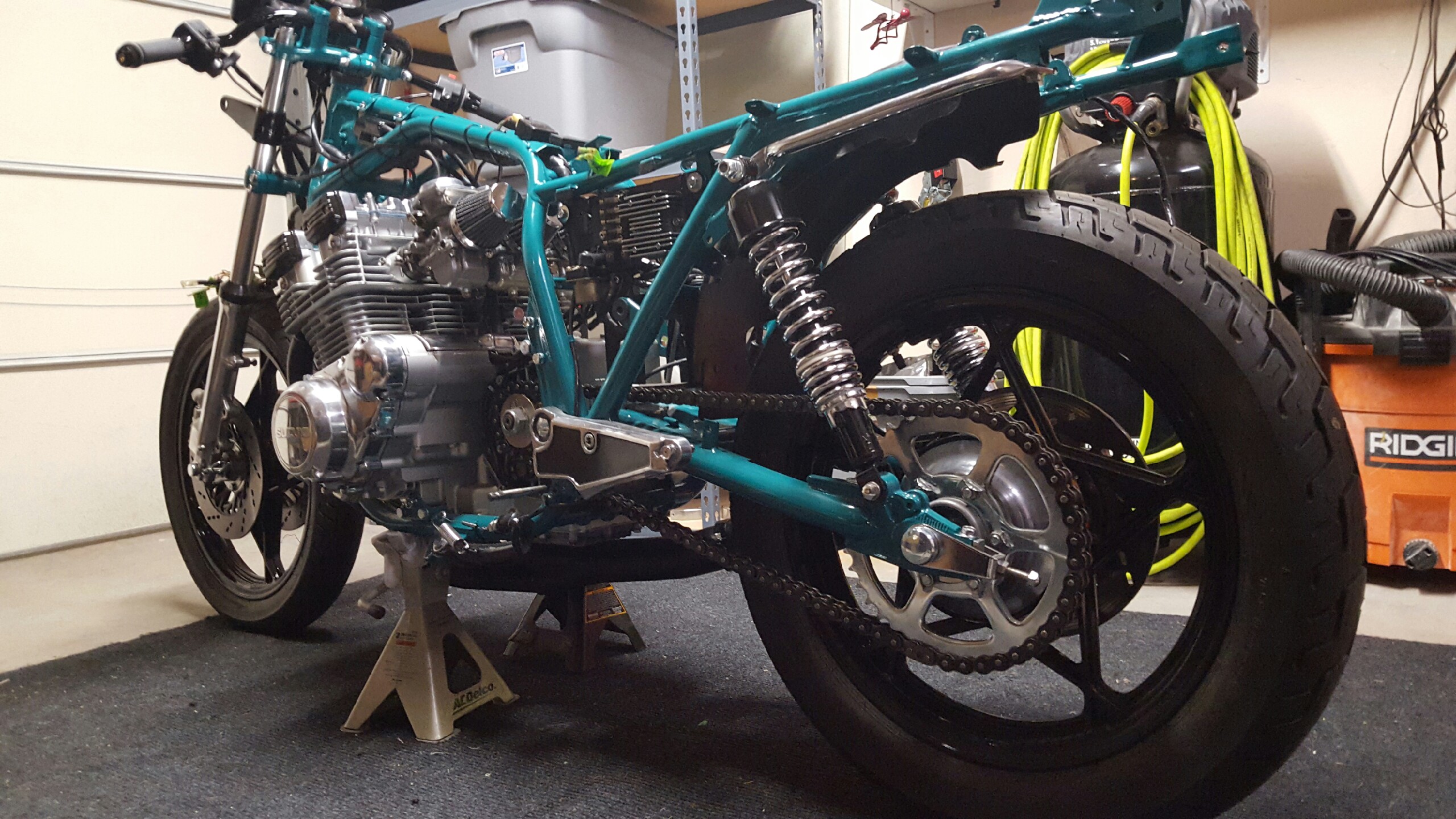

an inch on a bike is a major change.  the problem with these older bikes is they're long and bits are heavy - wheels, etc, so it takes a bit of moving.  hence the wide bars.  tilting it forward doesn't make it stop and drop like a late model bike, it just makes it "unstable" and requires stuff do things it doesn't want to.  think of it as flowing through corners instead of attacking them.  they can be ridden fast with good suspension, but it's a different style.
the way you have it now is the fun part.  all the clean bits looking a lot like a motorcycle.  finishing it off - running wiring through it all, making it all fit - can be a real pita.

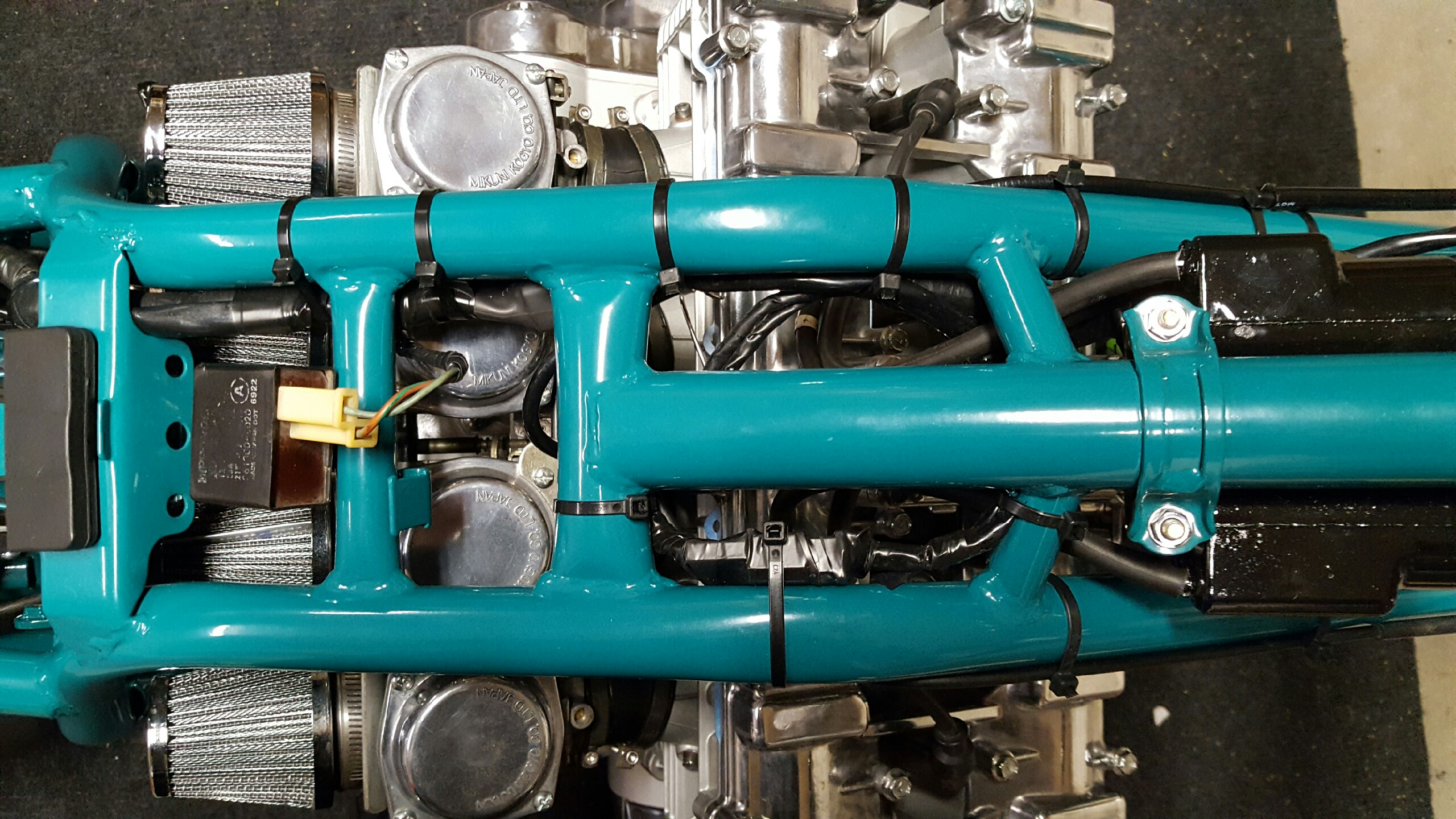

I second changing the pods.  I have those emgo pods on my XS500.  They are horrible.  Clog jet ports and fall off.  For my KZ650 I got Unilter Pods.  They are amazing, can't stress that enough.

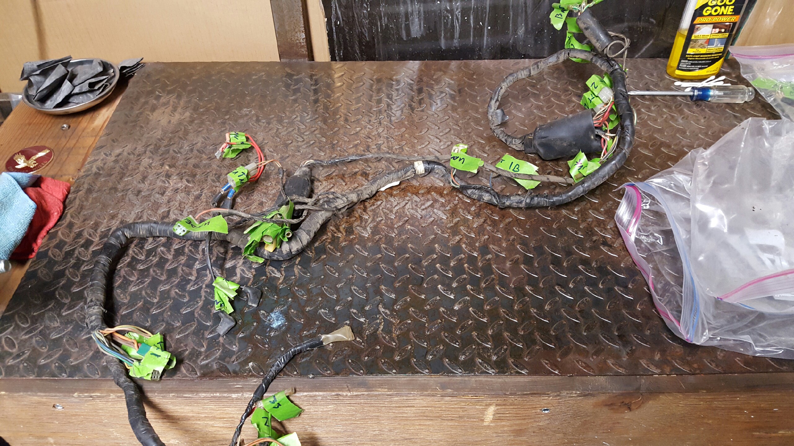

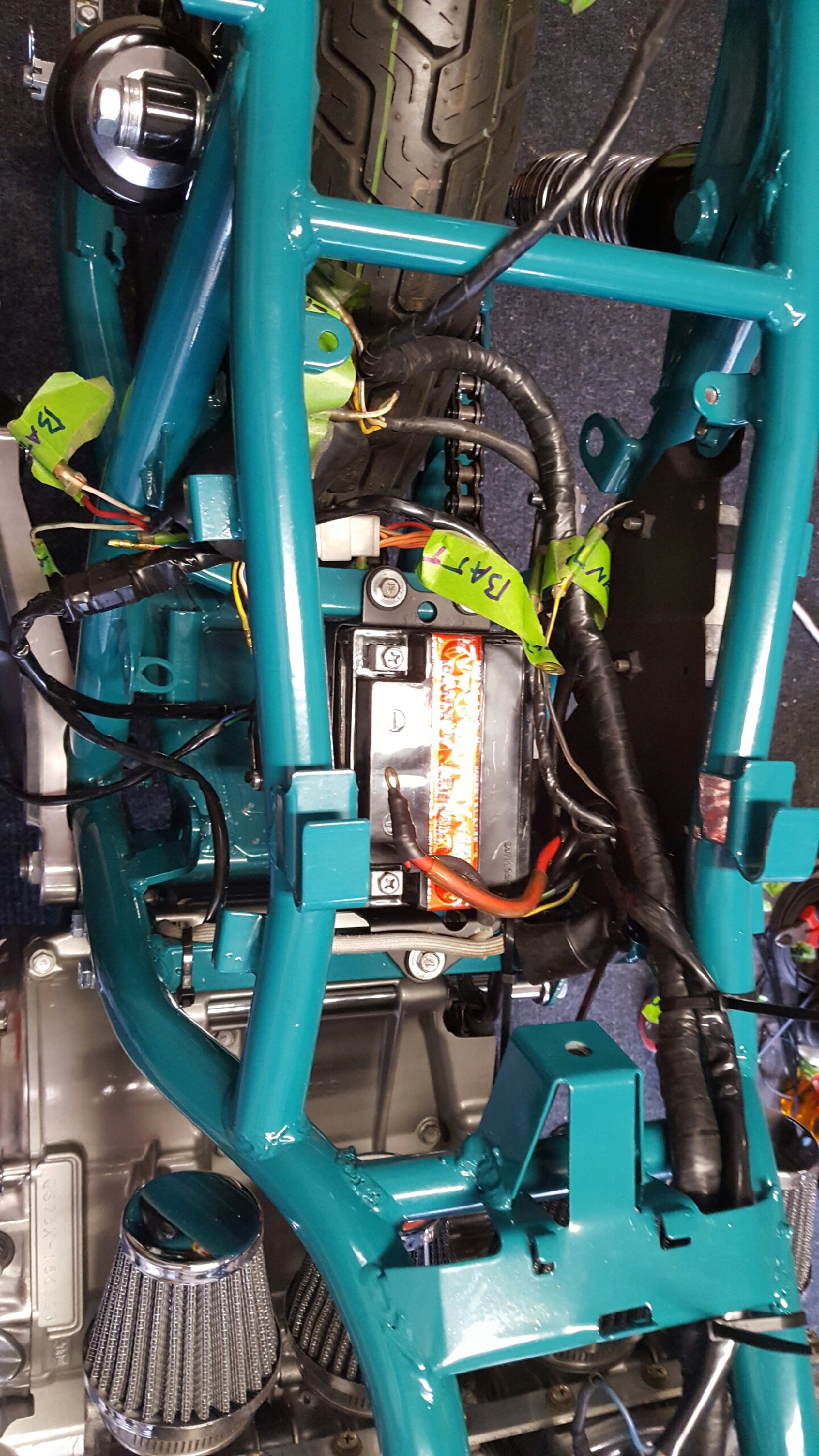

Wiring was the next task that I wanted to accomplish and then I wanted to test fire the engine. It was at this point that a lot of the prep work early on really paid off. I had tagged every connection even if it was blank. The pictures I took early on also helped to determine the best routing. I also knew that somewhere there was a wiring issue that the PO could not apparently fix.
This was the wiring harness....

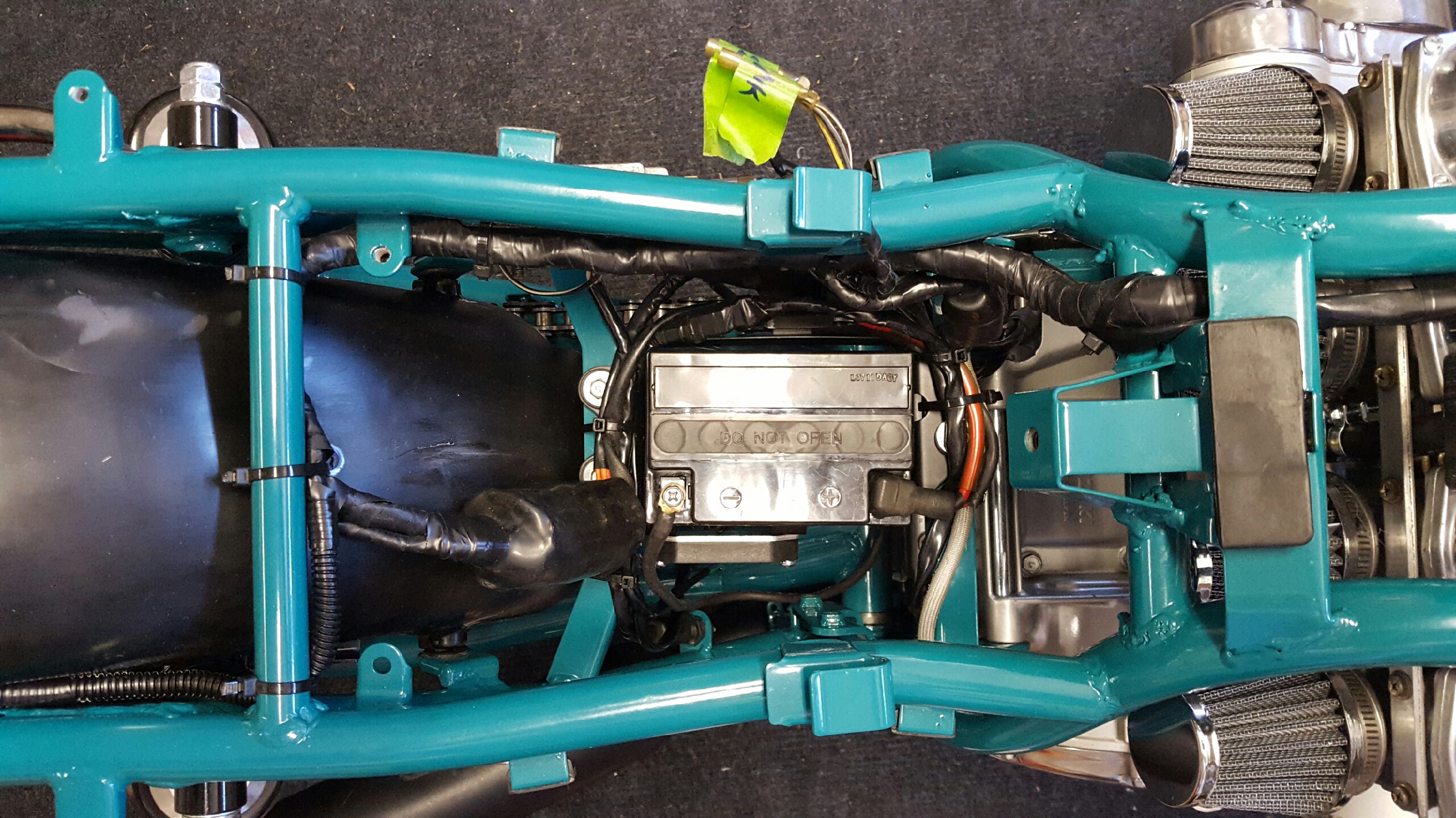

I cleaned up the harness and began making connections....
I eventually had a satisfactory layout and something that wasn't a complete rats nest. This approach also allowed me to track down the wiring 'issue' that the previous owner had eluded to. The rectifier that was on the bike actually belonged to a Honda. After searching for the right model number I was able to find a used one off of eBay. After new fuses, some shrink wrapping, and a new battery things started to take shape...
I still have some minor components to add such as a headlight, turn signals, and horn but everything is accounted for and there shouldn't be any issue with these.

Hi All, just wanted to post a quick update with the new developments. As was recommended, I dumped the cheapo pod filters and upgraded to the K&N filters. A change to slightly larger jetting will also occur.

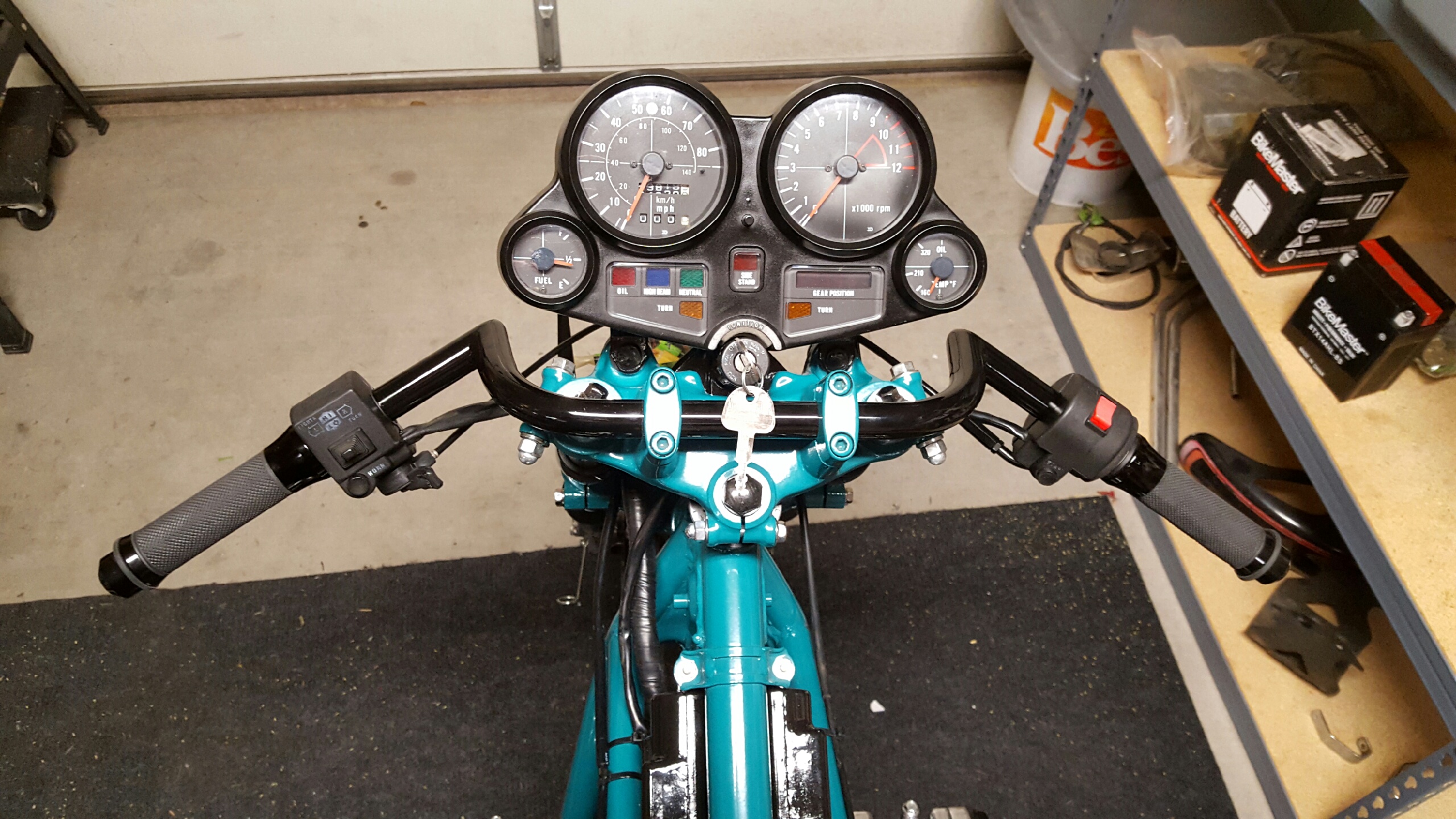

This project is awesome! What are your plans for the gauges?
