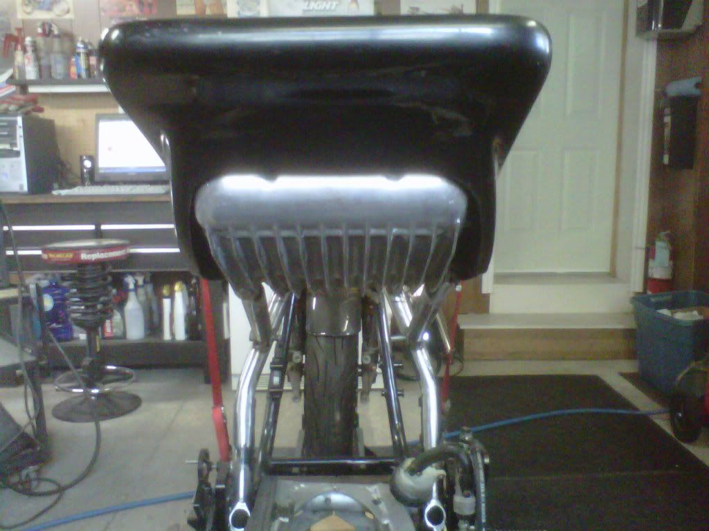

Oh here is my battery tray, started out as an oil pan, seemed to fit so went with it.

Sick idea on the tray. Very original. The tail also suits the bike really well. I'm on board.

That belly pan idea is pure gold/platinum/diamond whatever you want to call it.  Looks great there.  I'll definitely be watching this build!
