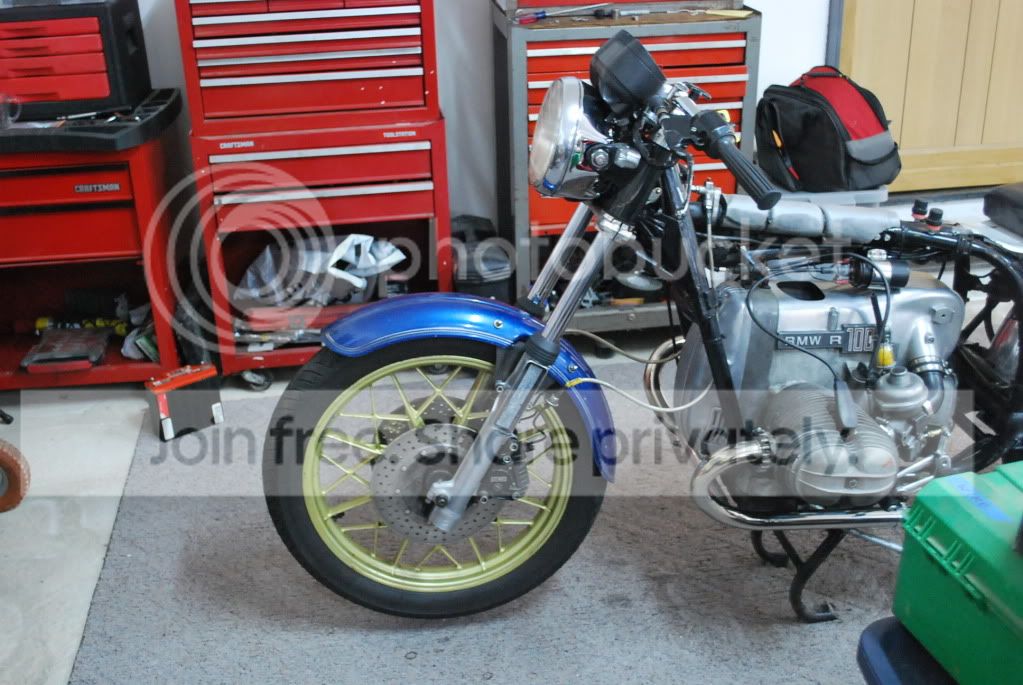

Pre-Teardown:
And with a few deletions and additions:

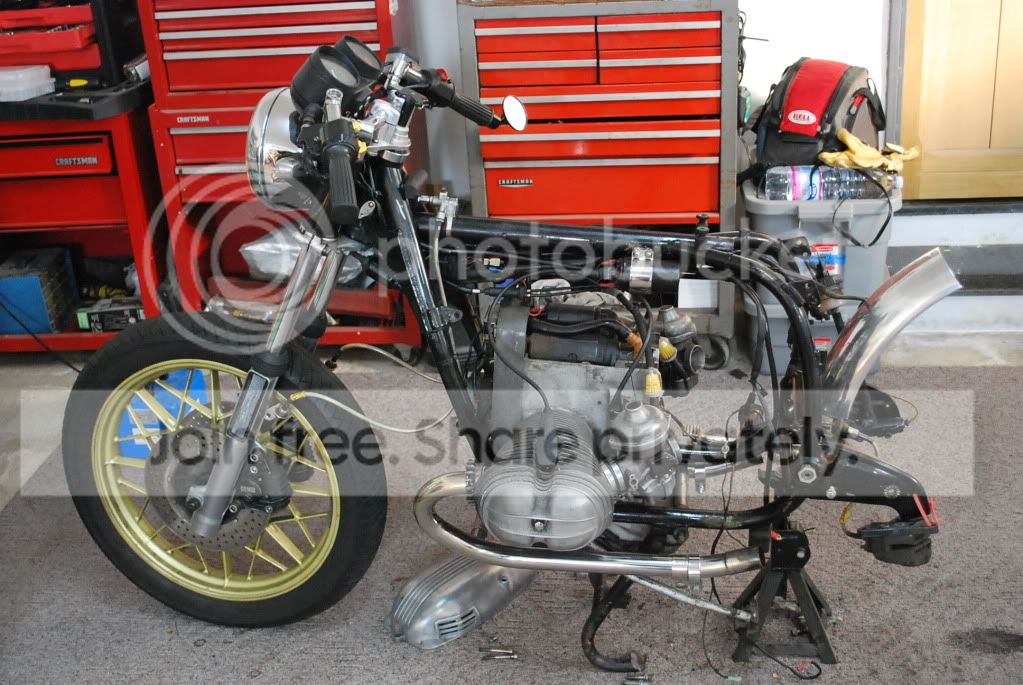

Start of the condensed teardown

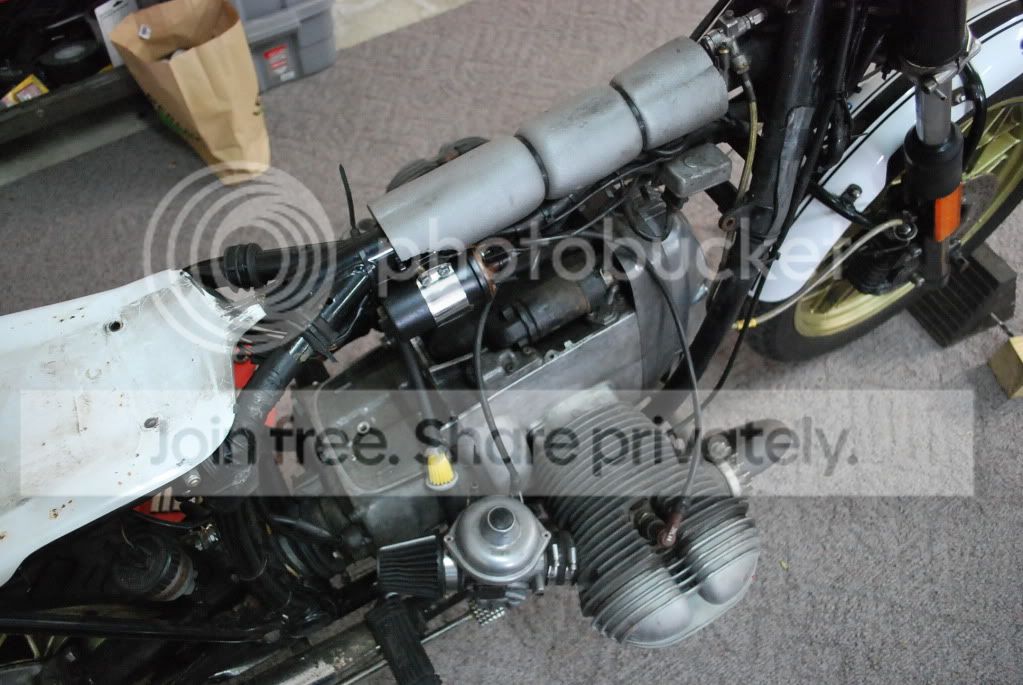

I won't start with 20 detailed pictures of how it looked, I will just get right into the work. The battery was located on top of the transmission, where the stock airbox used to be, so I made and welded on some bracket to the rear subframe and mounted the odyssey battery under the cowl. I know that many people do not like the location under the cowl, but the odyssey is pretty light. This required removal of the aftermarket aluminum fender. Later, I cut and polished the fender and used it as a small deflector between the rear wheel and the engine.
Battery location before:
New Tabs and shortened battery box:

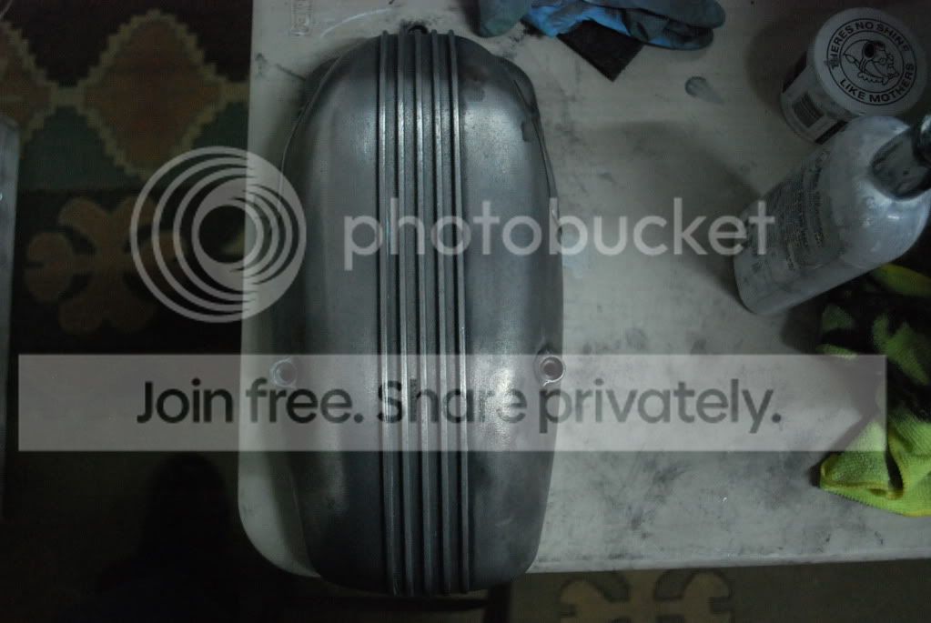

I also started ordering parts and cleaning parts. As mentioned above, nothing was able to be handled. The front engine cover was painted black, so I spent some time with aircraft stripper and red scotchbright. Crappy job. If I knew the blaster I know now, I would never have done that job by hand.
Cleaning up starter cover:

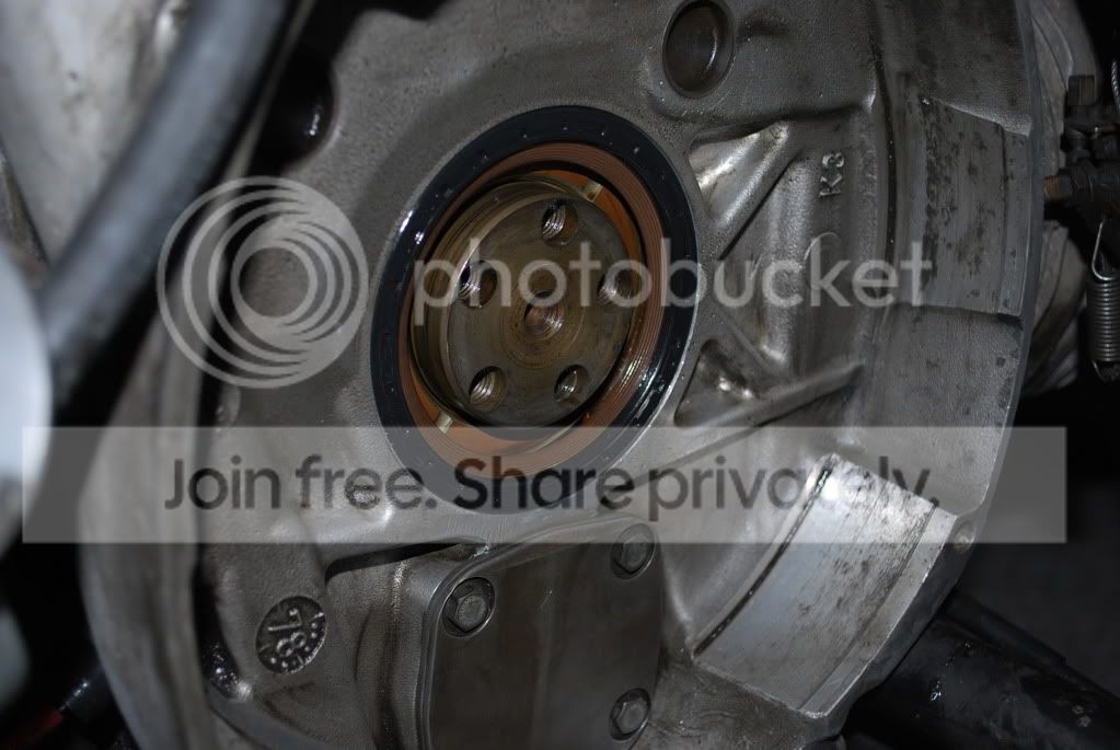

First, the leaky final drive:
Inside of rear wheel:
This led to the removal and complete teardown in order to replace the main seal:

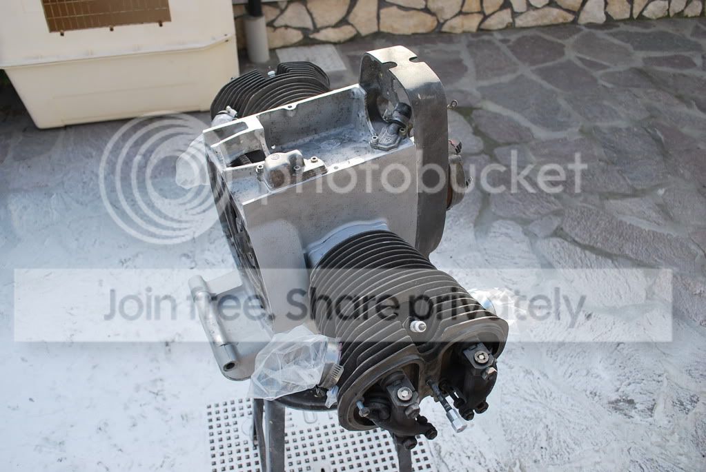

With the motor out, I did some soda blasting:
It was my intention to just clean up the block itself, and found that while the soda blasting doesn't make the block "perfect," it does make a huge improvement and also helps get rid of the problem that my hands get dirty when I even look at the engine. Ohh, shiny:
